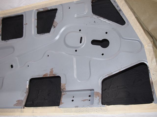

I ran two strips of peel and seal inside the door panel. I figured the vapor barrier would keep the smell out.
It made a noticeable difference in the "tap" test.
I forgot to do the right side door before installing the window mechanism, however, I easily installed it afterwords simply with the window rolled up.

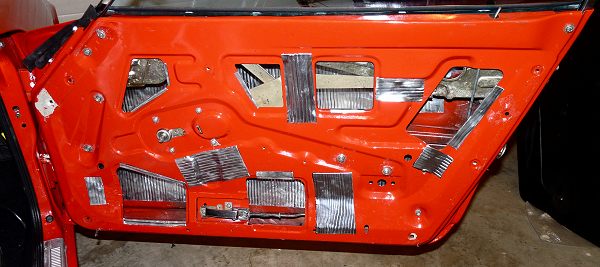

Not a great photo of the other side of the door; however, you can see where I placed small pieces of peel and seal to further dampen vibrations.
I found that placing it in the middle of larger spots and also wrapping around the edge of long openings helped a lot when doing the "tap" tests.

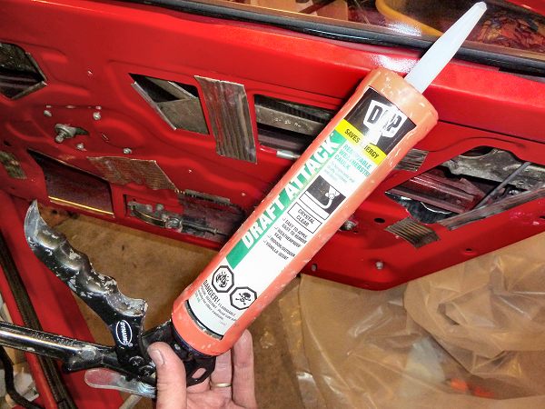

I sealed the door so the smell of this will not enter the cabin.
