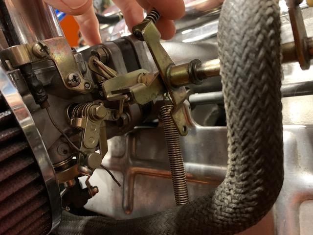

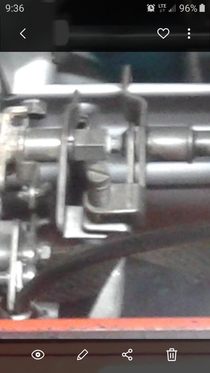

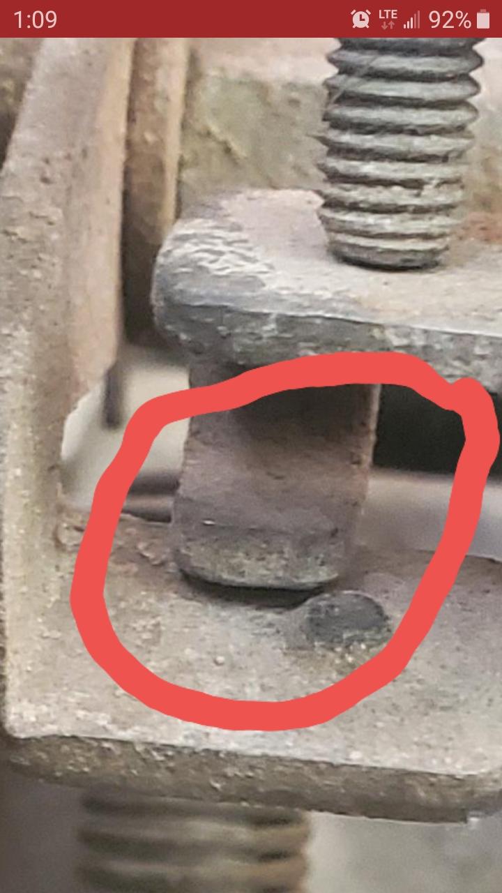

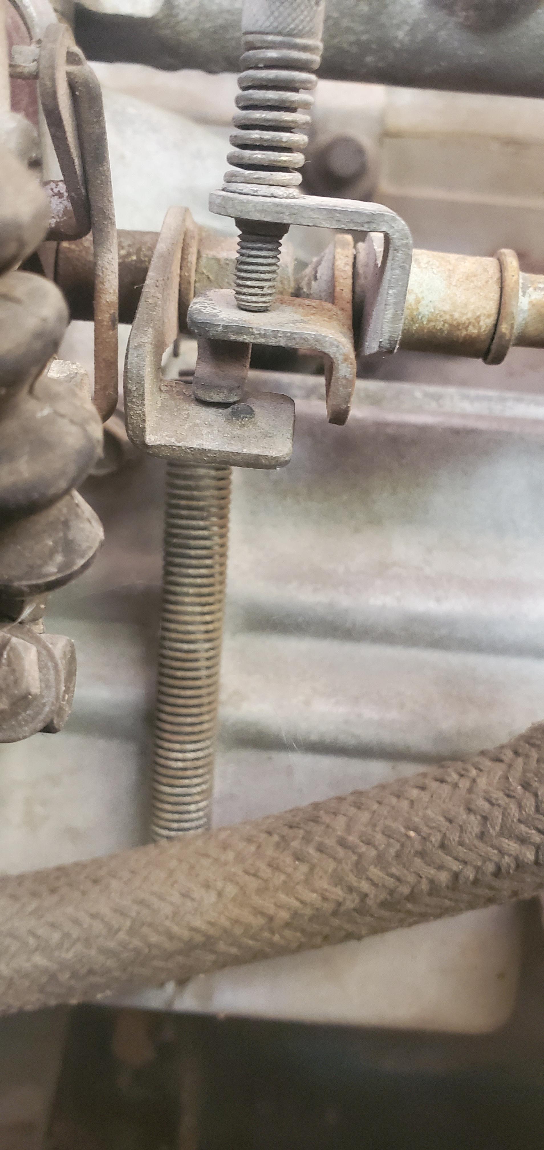

What videos are you talking about? My Z currently idles at 3k RPMs.
Mine did that after I rebuilt the motor and put everything back together. I got the linkage flats beside the carbs in the wrong order. Shot up to 3K at start up.
Here's a picture you can double check yours to. Good luck.
2 minutes ago, 7tooZ said:
Yes that is holding your throttle open. The part on the left and attached to the SU should go between the two pieces on the right.

Thank you I'll work on that now
That was it thank you!
