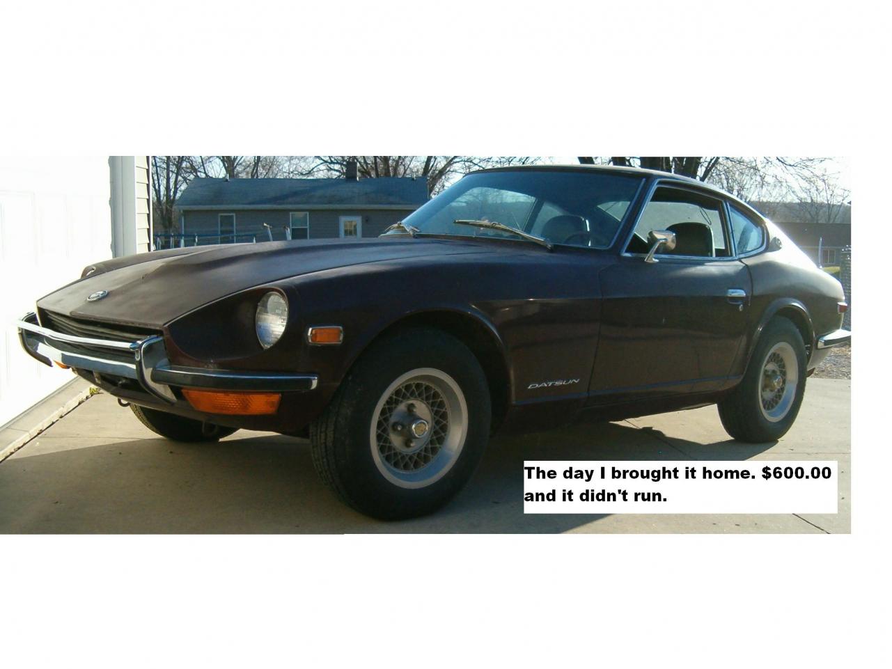

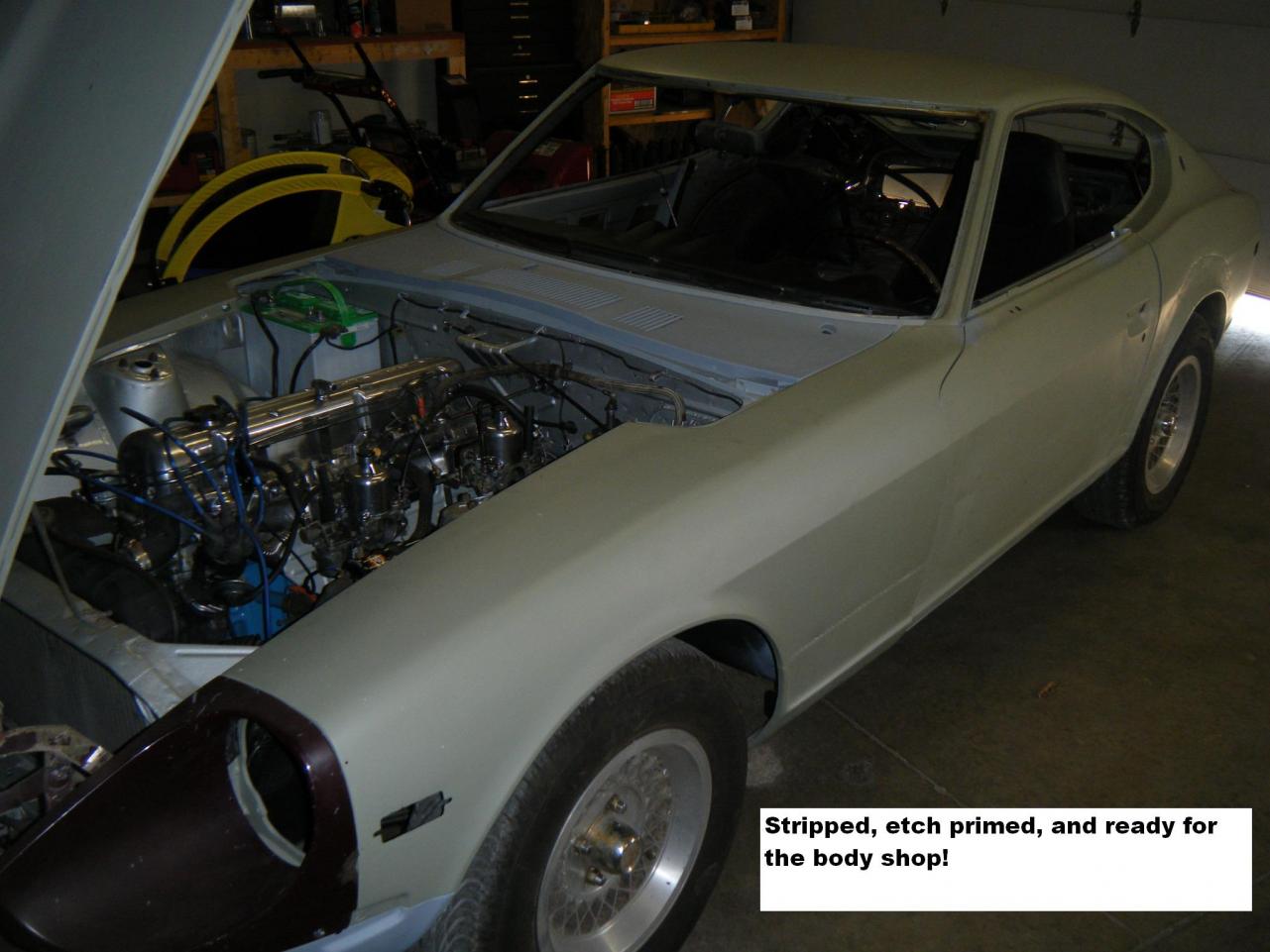

After I bought this car a few years ago the first thing I did was get the engine tuned as perfect as I could. The previous owner never had it running, but claimed the engine was rebuilt when he bought it. I believe this is true since the compression test i later did proved this is a new rebuild. Anyway I started with the complete carb rebuild kit with video from Z Therapy. New plugs, wires, cap, rotor, and the Pertronix kit with 3.0 ohm Flame Thrower coil. Of course the gas tank was full of gunk, ALOT OF IT, so I ran fuel from a gas can as I got the engine running and tuned perfect. I managed to get the gas tank mostly cleaned, but I still had to change filters about every 50 miles once I started using the tank. I drove this car for one summer, mostly on the weekends and it ran great, except for the fuel filter clogging often. I've spent the last two years stripping ALL of the paint to bare metal and etching priming it to prepare it to go to the body shop. I also pulled the engine and transmission so I could paint the engine compartment so the body shop wouldn't have to deal with that. Now the engine and transmission are back in the car and when I first got it to run it ran very good. But, all of a sudden it started running rough and wouldn't rev past about 4200 RPM. I noticed alot of threads on the subject of points VS Pertronix, so I decided to put the points back in to see what would happen. Well, installing the points made a difference. It revs all the way. I'm not saying one or the other is better, I just wish I knew why this happens. I've read numerous threads where people go back and forth on this subject, but no one seems to have a difinitive reason why this happens. Like I said, the Pertronix worked great at first. So anyway, this is my story and my 2 cents. Just wish I knew why.
