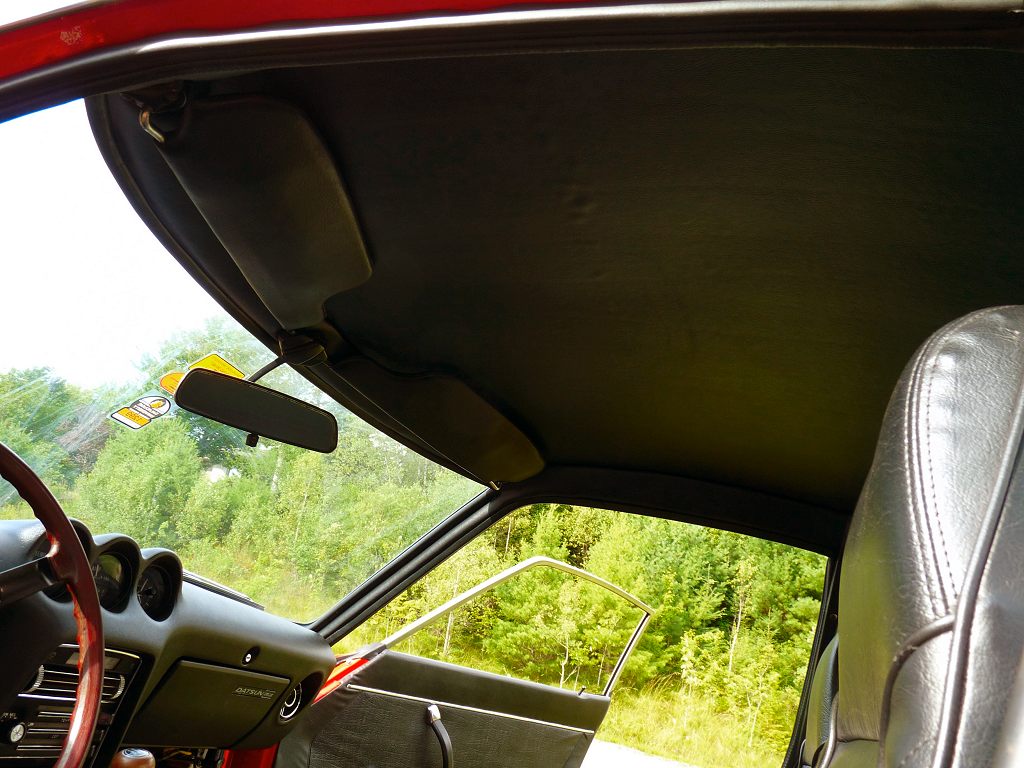

Here is the final pics ~8 months later. Sadly some of the bumps mildly reappeared but they are not very noticeable when in the car.
I like how straight the a-piller trim turned out.
Installing the mirror and sunvisor mounts was easy. You just have to use your fingers to feel for the hole locations, then use a philips screwdriver to make a hole in the material at the spot before fastening. But I used to take blood and developed sensitive finger tips for feeling for veins under flabby arms so maybe I had an unfair advantage at this chore. LOL
