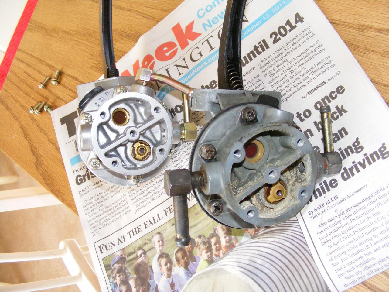

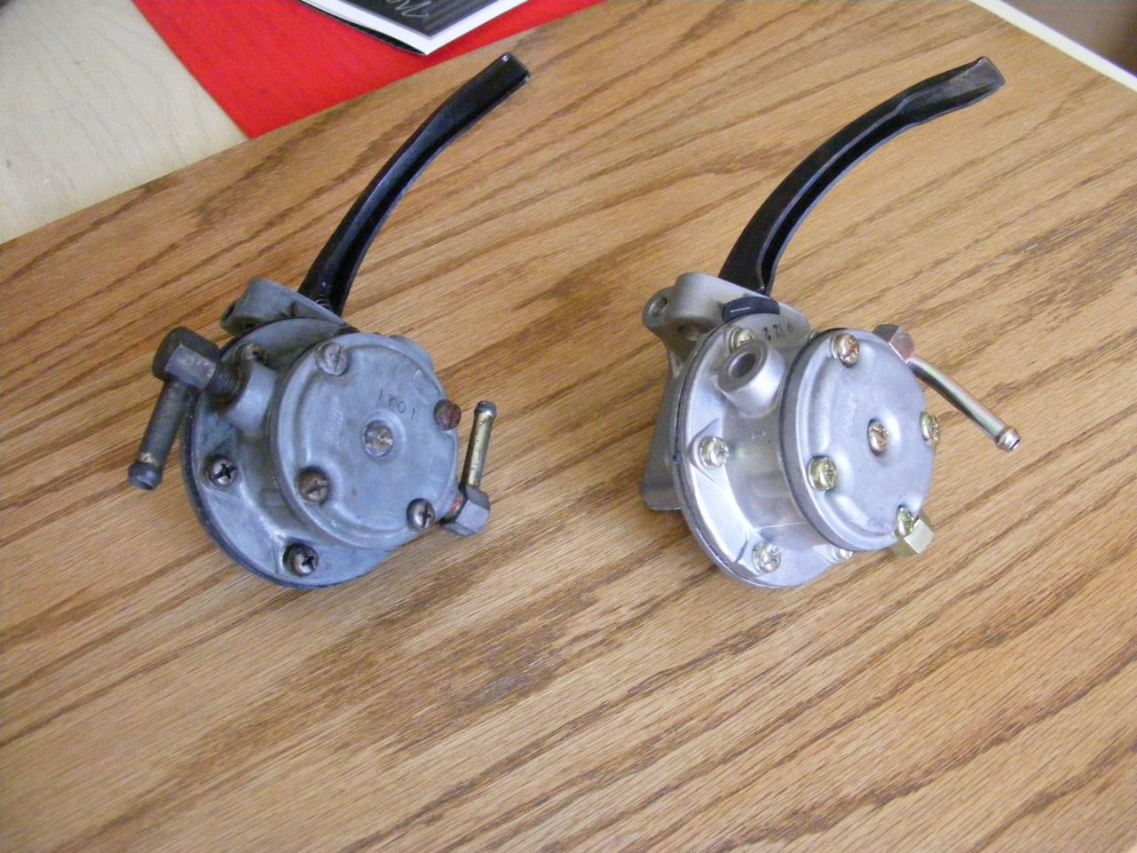

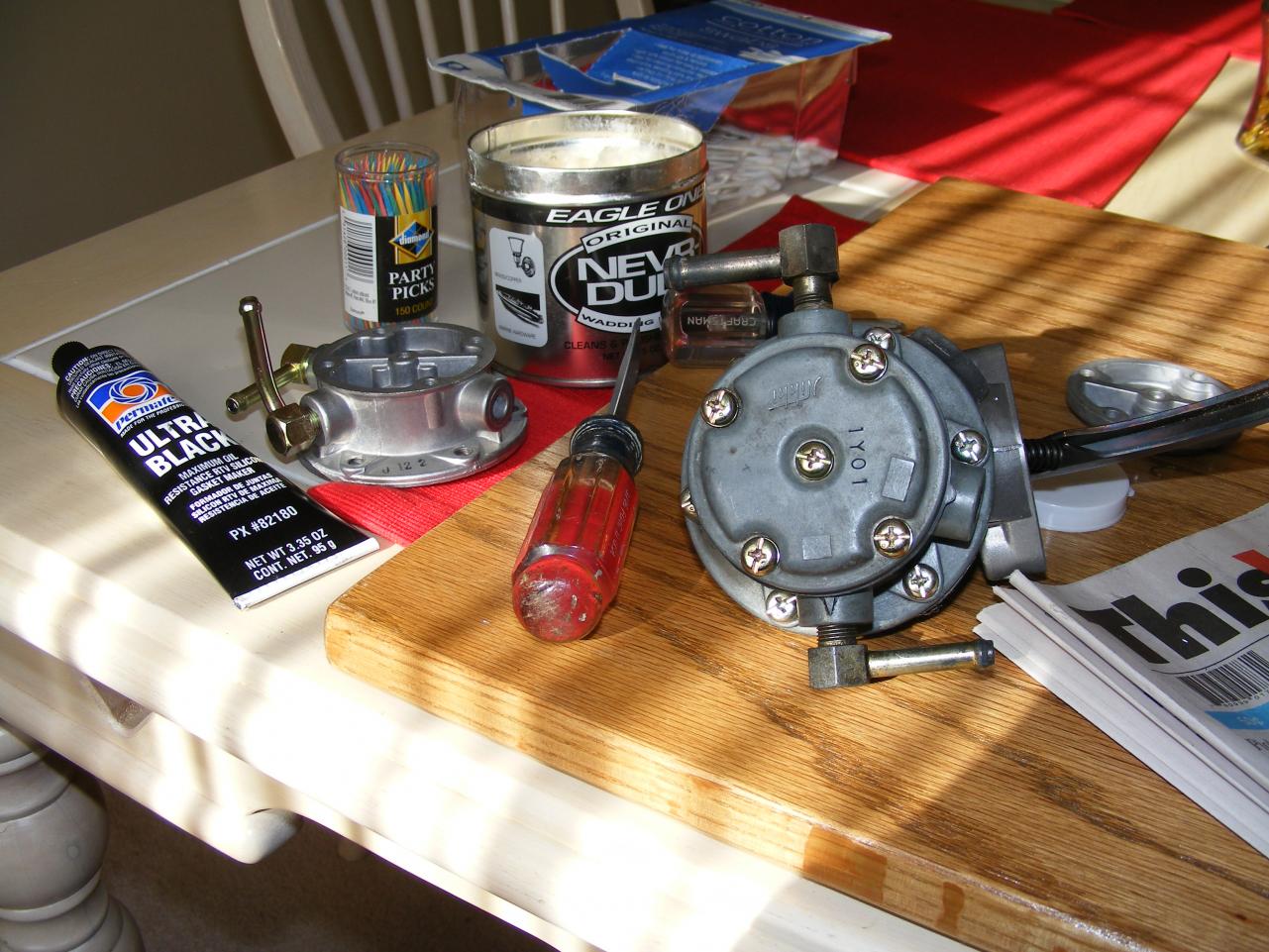

Posted October 16, 201113 yr comment_369427 Hey guys...I "rebuilt" my Nikki fuel pump yesterday...maybe I cheated a little bit. I had the original Nikki pump from my '72 and realized why it was replaced...very weak springs in the lower part of the pump...the engine would not go past 3,500 rpm with that pump installed (the pump lever and diaphragm springs were weak and wouldn't pull enough fuel through the pump). I searched for an NOS rebuild kit for the pump, but came up empty. I then began looking on Ebay for a similar pump and found one for a 1962-68 4 cylinder. It had the same part number on the lower assembly as mine, the same pump lever, and the same size fuel bowl top. The only major difference was the position of the fuel inlet on the bowl. I disassembled both pumps, cleaned the crust out of the Z's fuel bowl with "Value Craft" carb cleaner (cheapest at Auto Zone...it worked great , and put the fuel bowl and top onto the new lower assembly. It still looks old, but now has new guts...not bad for a $42 investment. Link to comment https://www.classiczcars.com/forums/topic/41093-nikkie-fuel-pump-rebuildsort-of/ Share on other sites More sharing options...
