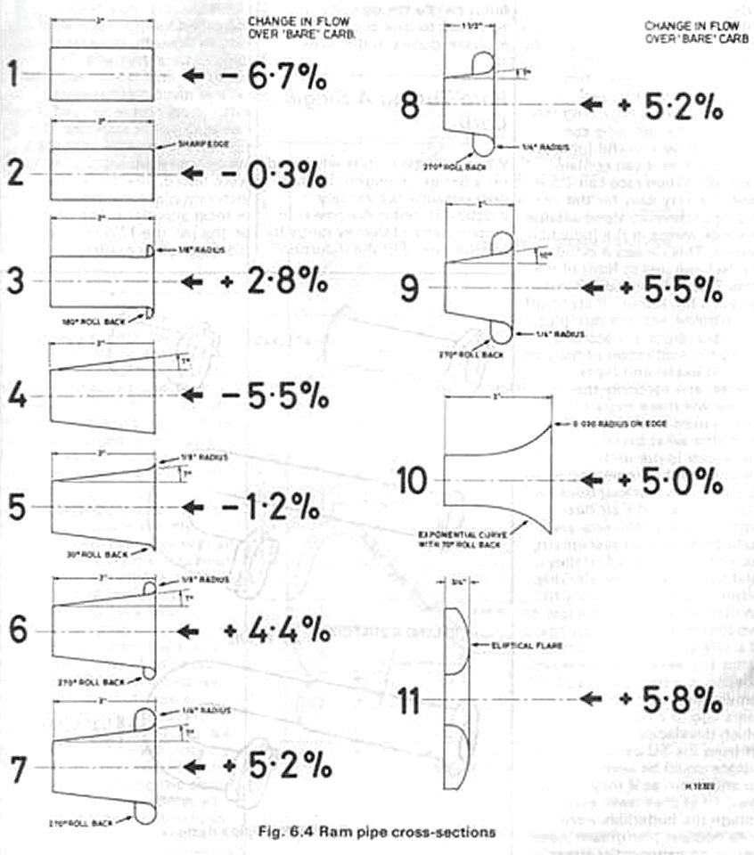

OK, I'll dig a little deeper. In practice, it looks like the stock airhorns HURT performance:
In real world track testing with air rushing over the engine compartment I ran faster track times without the stock airhorns.
I tried it a number of times on the same day and it was consistently slower with the stock airhorns installed as opposed to just the carb body entrance.
The sharp edges on the stock airhorns DISRUPT and hinder airflow.
If the edges had a good 270 degree roll then there would be an increase in airflow.
David Vizard has written a carb tuning book and it has a small section on SU carbs with Dyno graphs that SHOW a LOSS of HP with nonradiused airhorns.
He showed a 4% increse in HP with a properly radiused 4" air horn.
He showed a 5% increase in HP with a 1" stub stack.
He made an 18" long air horn and showed an enormous increase in low end torque in the realm of 10% but the HP obviously dropped way down.
Since installing my home made stub stacks my drag times have improved over just the bare carb body entrance. A consistent half mph increase would indicate an increase of about 4 HP through the better controlled air entryway.
