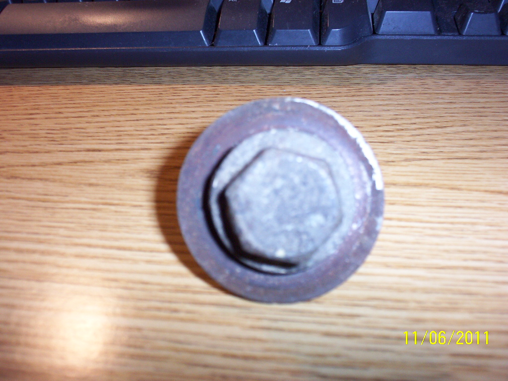

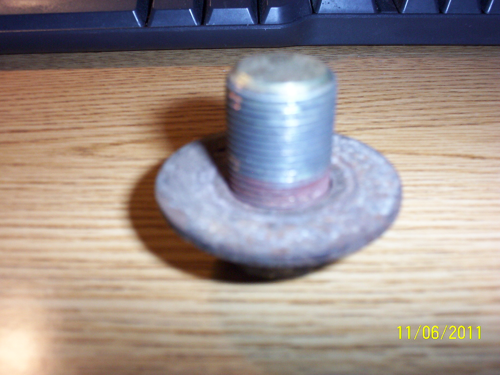

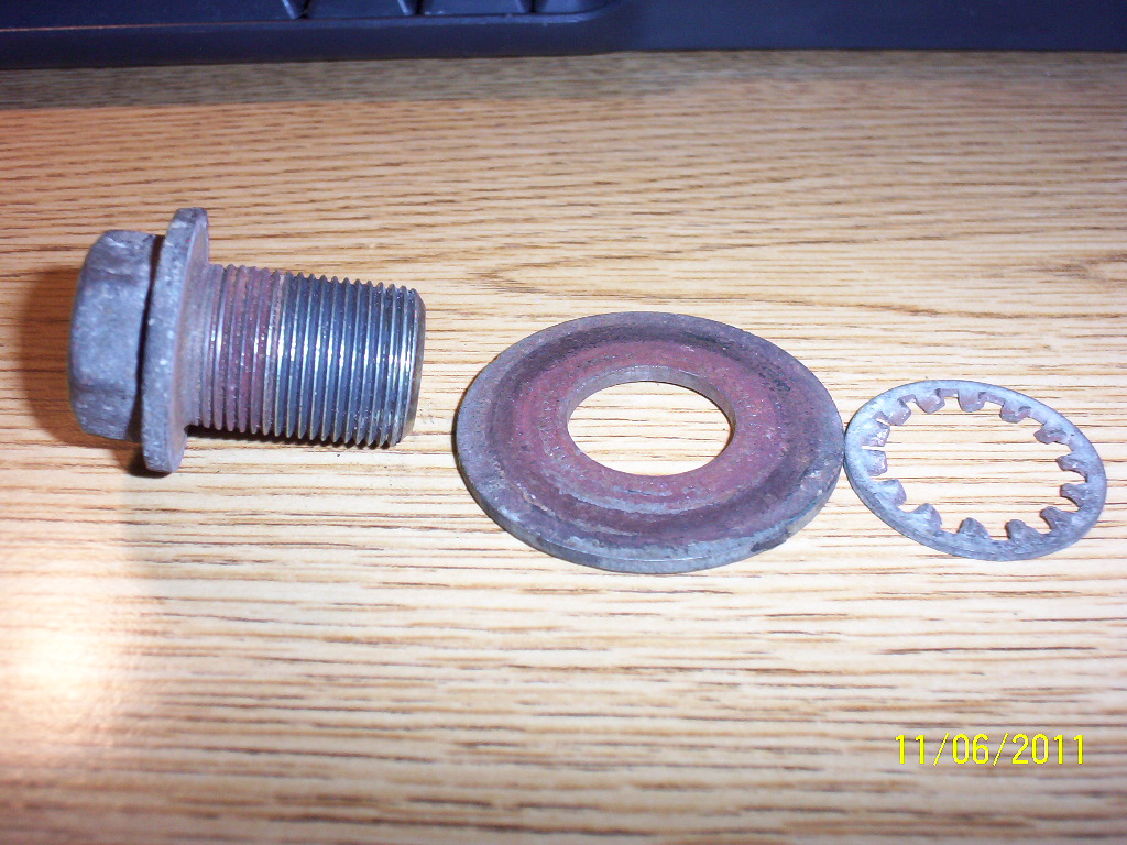

November 6, 201113 yr comment_371067 I think this is what you need. It's a 1.5 thread and the bolt is 21.77 mm in diameter. Thats 57/64". Threaded portion is 1.15" long. Link to comment https://www.classiczcars.com/forums/topic/41255-rear-control-arm-bolt-size/#findComment-371067 Share on other sites More sharing options...
November 6, 201113 yr comment_371068 Forgot the pics Link to comment https://www.classiczcars.com/forums/topic/41255-rear-control-arm-bolt-size/#findComment-371068 Share on other sites More sharing options...

November 6, 201113 yr comment_371072 If you are referring to the smaller hardware on the hanging plates and U clamps or the differential/control arm cross member that hold the control arms:Take another out then go to hardware store (in another car) or order from nissanApart from the big beastie in the photo above, I think most are M8 and M10... not sure of thread... usually 1.25 but could be 1.5 so buy both threads if at a hardware store. Edited November 6, 201113 yr by Blue Link to comment https://www.classiczcars.com/forums/topic/41255-rear-control-arm-bolt-size/#findComment-371072 Share on other sites More sharing options...

May 10, 201212 yr comment_389535 Sorry to bring up an old thread, but I have lost one of these large bolts. I cannot find them online or in any local hardware stores. The size is M22 x 1.50 x 30. Does anyone have one, or know where I can get one? I need the big washer and the toothed ring, too.Thanks,Matt Link to comment https://www.classiczcars.com/forums/topic/41255-rear-control-arm-bolt-size/#findComment-389535 Share on other sites More sharing options...
