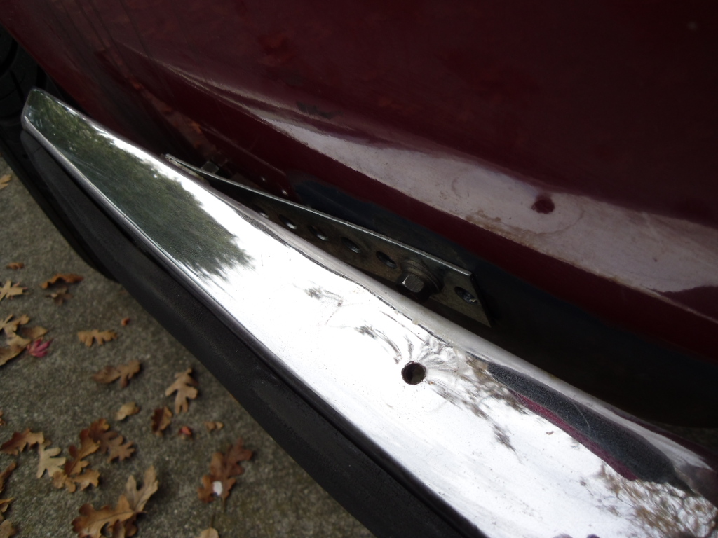

November 28, 201113 yr comment_373034 I used the zccjdm bumper mounts to install 240z bumpers on my 280z. 30 Ounce is right... removing the original cow catchers and bumper shocks is not for the faint of heart. The zccjdm mounts work good, but would have liked a cleaner solution to the side mounts on the rear. I fabbed up some myself for a temporary fix. Does anyone know if there's a better way? Link to comment https://www.classiczcars.com/forums/topic/41293-z-store-fiberglass-bumpers/#findComment-373034 Share on other sites More sharing options...
November 28, 201113 yr comment_373064 [ATTACH=CONFIG]49625[/ATTACH]I used the zccjdm bumper mounts to install 240z bumpers on my 280z. 30 Ounce is right... removing the original cow catchers and bumper shocks is not for the faint of heart. The zccjdm mounts work good, but would have liked a cleaner solution to the side mounts on the rear. I fabbed up some myself for a temporary fix. Does anyone know if there's a better way?The way to do it is to fill the old rubber side mount hole, then drill a hole directly behind the 240z side bumper tab. Use large washers and the bolt goes all the way through and is secured by a nut and lock washer on the inside. Be very careful, the hole on the right side will be very close to the fuel tank filler neck, and its a real PITA to get that bolt in that tight space and tightened up. I had to make the hole slightly larger than the bolt so that I could work the bolt in at an angle to get it through. The original mounts use a rubber pad/grommet that will keep the metal tab off the bodywork. Link to comment https://www.classiczcars.com/forums/topic/41293-z-store-fiberglass-bumpers/#findComment-373064 Share on other sites More sharing options...
November 28, 201113 yr comment_373069 I will add one thing. Make sure the rear mounts and bumper is right were you want thembefore doing the sides. Put a level on the bumper at the rear. Then use a level on the bumper side before marking the holes. Link to comment https://www.classiczcars.com/forums/topic/41293-z-store-fiberglass-bumpers/#findComment-373069 Share on other sites More sharing options...
