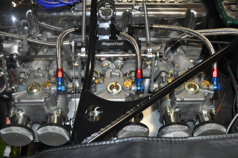

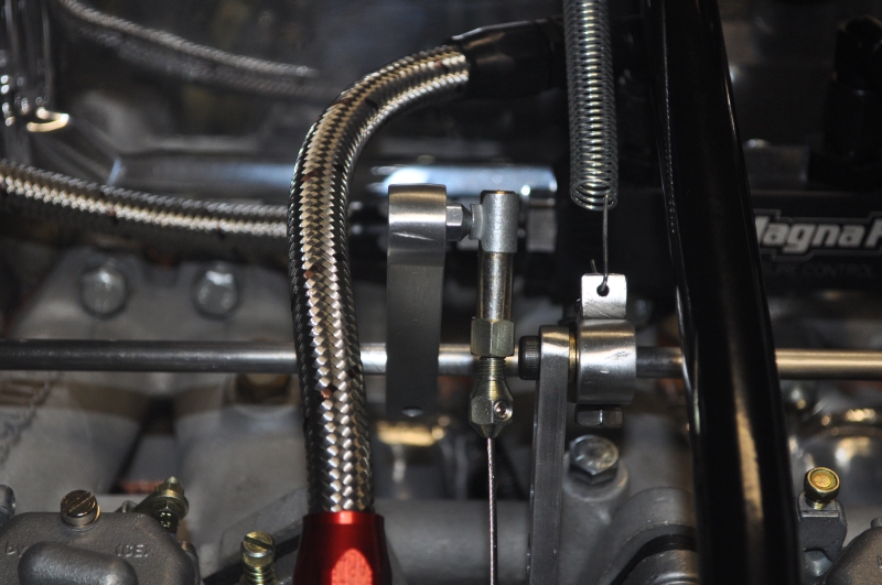

Thanks for the nice comments about my throttle setup and the return springs. A few other comments that might help you out.

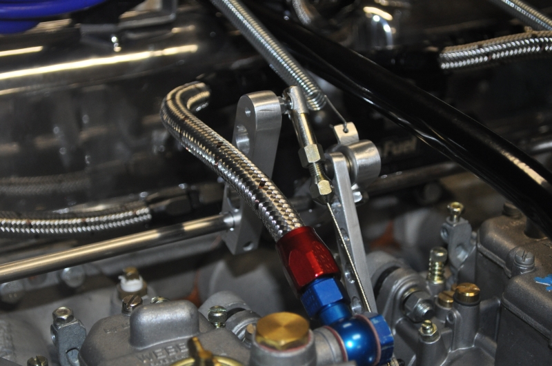

1. The springs that you saw in the last pictures that I posted are no longer on my car. These were springs and brackets that were made for the 40 DCOE (and that I purchased directly from Pierce Manifolds where I also purchased the carbs) but unfortunately they only work on one side of the carb (unless you decide to modify them like I did so you can use them on either side). Although I liked how clean the installation was with these, they ended up not working for me as they did not provide sufficient return strength to always get my engine back to a normal idle (900 - 1000 RPM's). I think that a part of this was due to the fact that I could only use 2 springs for the 3 carbs and that I had to locate the springs in a different place on the return arm than what the original design intended. Much of this was due to the nuances of my particular installation. The pictures that I have attached to this post represent the latest version of my return spring setup.

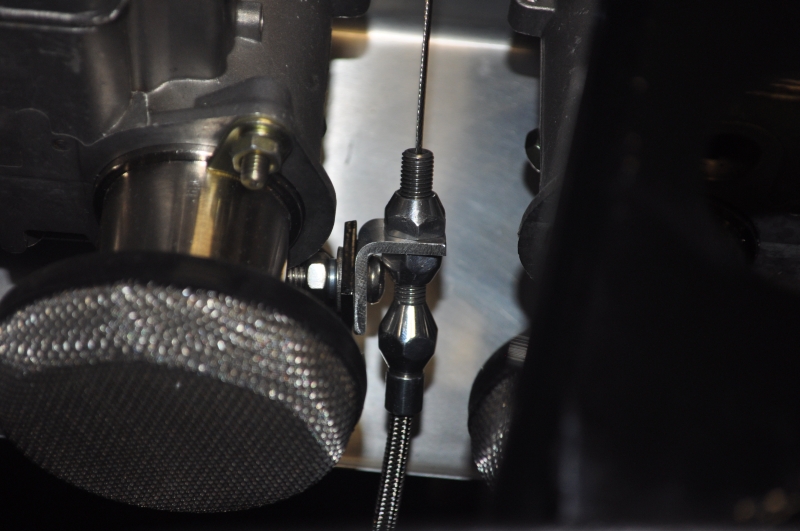

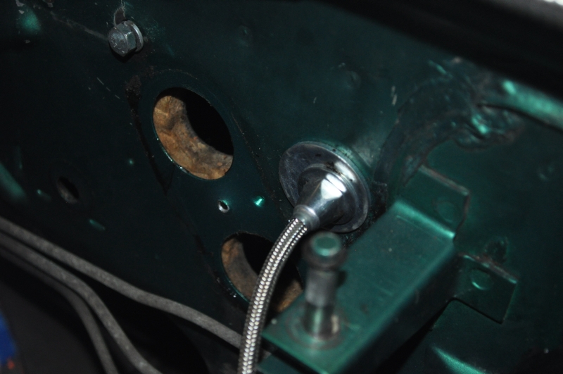

2. The throttle cable setup I have has evolved over time. I originally bought a complete setup from Top End Performance (who apparently does a lot of aftermarket stuff for Z's) and this included a special bracket that attaches to the 4 bottom screws on one of the 40 DCOE's. The rest of the seup from them was fairly generic other than the attachment mechanism at the pedal. This did require a slight modification to the pedal, but it was not a big deal. Since then I have changed out the cable to one from Lokar. The Lokar cable is much more substantial, is done in polished stainless steel (so it looks a lot nicer) and has much better attachment hardware in general. You should be able to see this in the attached pictures. The Lokar P/N is TCP-1000HT and I purchased it form Jegs for about $70. I did reuse the carb bracket and the pedal fitting that I originally purchased from TEP. I really like the look of this as well as the performance. It is a much beefier setup than the one from TEP as well.
3. Finally a plug for Dave Cerutti. Dave has developed a really nice throttle linkage setup for the Webers and he fabricates these in billet aluminum. He even went as far as to make me a special arm that I use just for the throttle cable assembly. Again you can see it in the atttached pictures. They look great, are easier to adjust, and in my opinion are a lot sturdier than the standard throttle arms that typically come with aftermarket Weber setups. He is a great guy to work with and has a fabulous product. I believe that he has advertised these in the classified section of this site.
If you would like to try the older return springs that I used prior, just let me know and I would be happy to send them to you to see if they will work for you. As I said, they are a very clean design and made for the DCOE's, but I just couldn't get them to work in my setup. I find that one of the finicky parts of the Webers is throttle return and I have had to go to a couple of fairly strong return springs so they work in my setup.
Let me know if you need anything else. Would be happy to try and help you out.
Mike.
