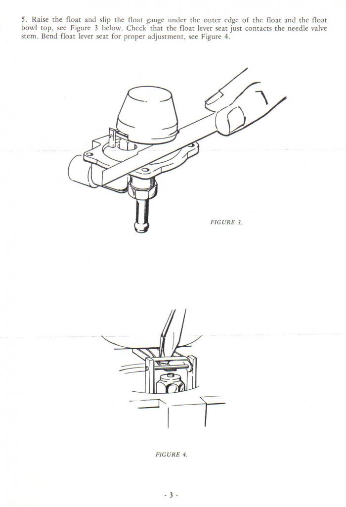

Okay, not if I am not mistaken, the SU video says I need .55" of clearance between the level lid cover and the bottom of the float...
Does this sound right. I have about .190 no the front and .210 on the rear.
The pictures I am looking at shows the float hanging almost level when adjusted properly.
If it is that off, then it would explain why no minor tweak of my mixture ratio nut would make a bit of difference.
Now if this is normal, I may have to do one of those clear hose tricks you guys have mentioned.
Is there a preferred way to check float level. I am about to do a search to get educated.
My factory service manual says that dimension 'H' should be about .55" but it does now show where dimension H is on the picture!
This may be a key piece of the puzzle!

Yes, that is correct. the measurement is just when the float tang touches. You can also hang the float in it's normal position to measure the other way. It's just under an inch from where the needle shuts off the fuel from the lid to the middle of the float
