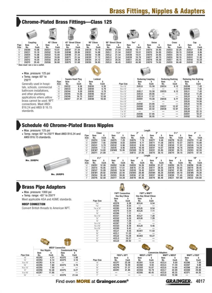

November 27, 201113 yr comment_372932 I order these and some "countersunk" allen hex key parts to plug the carb heaterhttp://www.amazon.com/gp/product/B002KLMJYM/ref=oh_o01_s00_i01_detailsAs you can see, the supply is pretty variable off amazon.These look like good suppliers of this kind of thing. Make sure its BSPT (tapered) instead of BSPP (parallel). I'm pretty sure its all tapered threads. I think the countersunk would look a bit better, is cheaper, but probably harder to de-install w/o thread lube or teflon. Think brass would be better than steel.http://www.amazon.com/IMPERIAL-96132-BSPT-STEEL-THREAD/dp/B001DENRKM/ref=sr_1_7?ie=UTF8&qid=1322409756&sr=8-7http://www.discounthydraulichose.com/9030TCSP_BSPT_Countersunk_Hex_Plug_p/9030tcsp.htmhttp://www.discounthydraulichose.com/9030T_British_Pipe_BSPT_Hex_Head_Plug_p/9030t.htmhttp://www.grainger.com/Grainger/wwg/catalogPageView.shtml?Catalog=main&CatPage=4017 (see bottom left corner, brass!) Link to comment https://www.classiczcars.com/forums/topic/41473-heater-port-plug-size/#findComment-372932 Share on other sites More sharing options...
November 27, 201113 yr comment_372933 GreenZZZ said: http://www.grainger.com/Grainger/wwg/catalogPageView.shtml?Catalog=main&CatPage=4017 (see bottom left corner, brass!) Just noticed those "Chrome plated brass square head plug" parts. Those would look pretty good on the diff and transmission. Link to comment https://www.classiczcars.com/forums/topic/41473-heater-port-plug-size/#findComment-372933 Share on other sites More sharing options...
