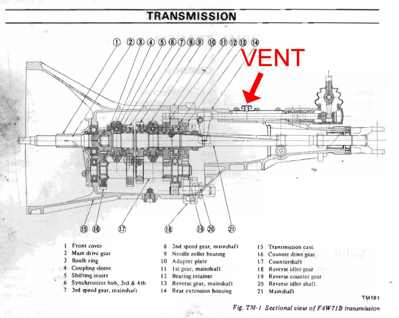

I'm going to have to study the anatomy of this thing. Do you know where the breather vent is?
As for checking the oil level... Ooph! The reason I had the Z specialist change the oil was that I couldn't get either of the plugs loose in the first place! Maybe they're less welded into place now that he's broken them loose.
Is it even possible to overfill the transmission? Don't you fill it to the brim at the level of the fill plug?
I'm betting on the breather vent. I hadn't thought of that.
The breather vent is on top of the transmission a few inches forward of the shifter. See the attached diagram. I doubt you will be able to do much with it while the trans is in the car.
