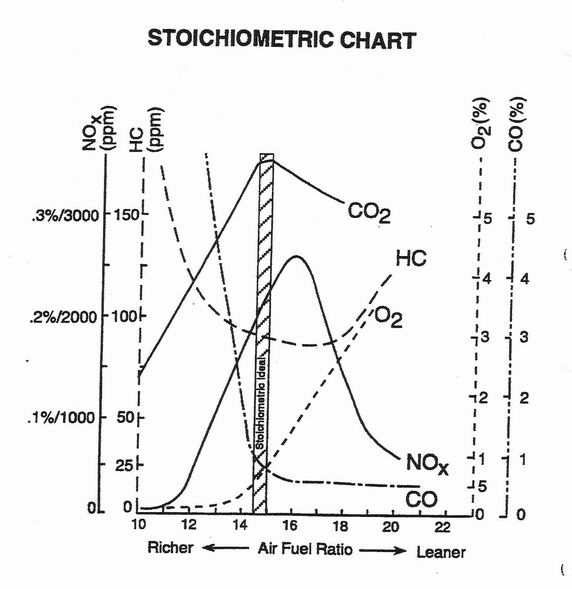

An interesting phenomena shown on the graph below is that HC's increase when pig rich and also when very lean.
I'm with Blue, a WBO2 is a much more comprehensive tool for this purpose.
Concerning the HC phenomena, the reason behind that is at a certain point, a lean mixture will cause incomplete combustion (slow burn or misfire) which will release some unburned gasses into the exhaust. Thus, HC will increase.
The leanest an engine can be run without misfire depends on many factors, with the big ones being mixture homogeneity and combustion chamber design.
