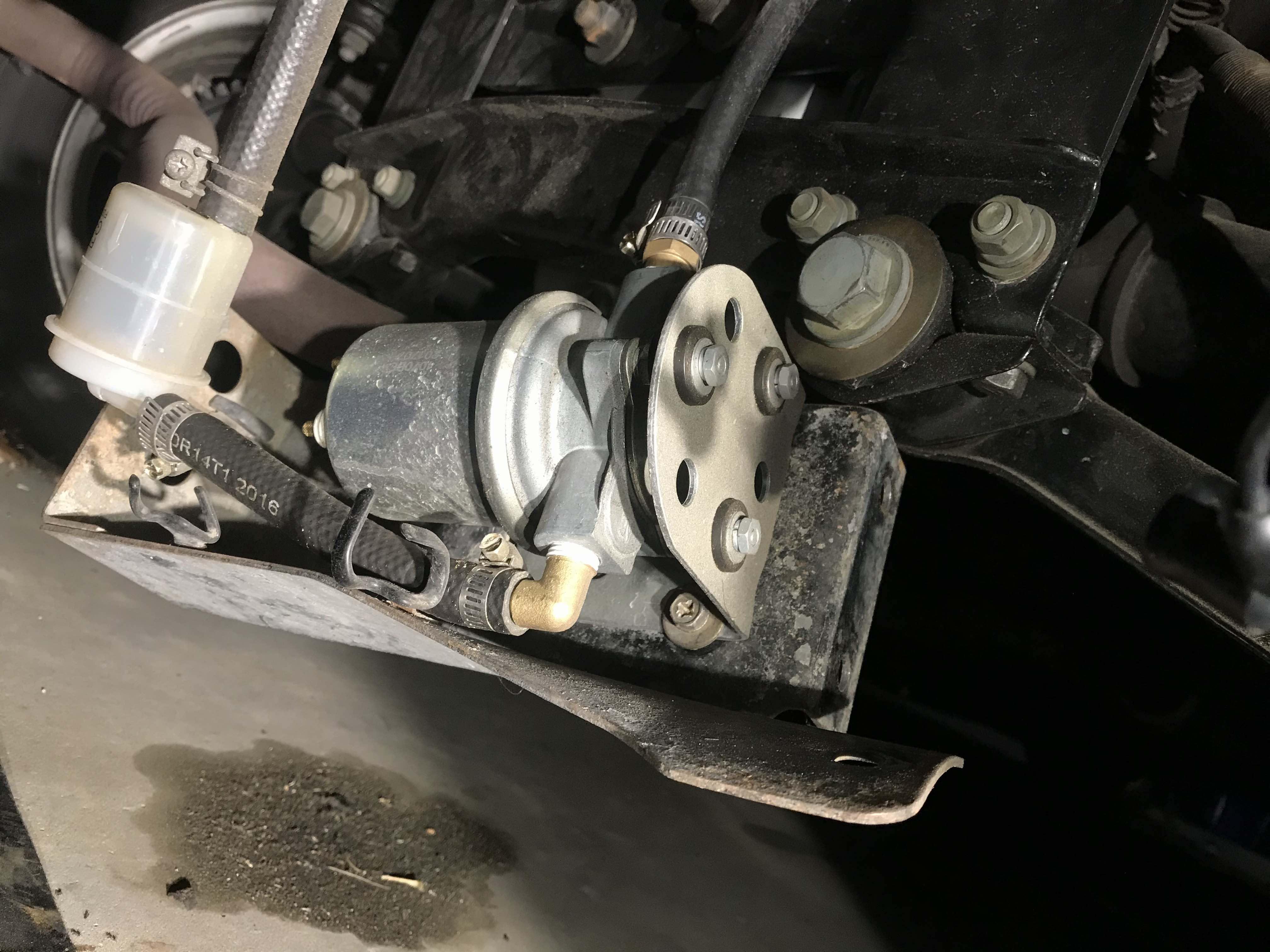

 The clamps you're using will work fine although they're not as good as the F.I. rated clamps. Looking at the pics, I don't think the problem was the clamps it likely the hose. Cliff (Siteunseen) mentioned in another thread, (on the same subject) that the line you're using isn't rated for gasoline, although I haven't verified that. I trust Cliff. Replace all the flexible fuel lines with the proper hose and reroute the new hose so it doesn't touch or rub on any bodywork. Pics when you get it done.

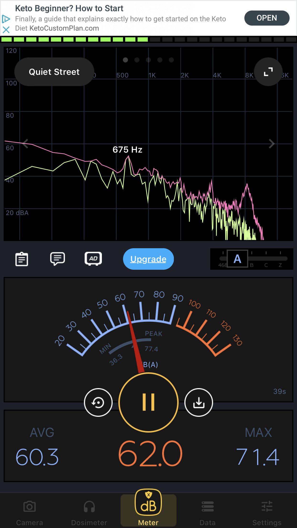

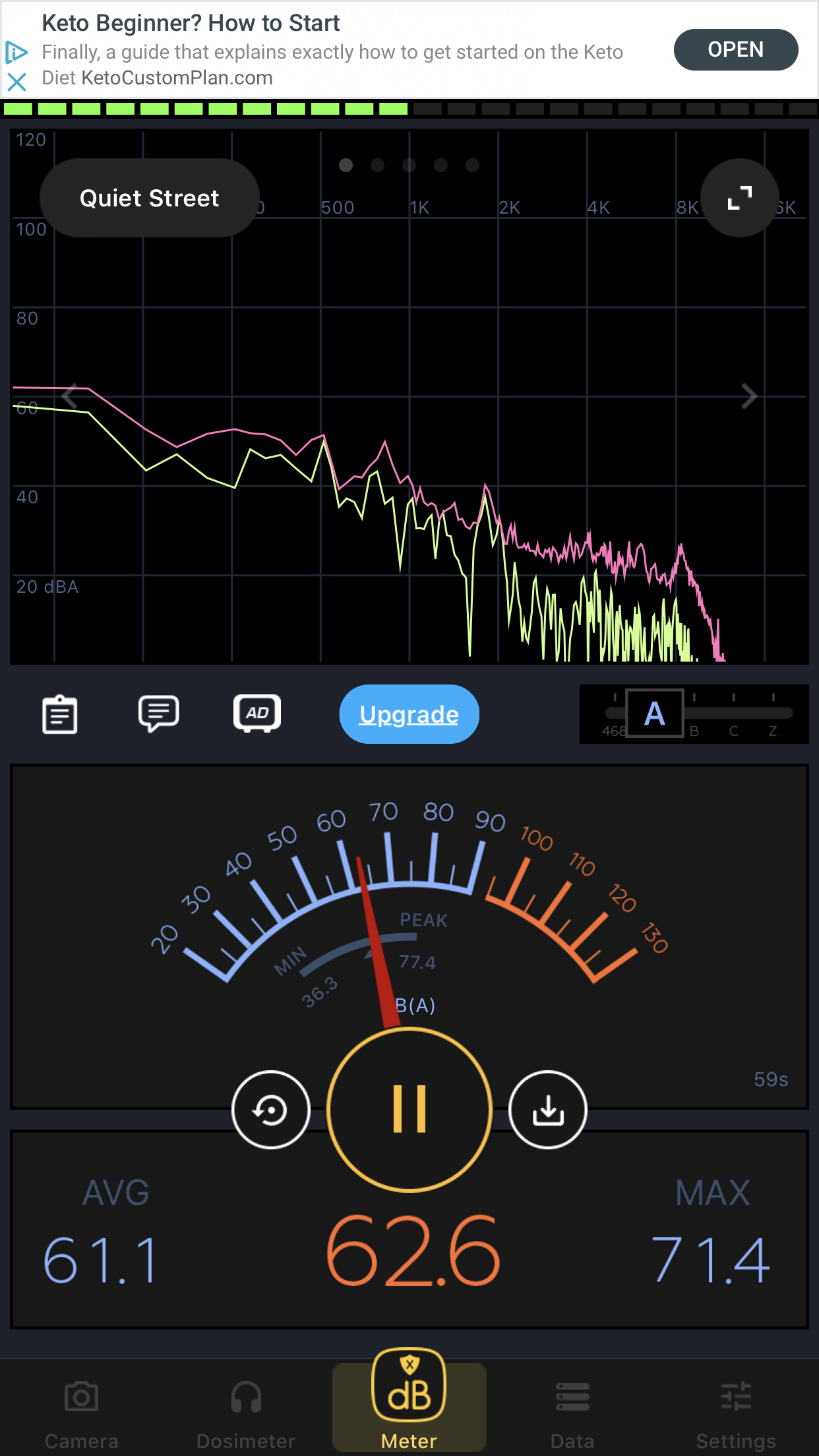

The following results are with the car running.
pre-installation
Post-installation
IMG_1259.PNGwAAACH5BAEKAAAALAAAAAABAAEAAAICRAEAOw==
Im curious to see what an airtex gets, the name of this app is "Decibel X" its free on iphones (skip the payment screen)
Although by the looks of it, anything after 2khz appears to be more muted......
Maybe it is quieter, i got a bunch of fuel in my face when i dropped the fuel hose, might have effected my hearing. ?

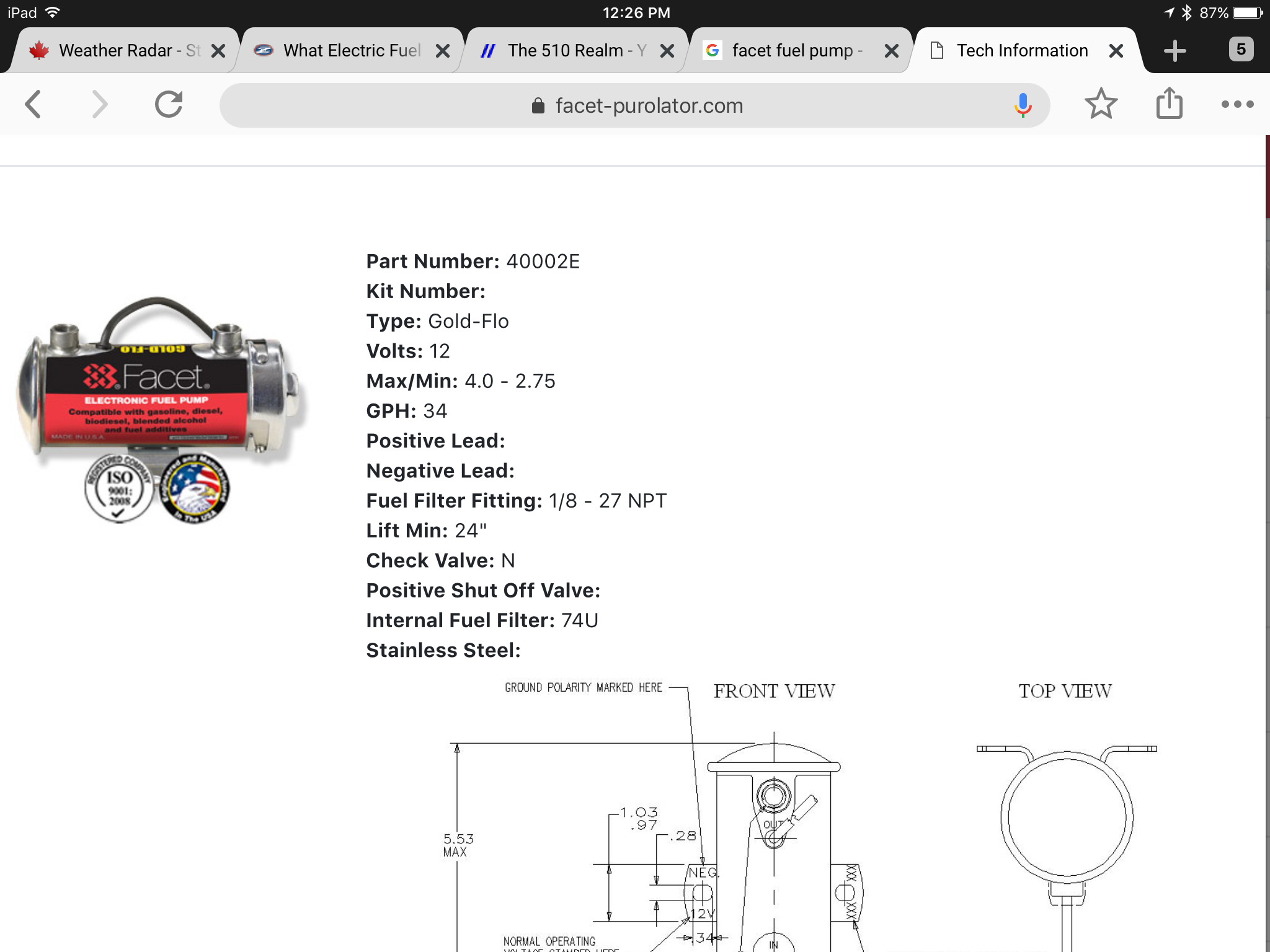

My personal favorite. Other than the correct pressure range, 35 gph flowrate, proven quiet operation, threaded fittings (no hose clamps), years of good service in several vehicles, a remarkable resemblence to the OEM pump, it also has an internal filter.
https://www.facet-purolator.com/gold-flo/
Specifically the 40002E with these specs
https://www.facet-purolator.com/tech-information/
