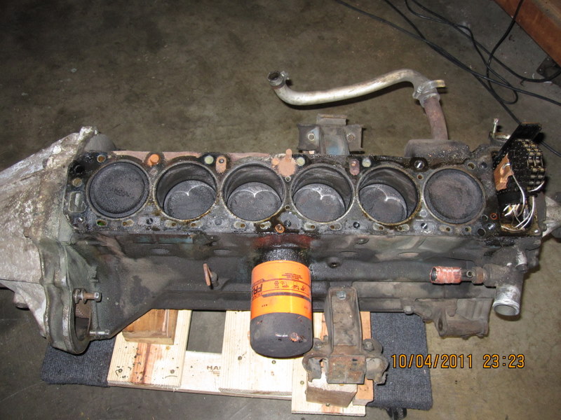

#1 piston is closest to the radiator.

Put the timing light on#1. There is no telling where your timing is since you where timing it off #6. My guess is you are probably around 15
There is some weirdness here. Shouldn't #6 be on the exhaust stroke, but in the same relative position as #1, when #1 is on the compression (spark) stroke? That wouldn't be 7 1/2 degrees off from where he is now. Seems like someone might have the plug wires in the wrong holes. That might be why he has limited adjustment at the distributor.
You'll probably find that with the timing light on #1 you can't find the timing mark. The other possibility is that you've been looking at the wrong mark on the damper pulley.
Might be best to start from scratch, put the pulley mark at 0 on the pulley, confirm that #1 is on the compression stroke, take the cap off of the distributor, find where the rotor is pointing to establish #1, and get all of the plug wires in the right holes. Then set timing off of #1 plug wire.
p.s. Or, since it is running well, referring back to one of my original comments about making things wrong work right, just drive it and see where things are at before getting back in to it. Someone probably installed the oil pump a tooth off in the past and "made it work".
Edited by Zed Head
^ true. I guessed 15 based on his statement that it's running well and there isn't much adjustment left on the distributor. If someone had the firing order wrong, there is no way it would be running well. My guess is that he was looking at a different mark on timing then, or its just wrong.
#1 on the distributor is easy to find, most distributor caps have a line molded in on the side just under the plug wire. Should be towards the radiator side of it right by the latch
