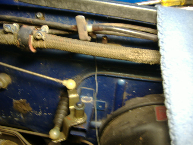

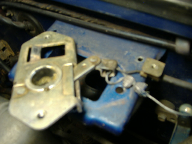

That sounds very interesting. How did you do it? do you have any pictures?
I used some braided picture frame wire and 2 lead fishing weights for clamps looped around the pull lever, routed the cable over to the wire loom tab, then straight down to the tab on the frame rail. It might be a little shade-tree, but it sure saved a lot of time, frustration, a lift and money. After breakage it was open in about 20 seconds.

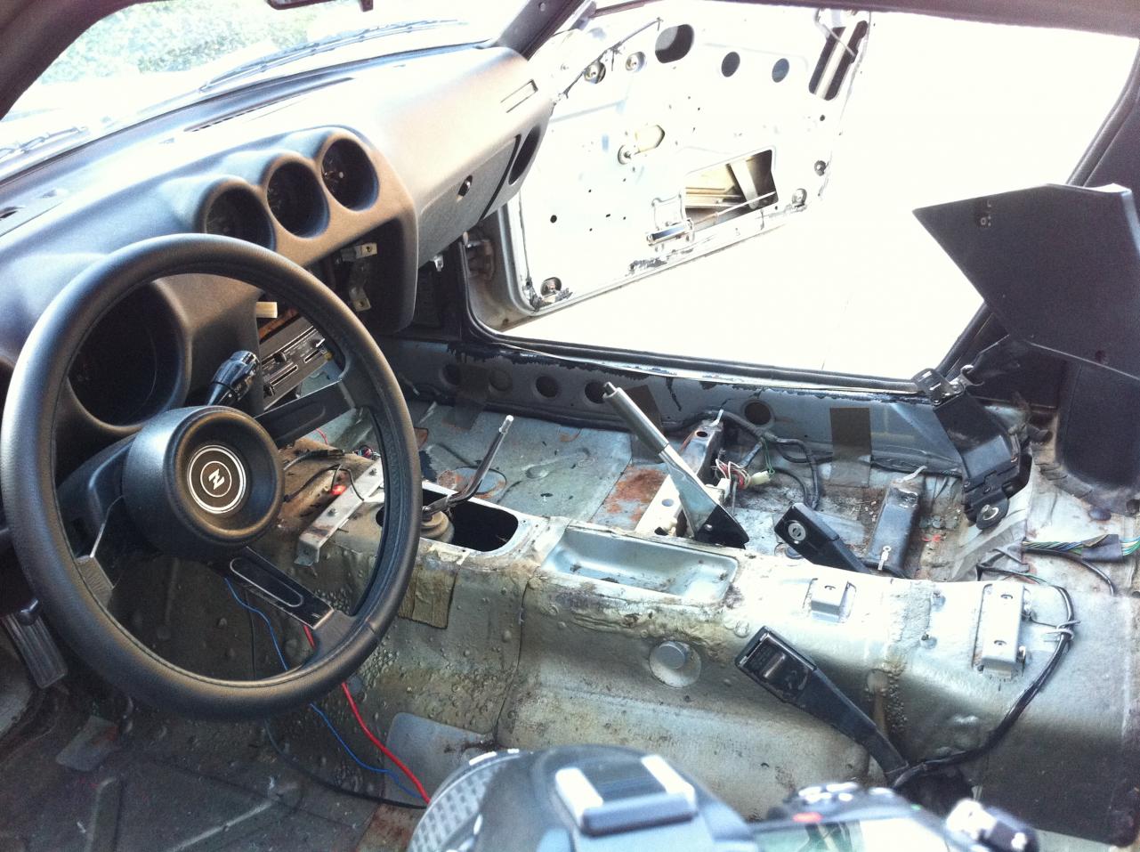

Well technically, not my Z... Starting to reassemble my neighbor's 72 240Z Automatic.
Polished-up all the exterior lights, installed drip mouldings, adjusted one window mechanism, installed side lights & front parking lights.
Doing it a liitle at a time as I have time. Plan to have it put together and on the road in about 2 months (or less).
