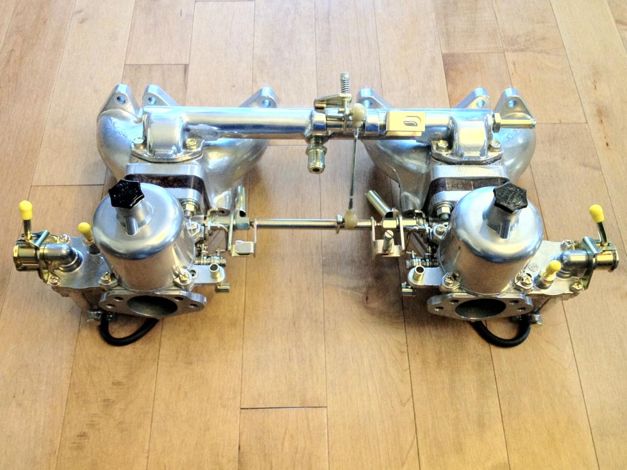

Today I opened up a box from Ztherapy... Suddenly I felt a kick in the pants to get the engine in!
