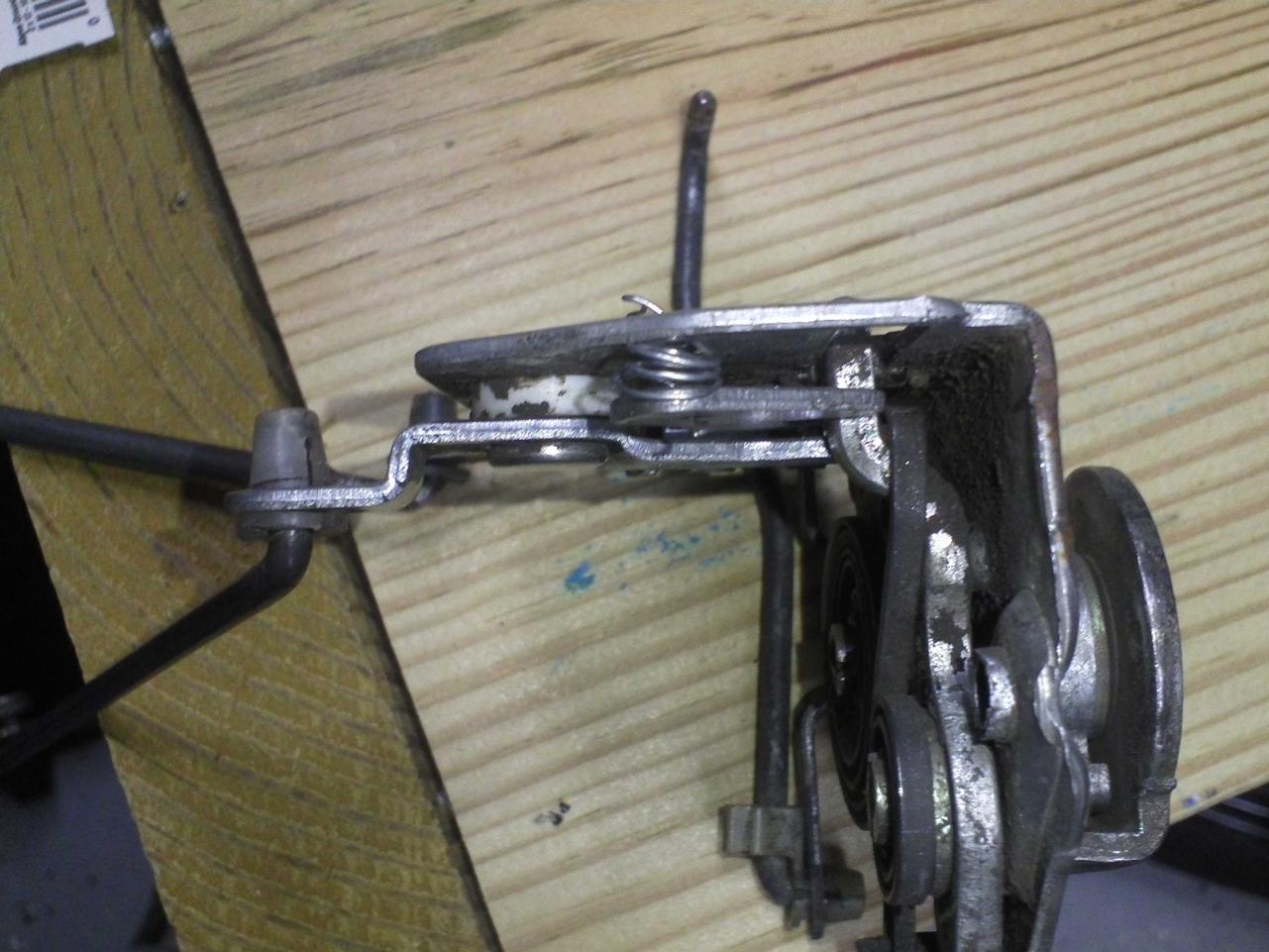

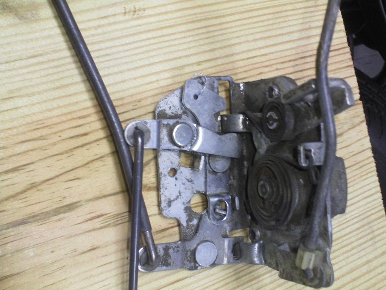

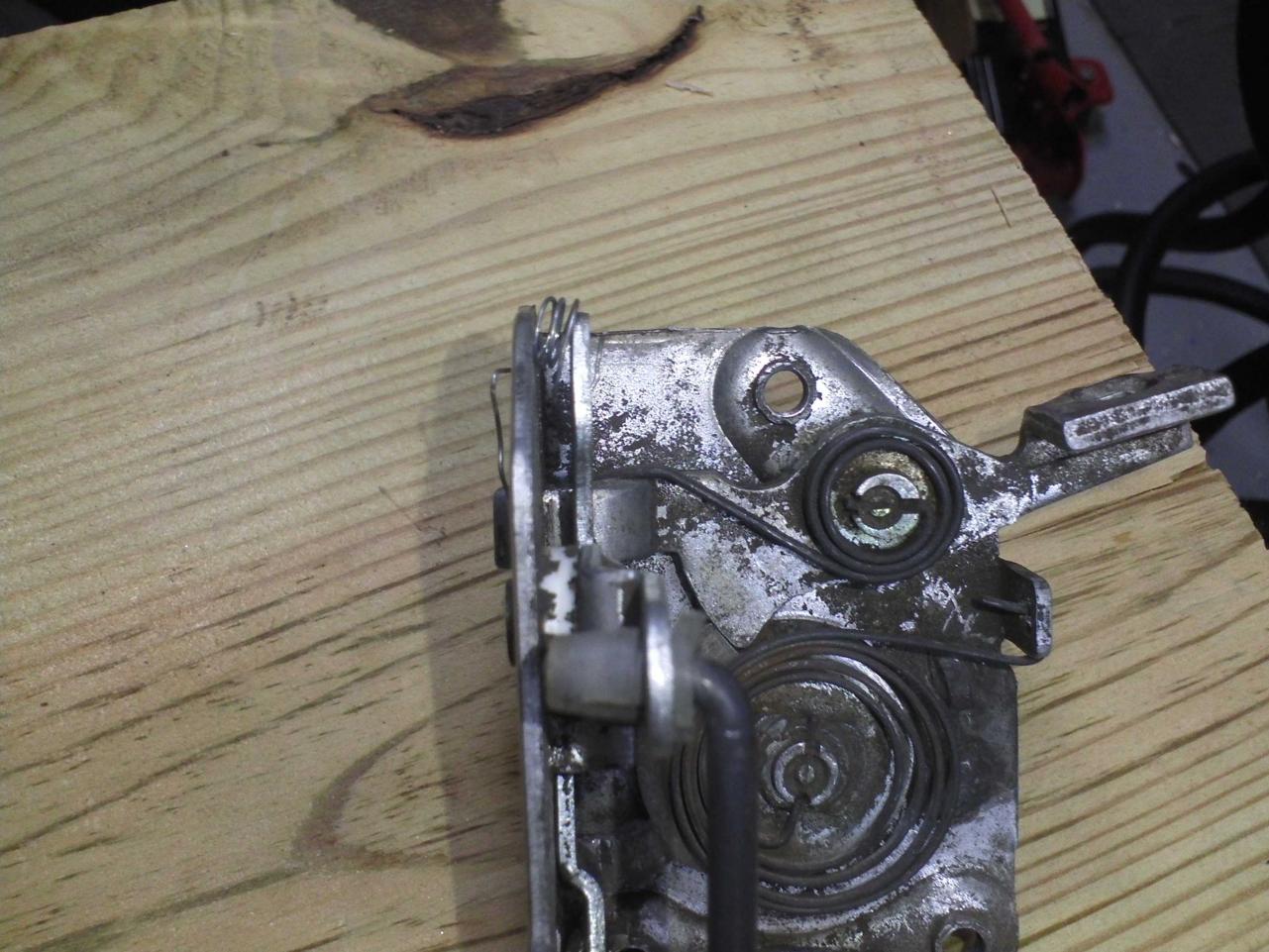

If the door locks automatically when the door closes, the problem is likely that the door mechanism has lost a tension spring. I had a similar problem with my 260Z. I purchased a used door mechanism from Zbarn and noticed the spring that was missing from mine. I was able to fabricate a replacement spring easily.
While you have your door apart to remove the mechanism, it's a great opportunity to replace things like the window channel insulation.
