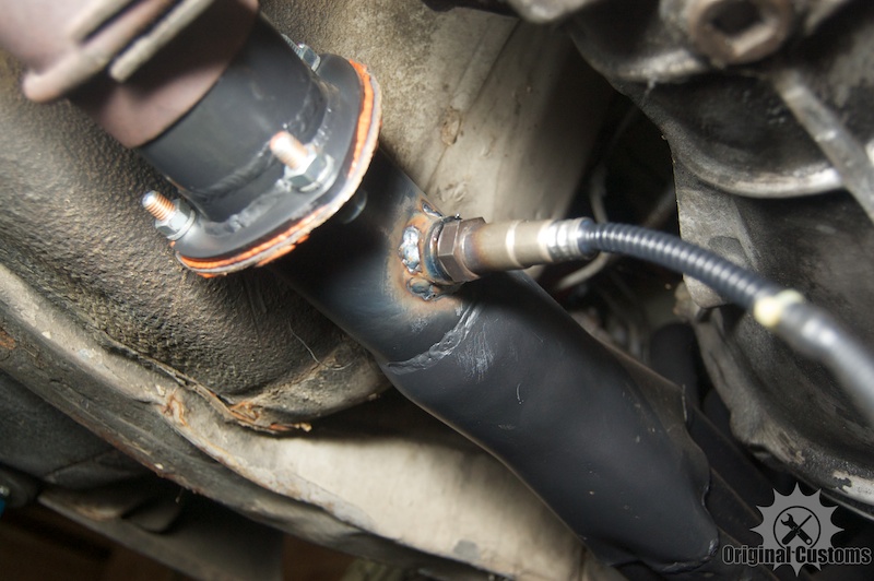

I had a Innovate Motorsports LC-1 sitting on the shelf that I bought a couple years back. I had intended to sell it because it didn't work with the EFI I put in my 914 but what the heck! I can put it in the 240Z and get tuned a lot closer than I could just guessing or asking you guys here!

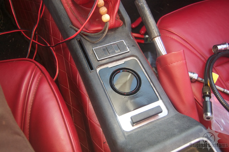

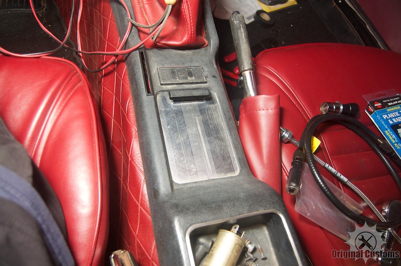

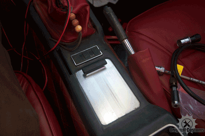

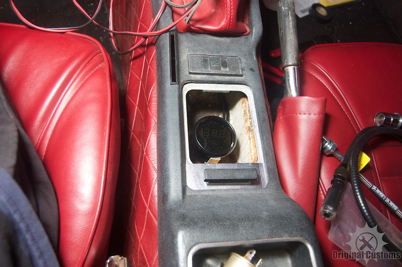

First I welded in the bung and installed the sensor, then I decided to hide the gauge and what better place than the ashtray since I have never used one in my life! Now it has a use! And as you can see, my interior remains completely stockish since it is a 'now you see it now you don't install.'

So I finished up the install of the Innovate Motorsports LC-1 gauge in the ashtray today. Check it out. Should make tuning much easier. I already know that I am way too rich at idle.

I am confused by your assumption that I don't have a wideband O2 sensor installed since a good deal of the posts after the first one have to do with the installation of the wideband O2 sensor. I will include the pictures here so you don't have to back up and look at them.
