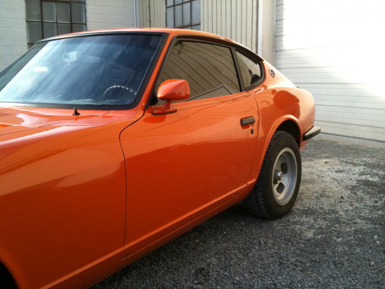

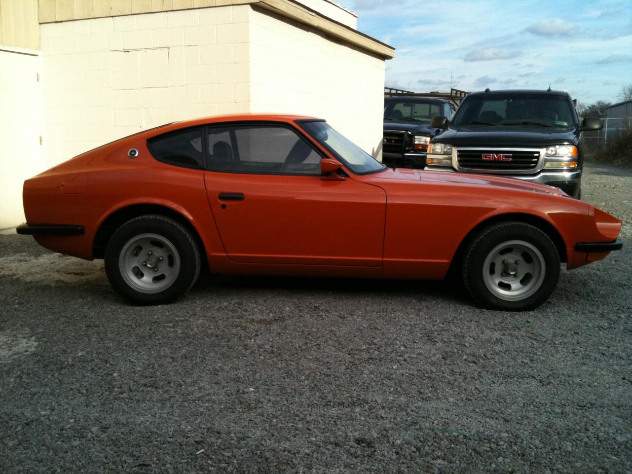

I should have been more specific. I know that a z's rear wheels sit slightly forward of center in their wells. Mine sit waaaay forward, indicative of worn rubber. I'm uploading a picture...
Looks fairly normal. If you lowered the back end, it wouldn't be so obvious. The wide gap at the top makes the gap in the front look narrow. Compare the back gap to your front tires' gap, with the wheels straight.

that looks similar to my car's wheel placement. on another note: though I am not not a big fan of blacked out SS and chrome it seems to work on you're car, Nice Z.

That doesn't look normal to me. Although the picture may be deceiving my eyes, it looks like your rear wheels are toed in excessively. I don't know if the bushings have enough slop to cause that. If your rears are truly toed in, I'd look for bent parts or incorrect installation.
Run a tape measure on the tires. Just pick a groove in the tread and measure to the same groove in the front and back of the tire as high up as you can manage before the tape hits the suspension or body. That will tell you roughly what your toe setting is. It won't be 100% accurate, but it will be accurate enough for you to figure out if there is a toe issue.

Yes, the toe is visibly off, I had attributed it to the worn, sloppy bushings and strut insulators. And I'll definitely check everything for incorrectly installed and (hopefully not) damaged parts when I begin the overhaul.
