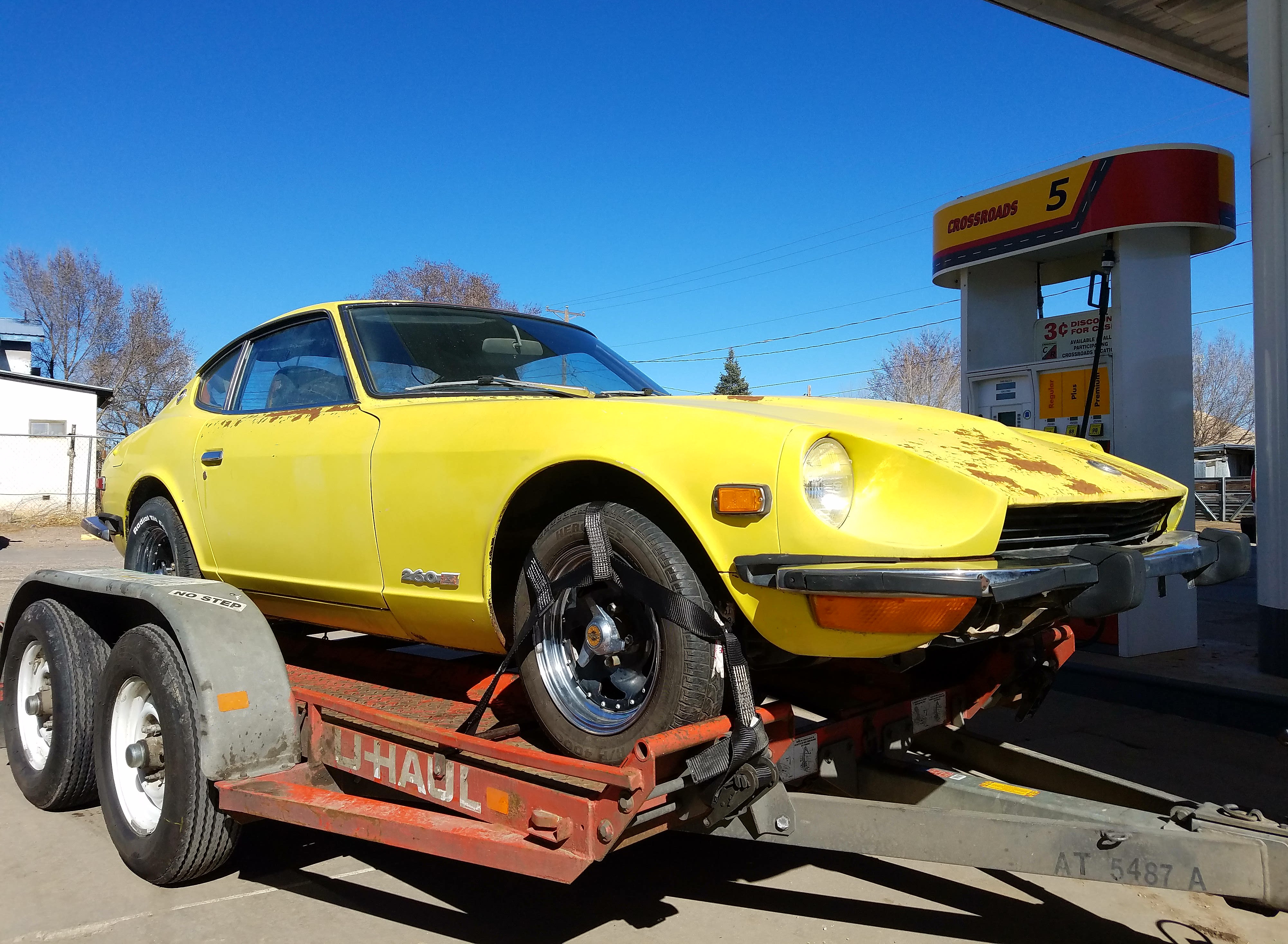

- I picked up a two owner early 260z from NM to resell (yellow). She was purring like a kitten within an hour of getting home.

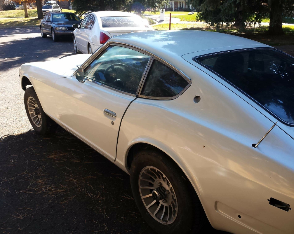

- I stumbled upon a "rust free" 72 two owner California car (white).  Cleanest underside I've ever seen. My 73 may go back to stock and be sold in order to keep this one.

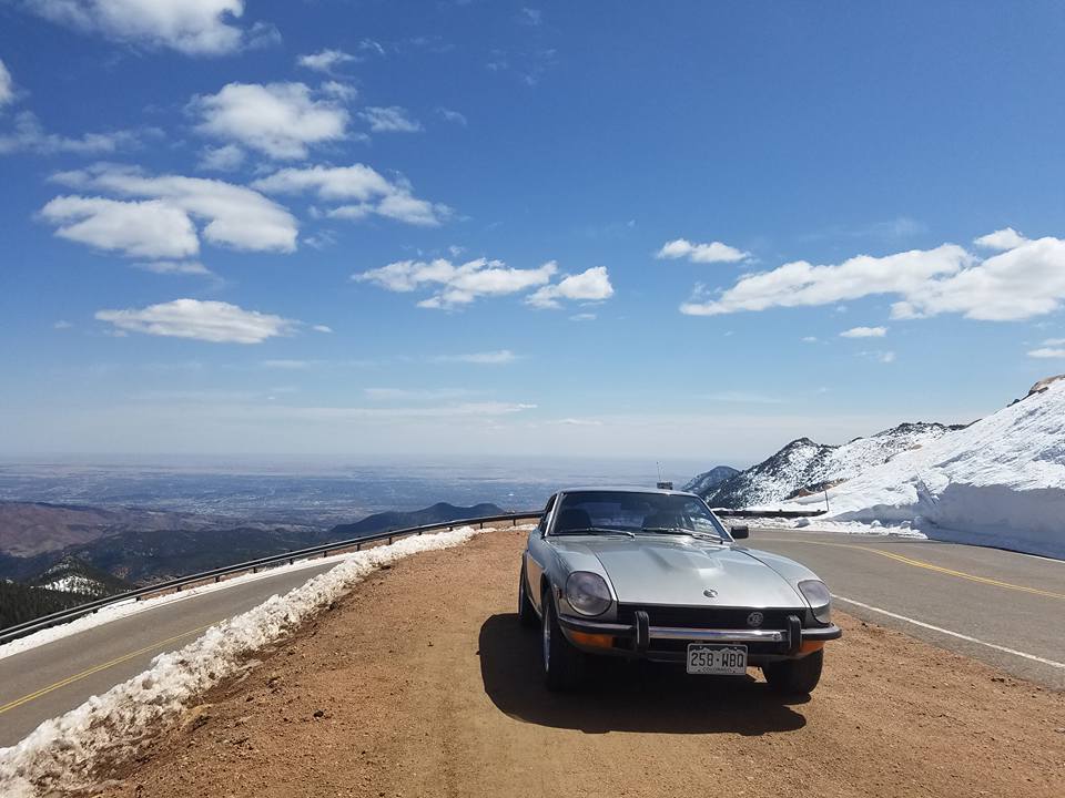

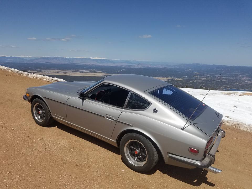

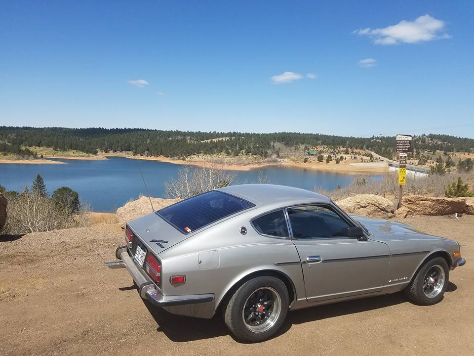

I decided to take her up Pikes Peak last week. What a blast. The 15,000+ foot summit was closed due to weather, but I made it up to around 13,500 feet. I hope you enjoy the photos.
