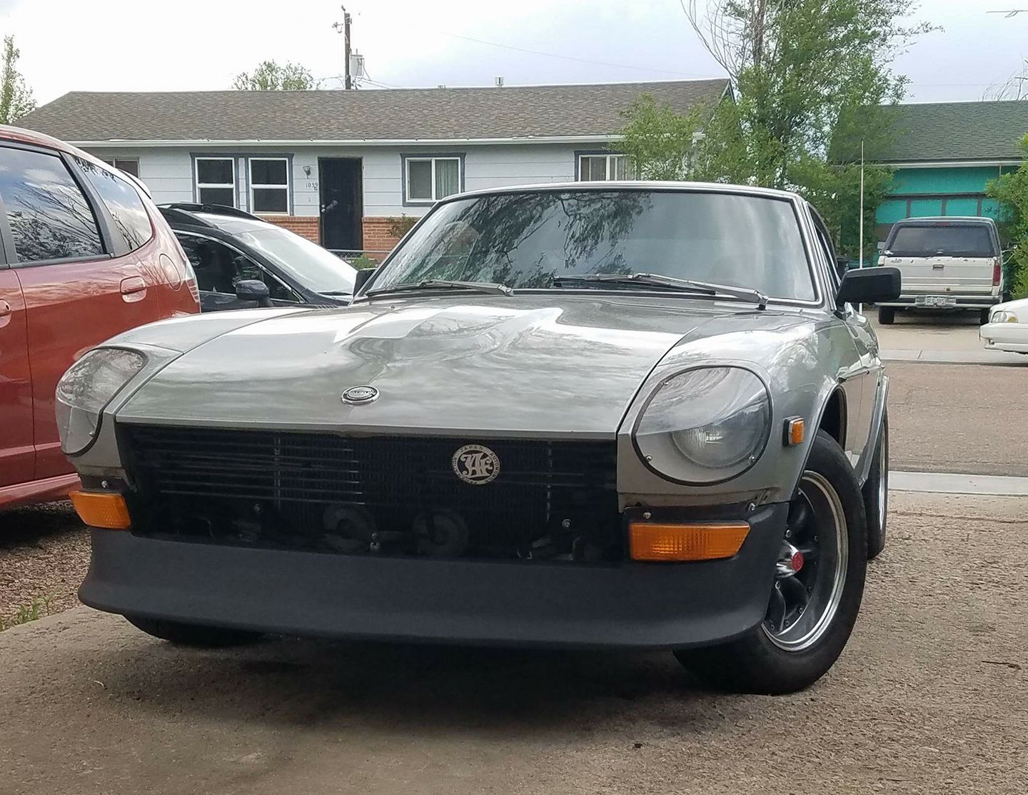

Installed Retro spec type 1 air dam
Installed early 240z front bumper

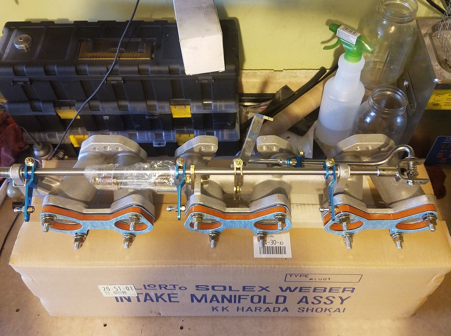

NISMO Mikuni 44 swap (Harada intake kit, Kameari fuel rail)

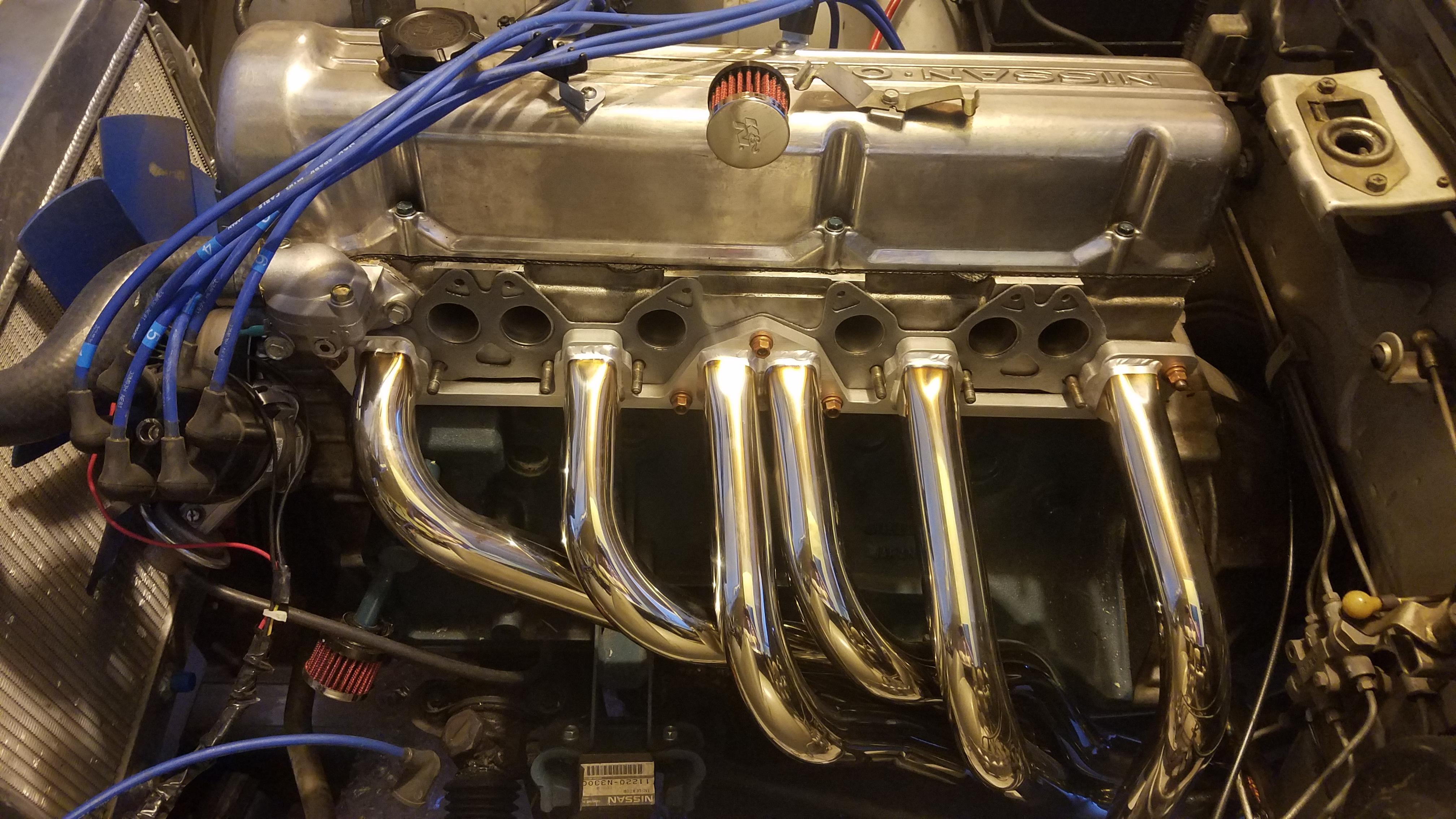

After much disappointment, for an unknown reason, the ZStory  header/exhaust did not fit my car so I returned it for a refund. There was no clearance at the trans crossmember and a header primary was touching my steering rod. There is much debate about this on Facebook group DPAN, whether my car is bent, the welder made a mistake, etc.
I got a refund and will be installing the Fujitsubo system soon. So far everything fits like a glove, plenty of space around the header. I'll upload photos when the install is finished.

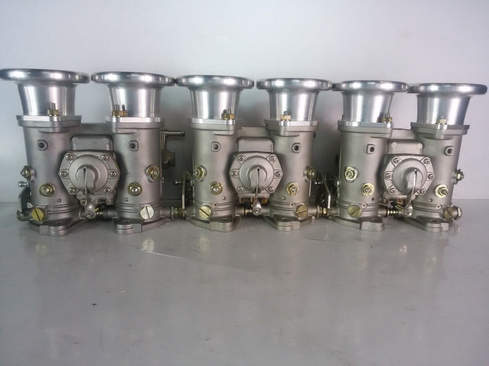

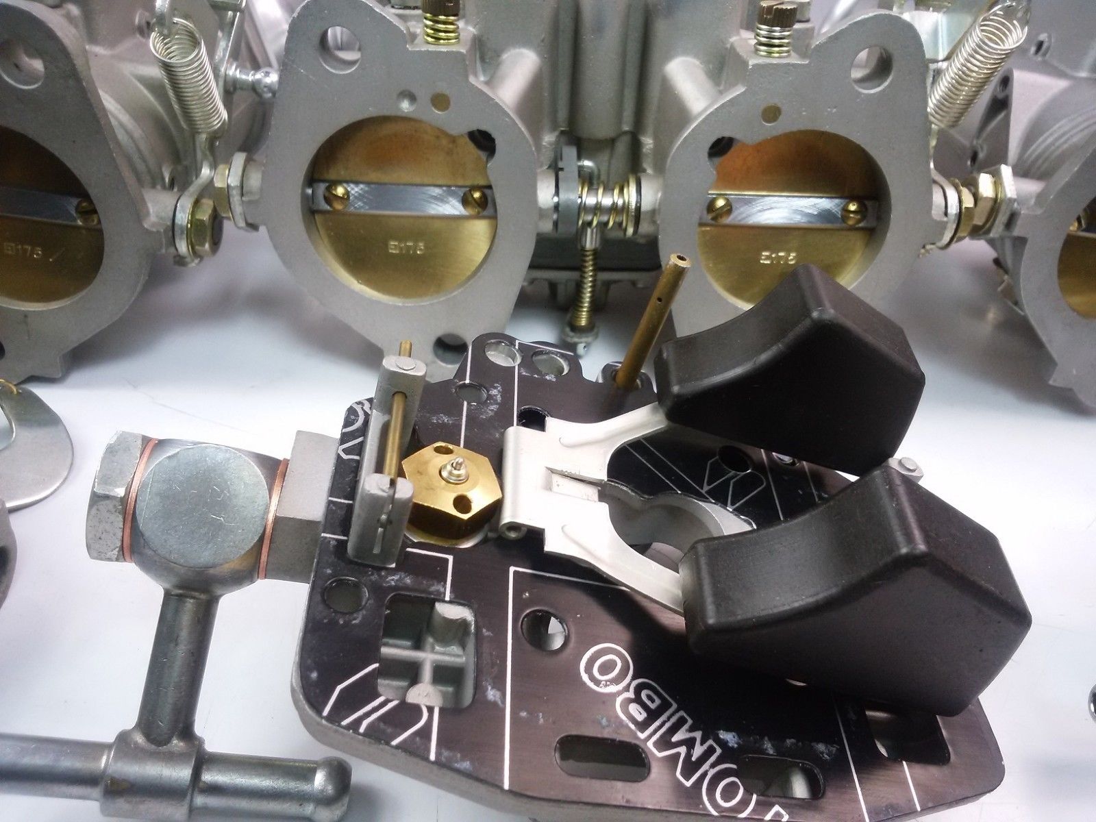

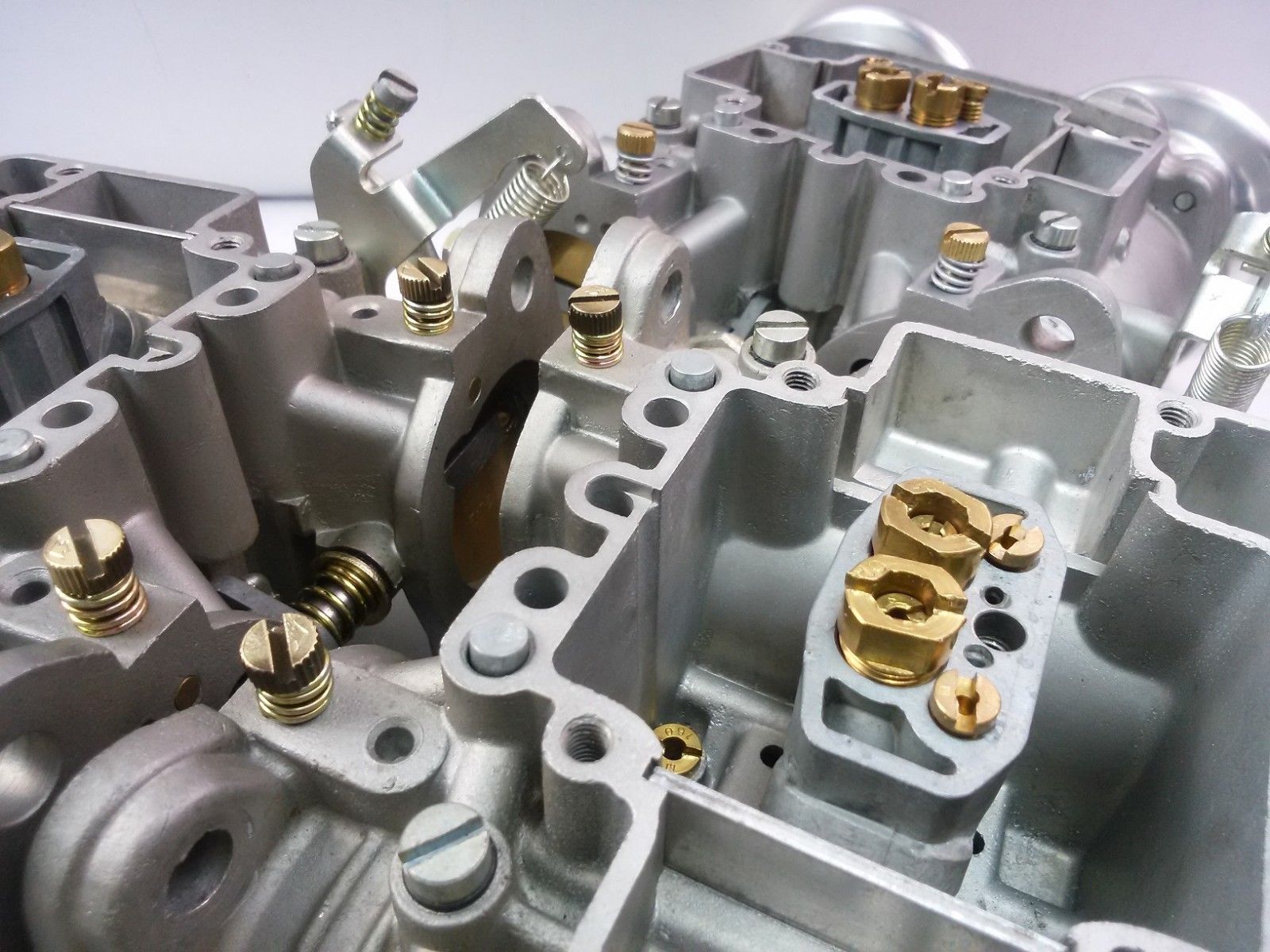

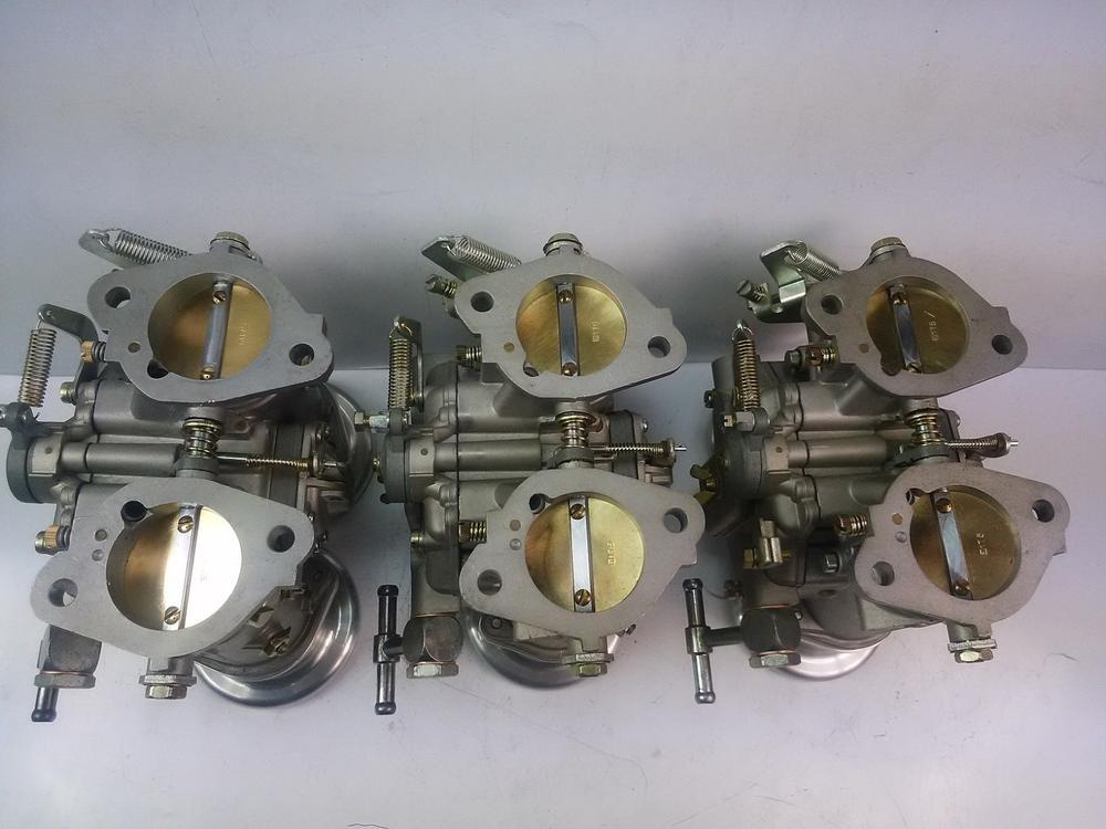

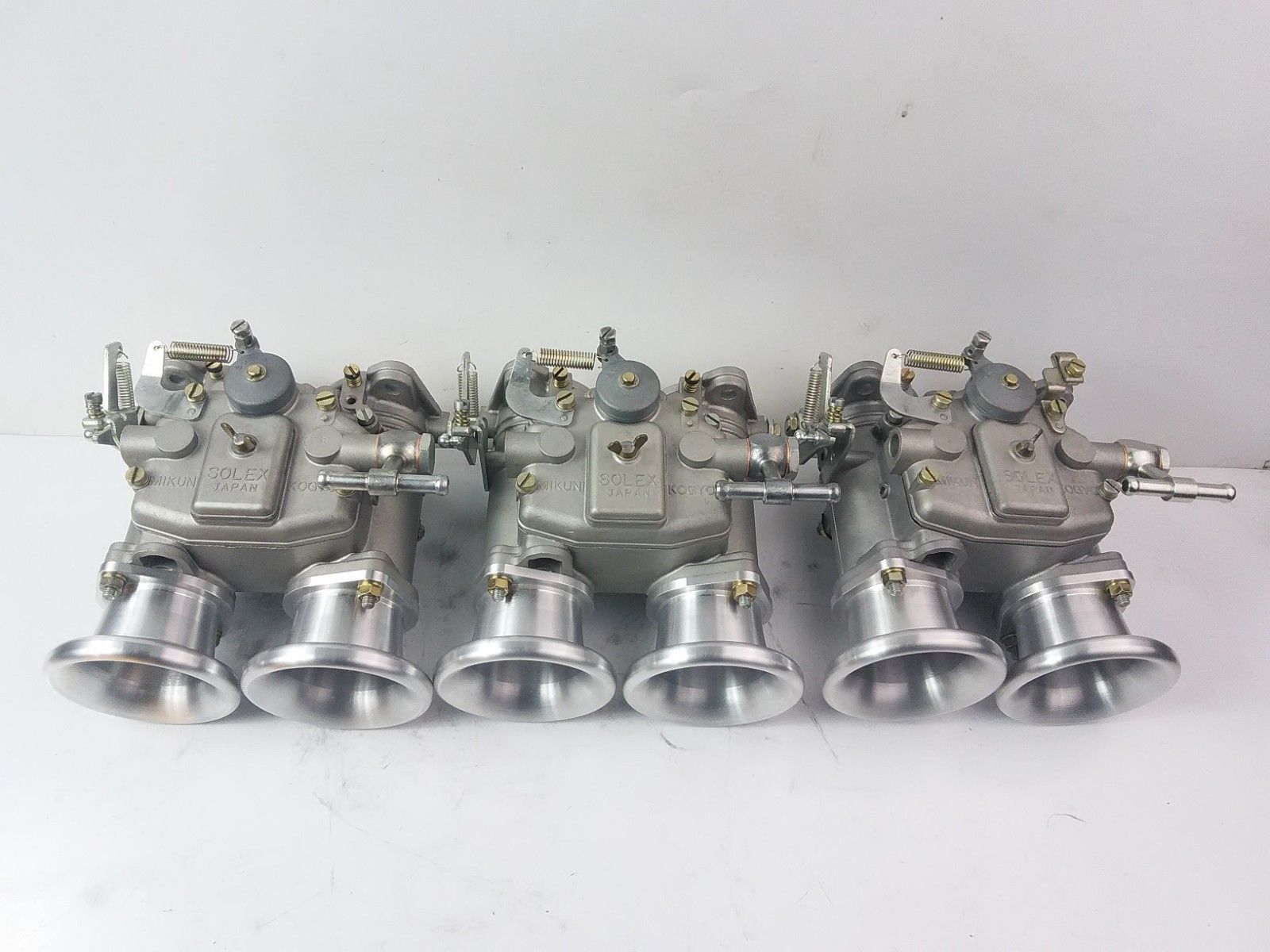

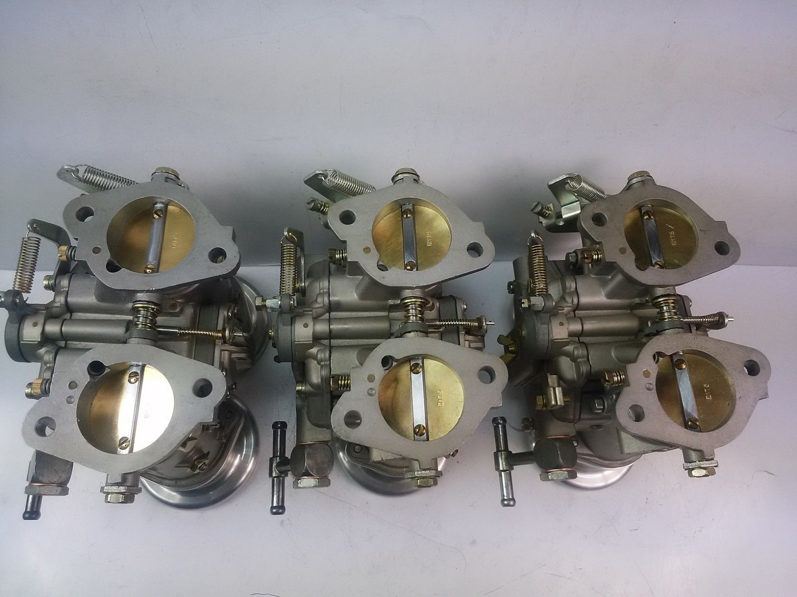

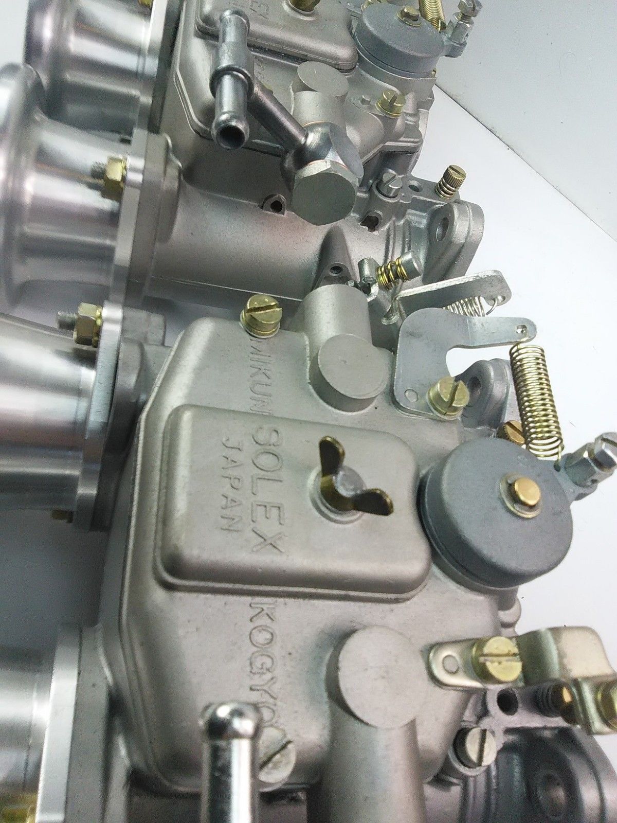

I ended up selling my completely rebuilt (by Eiji at Datsun Spirit) "NISMO" 44s also known as the Type 4. I instantly regretted it, and two weeks later bought these Type 3 Datsun Competition versions.

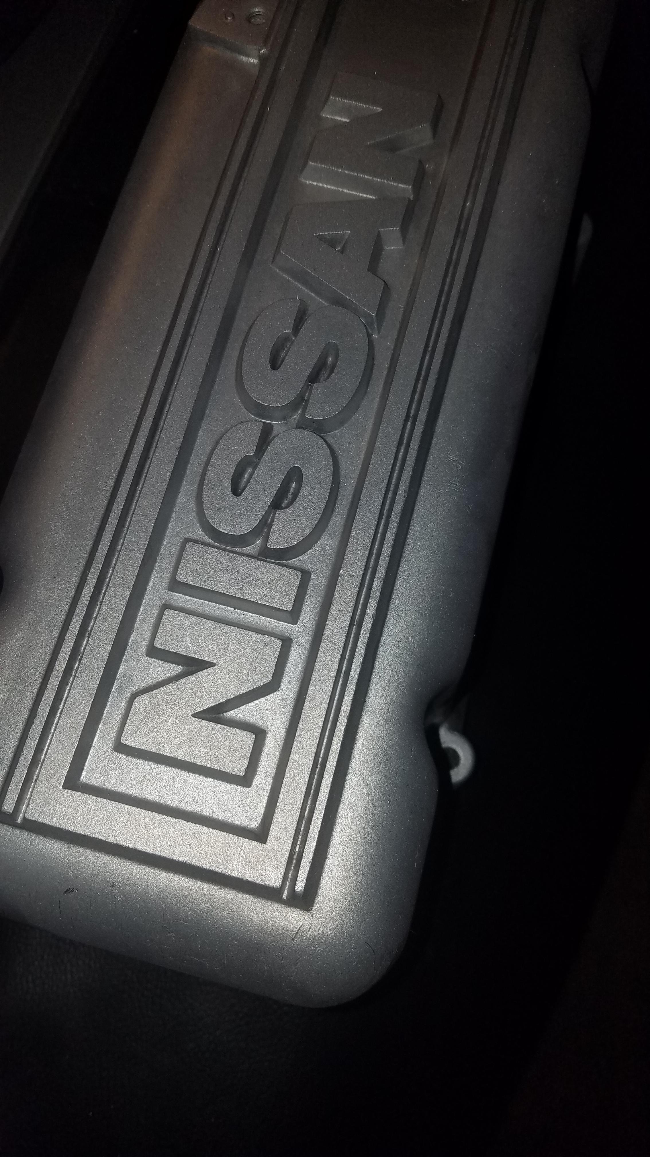

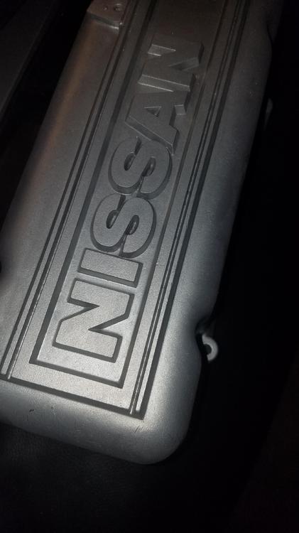

It's been a while. Fujitsubo is a work of art. I can't wait to hear the whole twin pipe system. A freshly vapor blasted JDM valve cover will be hydro dipped in black carbon fiber.
They both look great.  Lovely welds on the exhaust.
Please don't dip the rocker cover, just leave it as it is :)
