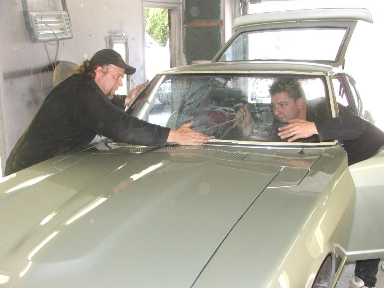

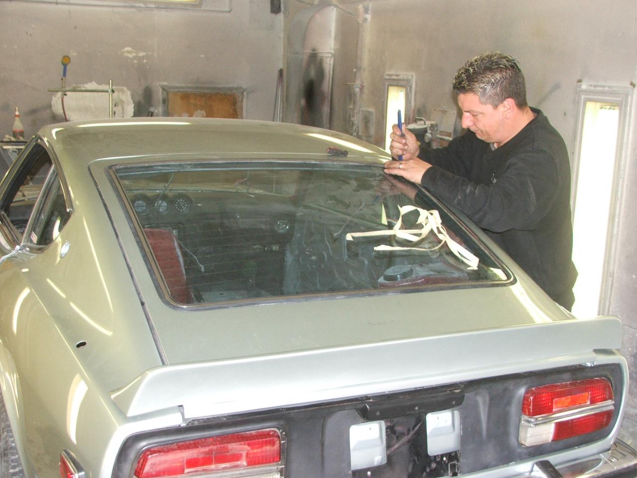

January 15, 201213 yr comment_377622 Pictures of glass installed by a mobile install company. They left the corner pieces until after the glass was in place. Used Black Dragon Kit and works great. No sealant and no leaks. Casey Link to comment https://www.classiczcars.com/forums/topic/41876-77-280z-front-window-trim-installation/#findComment-377622 Share on other sites More sharing options...
January 16, 201213 yr Author comment_377657 Just curious, are you talking about the corner piece that overlaps the long trim pieces? or the lower trim that starts at the top of the windshield corner and bends around the lower corners and meets in the lower middle on the bottom? I was thinking of removing the left and right long trim pieces installing the windshield and than putting in the trim hoping that once the weatherstrip and windshield is installed the gap I am getting with the trim would go away. What did they charge to install the front and rear glass? Link to comment https://www.classiczcars.com/forums/topic/41876-77-280z-front-window-trim-installation/#findComment-377657 Share on other sites More sharing options...
