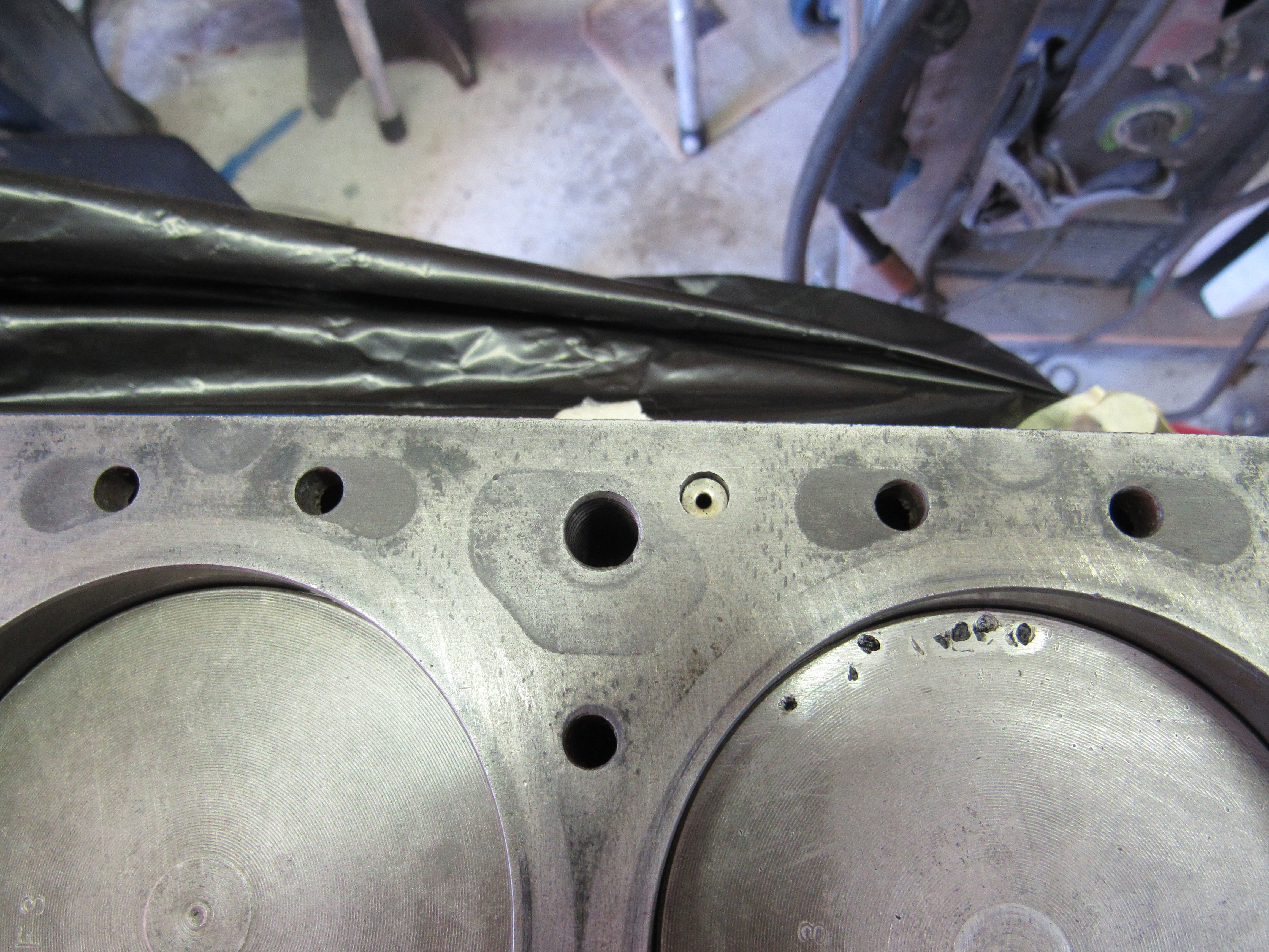

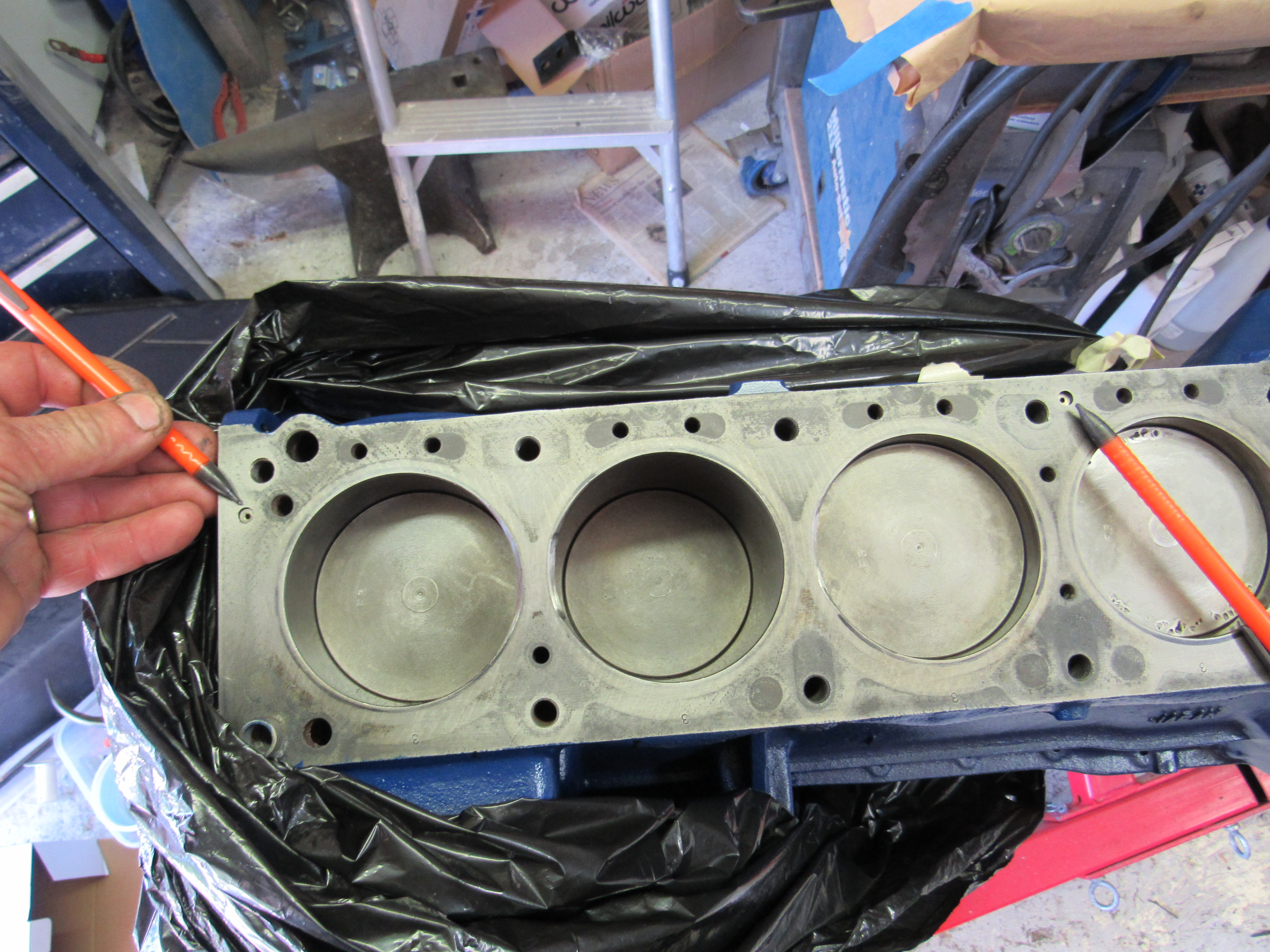

Bringing this thread back because I'm having the same problems, in my case I know the head and all passages are clean and free of debris, same with the oil spray bar. I even made small gaskets for the cam tower oil ports and put a bead of flexible Motoseal around the wiggly spray bar where it enters the cast aluminum C housing.  Any oil that is entering the spray bar is exiting through the 12 holes but as you'll see from the video it's more of a dribble than a jet.  The oil was cold when I did that test on the video but even when I was running the engine yesterday and the oil was hot there still wasn't enough oil to lubricate the cam.

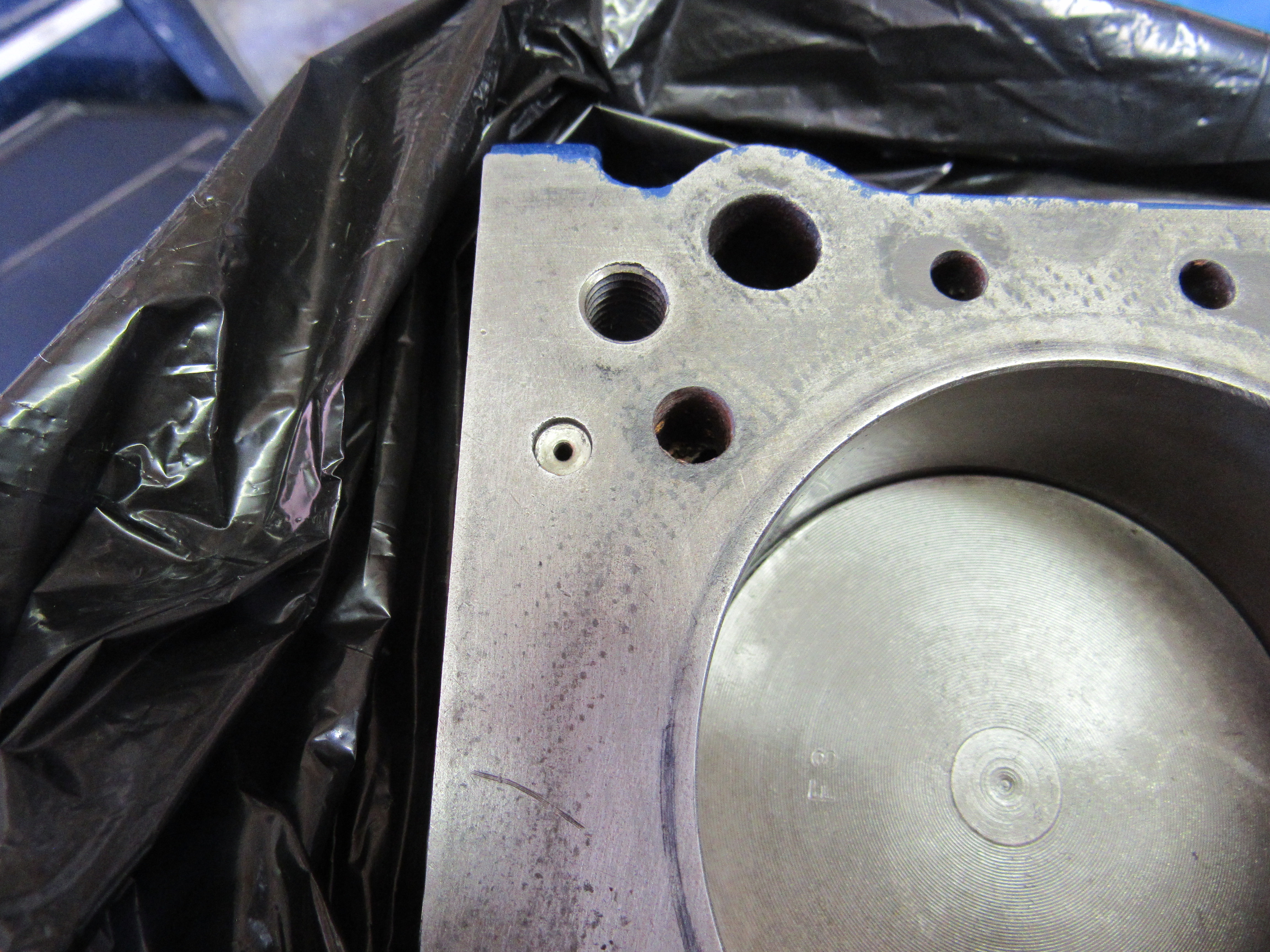

Where I'm thinking the problem lies is the 2 restricted oil ports in the top of the block, They are tiny and when I was reconditioning the block I didn't want to screw them up so I left them in place but couldn't really be sure those passages were clean.
Even if I remove the head again I can't drill those tiny holes bigger without introducing metal filings into the oil passage, I guess I could use an awl and of mash them wider.  In fact I'm not even sure why those restricters are there in the first place, in the head the oil bar already has a restricted orifice going in.
Any suggestions?
