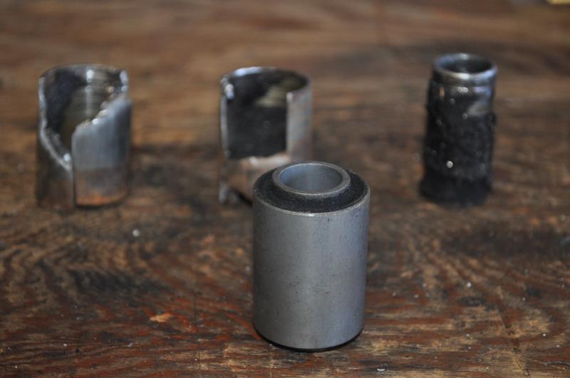

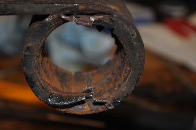

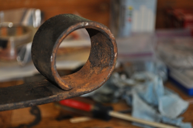

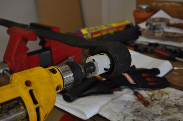

First, on the control arm, you do not need to buy the whole assembly but you will need to remove the old rubber / metal bushing from the end that attaches to the frame. It is the same for the rear control arms as well. There is a lot of info on the site with regard to techniques that other members have used to do this, up to and including buring out the old rubber part, but needless to say whatever method you end up using it is still a PITA. Personally, I use a hole drill that is slightly smaller than the ID of the bushing and drill out the rubber part. That will give you pretty good direct access to the metal sleeve. I end up using a hack saw and very carefully cut through the sleeve in a couple of places so that I can then use a punch to literally "peel" out the old bushing. I did this just this past week to my fron control arms. One of them turned out to be a breeze while the other was a real PITA to get out. Here's some pictures from the work that I did on my rear moustache bar that I think will give you a good idea. It is a different component, but the process for removing the bushing is the same.
In addition, the rubber bushing is still available from Nissan and the part number is:

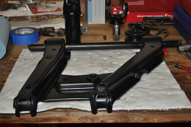

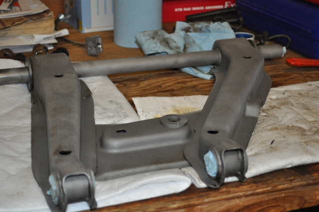

I also invested in a fairly inexpensive blast cabinet from Harbor Freight when I started all of this and it has been worth its weight in gold. I have sand blasted all of my components down to bare metal and then painted them. Essentially the same thing you are doing except I dod this with a blaster while you are using some sort of chemical to remove rust, etc. It sounds to me like the blasting is easier (and perhaps cheaper) but you do need to have the room for one as well as a compressor.
For paint I ended up using Rust Encapsulator from Eastwood as my primer and then Satin Black Chassis Paint for the finish (also from Eastwood) and am very happy with the result. See the pictures above of my rear control arm for reference.

Thanks. The bushing pictured sure looks similar to the front control arm bushing. But why can't it be pressed out? I realize that pressing on the rubber or inner metal tube would just rip out the rubber without moving the outer tube, but why couldn't you use something like a socket or a disc small enough to fit inside the control arm proper but wide enough to get enough surface on the outer bushing tube for high pressure?
Now that I bothered to look, that is the part number. Wonder why the FSM said to replace the whole control arm? Cost more for the mechanic's labor to get the old bushing out than a new arm? At least when the car was new?

Chris,
You have pretty well identified the reason for the FSM to recommend replacement of the LCA assembly: pressing out the old bushing is not an easy task and requires exactly the correct dia. tool to hit the bushing and not the surrounding LCA. My approach years ago was to hacksaw sections out of the bushing until I could get enough relief to pry out the remainder. Pressing in a new bushing does not have the tool mating problem.

Jim,
I went for it and found that a 1 inch Craftsman socket fit the bill. Gave the area flame for a couple of minutes then used a friend's small press. Came out easier than any of the U-Joints I've taken apart. It looks like the front-most bushing in Mike W's 4th photo above, though the rubber in mine was falling apart. I didn't have rust like in his mustache bar to deal with, and I've only pressed one out so far, so complications could well develop.
