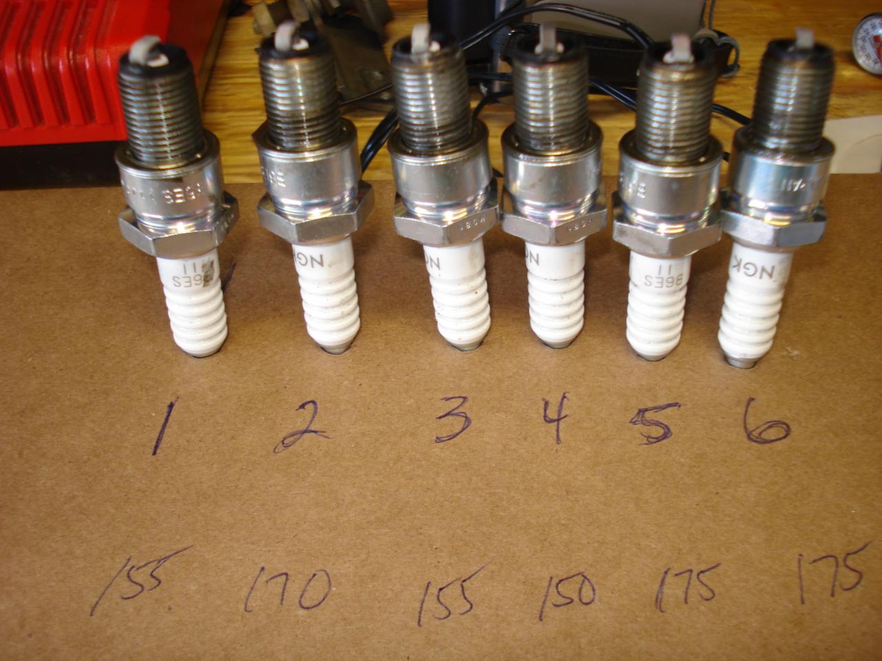

That is all correct Captain Obvious. I'm not sure what you don't understand...you pretty much said exactly what I did. I probably didn't explain clearly. When I started the car (cold) and it had it's typical unstable idle I rotated counter weight CCW and it stumbled more saying to much fuel. Then I rotated it CW (leaner) and it perked right up and idled where it should on a cold start. Hope I was able to clear things up. The mechanic did what he did long before this. About 1 1/2 years ago. I pulled plugs and they look good, I think. I will post pics soon. I also ran a compression test this afternoon. Here are the results: 1-150, 2-170, 3-155, 4-150, 5-175, 6-175. This could be why it doesn't idle that smooth. I did last valve adj. about 4 months ago at the latest. 1,3,&4 are a little low compared to the other three. I will try adding some oil to those cylinders and test them again. Again...grasping at straws I know. Any thoughts? Capt Obvious, let me know that I cleared things up.
120k isn't really many miles on an engine. Mine has 170. That said, your compression numbers are a bit uneven -- not enough to indicate a problem, but a bit uneven still.

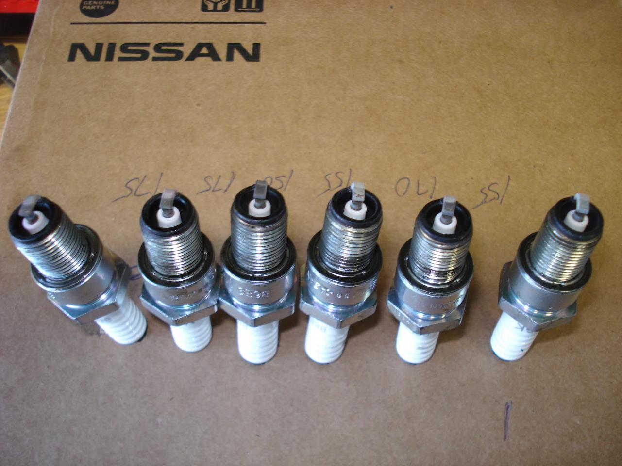

Your plugs have interesting bands on the ground straps.
It may have to do with timing.
I found this on the net so I am not sure how accurate it is however do some searches on what 280z EFI plugs should look like and also double check your timing.

No, you explained it just fine. Haha! I'm pretty sure my post #74 is what a brain fart looks like when you take that time to type it out. :stupid: Well I got that pretty picture posted anyway! That's got to count for something, right?
Back to reality... Seems to contradict the AFM test results, but I agree with you. Those plugs look lean, not rich.
Maybe I should put the timing back to factory setting and run it and see if the plugs look different.

I went to NGK's web page and my plugs look like there is a combination of 2 of the plugs displayed. Mine look normal and at the same time have "dry and wet" fouling look to them. Strange.
ngk.com/tech_support/spark_plugs/faqs/faqread.asp
