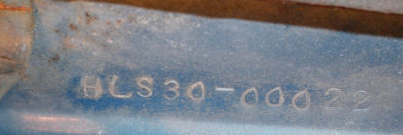

The VIN number on the firewall looks like the "HLS30-000" part is a very different font from the "22" font.

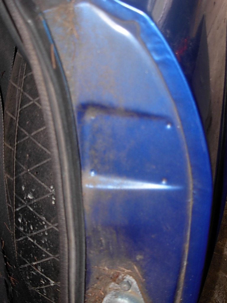

The size of the rivets on the dash seem bigger than on vin 48 http://www.atlanticz.ca/zclub/members/gabringuette/index.html

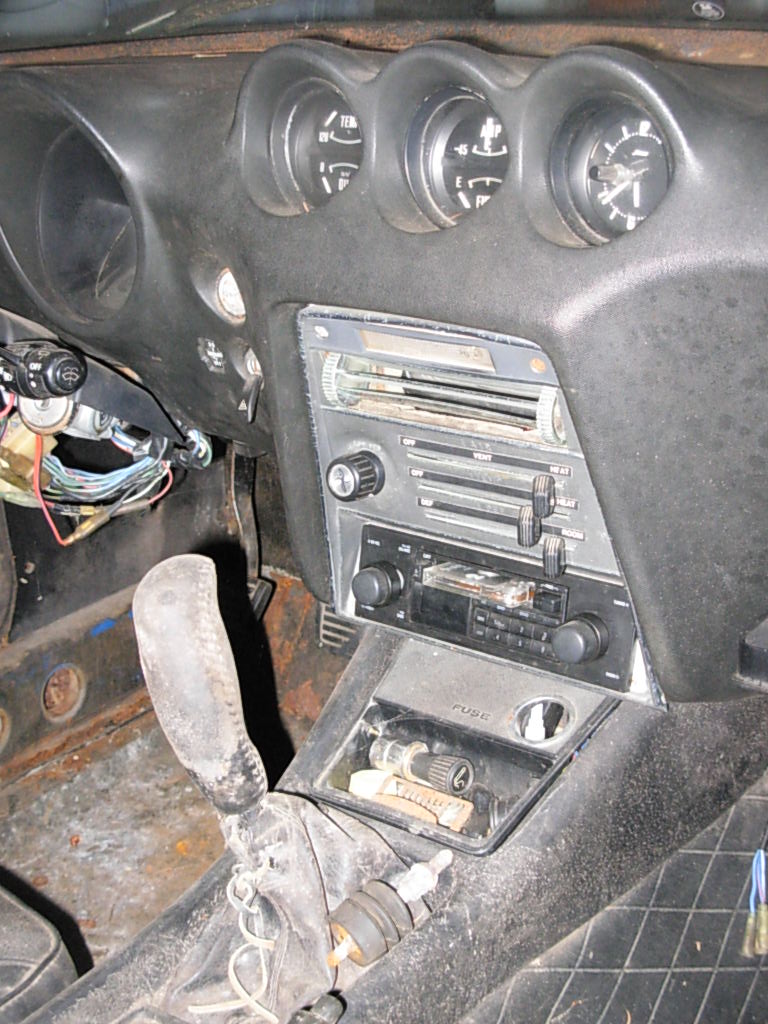

My personal sense is that this is #22, and not a doppelganger, just based on the photos. Everything looks equally old, including the data plate, and these cars were pretty much worthless until recently - it would take more money than the car is worth to try and fake it to this degree, IMHO.
I agree that it most likely what is left of HLS30-00022. I wouldn't make too much of sloppy firewall stamping/engraving. That is pretty common for the early cars at least. Dashes are easily swapped and the one in the car now is from a 72 or 73, so no surprise the VIN tag would be swapped on it. However, it is missing the door data plate, which is a bit more troubling. There are no holes where the plate would mount either, so I assume this is a replacement panel?

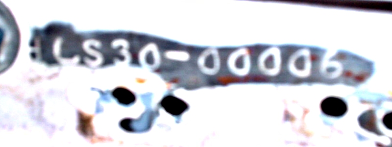

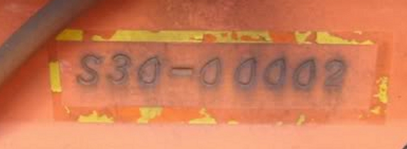

Yup,I checked earlier Z's and they also have the strange sloppy-font stamps. It would be interesting to know when they changed over to cleaner stamps. The zero's look like tear drops.

HLS30-00048 has been fully restored. A rivet size issue would not be surprising to me.
I think we pretty much discussed to death the idea that firewall serial numbers were engraved and not "stamped". That's why they don't have a uniform look.
Actually all of the zeros look the same in the pics I inserted ... sort of like a teardrop... so they look to be stamped from an engraved stamp master. Likewise the soft curvy "L" with a hooked end looks the same.
Edited by Blue
Couple of observations:
What was the outcome of the discussion, stamped? I doubt they would be engraved. Possibly the prefix was stamped first (HLS30 000) with the 01 to 99 being stamped later as required. The 22 looks too uniform to be engraved, ie both 2's are identical.
