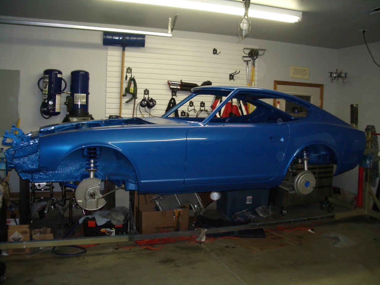

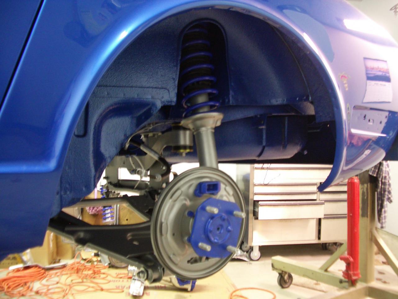

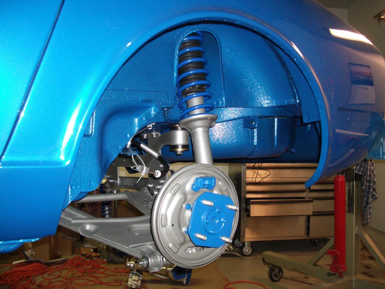

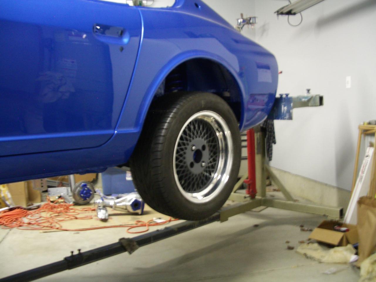

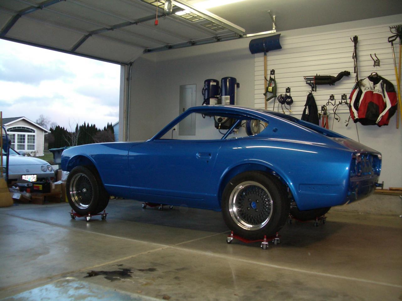

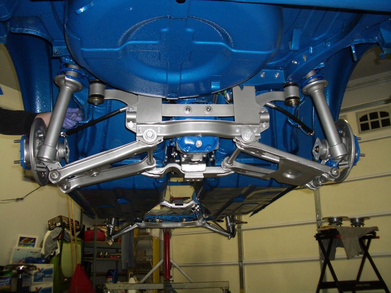

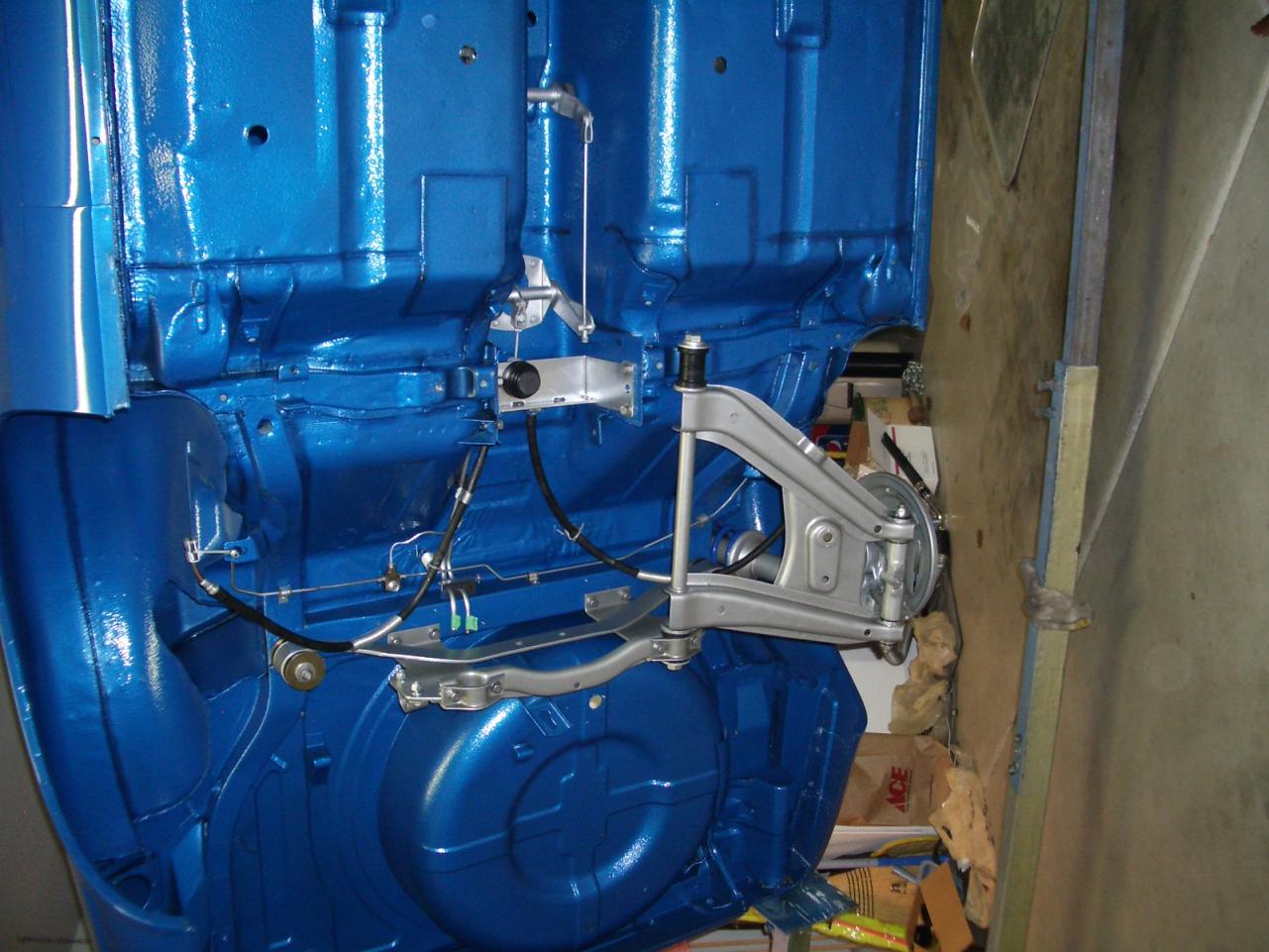

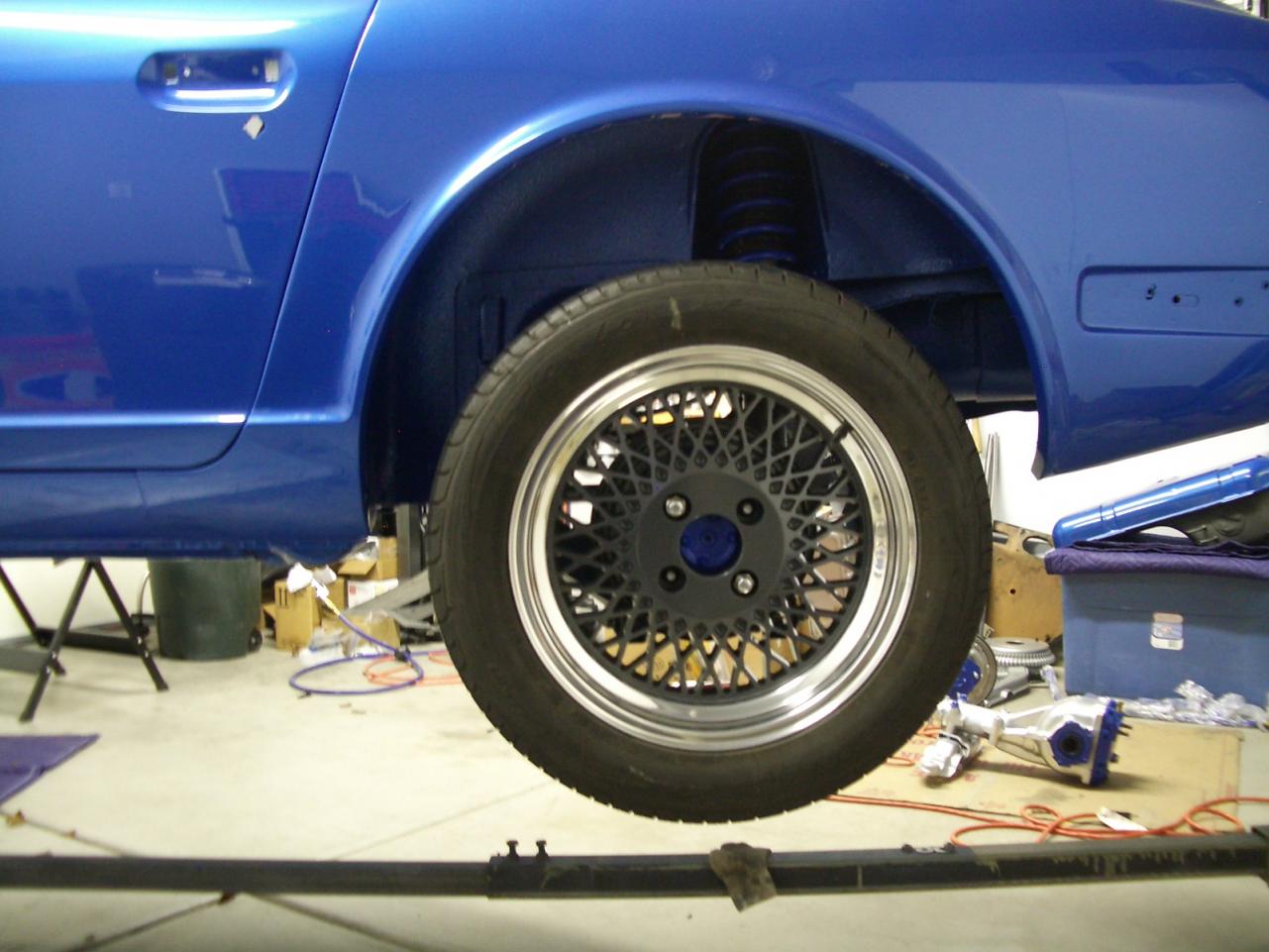

Posted January 18, 201213 yr comment_378008 Starting a thread to share the reassembly progress of my early 260Z after the rotisserie refresh.. I've posted some photos of the progress in various threads but want to consolidate this into one spot for the remainder of the process. This seems like the right place for it so here goes... After some major massaging, finally got the R/T Mount installed and the driver side rear suspension is hanging as well. Couldn't resist the urge to put a wheel and tire on it. Link to comment https://www.classiczcars.com/forums/topic/41992-assembling-early-260z/ Share on other sites More sharing options...
January 18, 201213 yr comment_378012 Absolutely fantastic work, Tom! That is going to be a stunning 260Z, great job! Link to comment https://www.classiczcars.com/forums/topic/41992-assembling-early-260z/#findComment-378012 Share on other sites More sharing options...
January 18, 201213 yr comment_378020 Liking the blue color- nice work! Link to comment https://www.classiczcars.com/forums/topic/41992-assembling-early-260z/#findComment-378020 Share on other sites More sharing options...

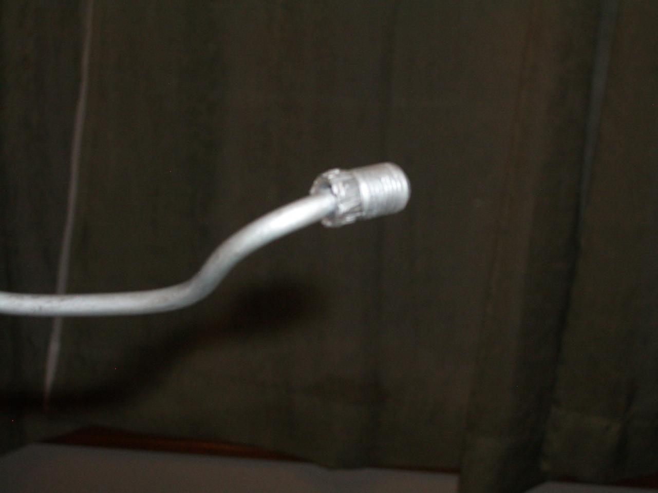

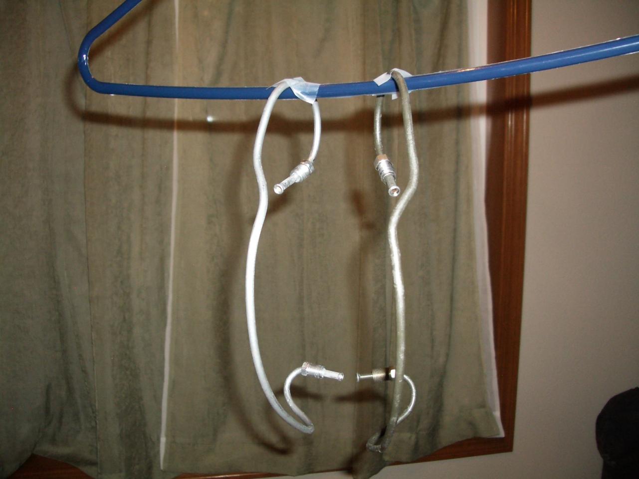

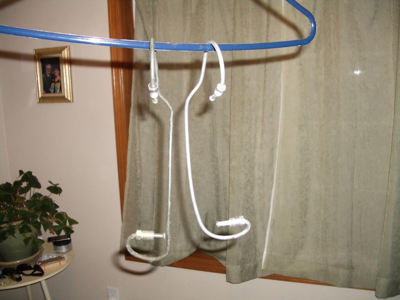

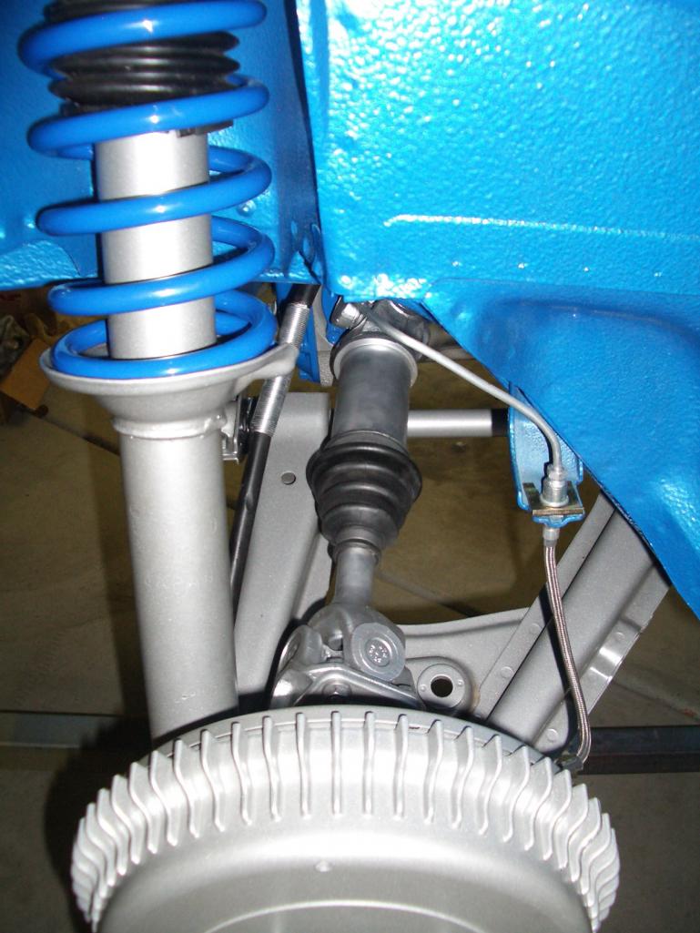

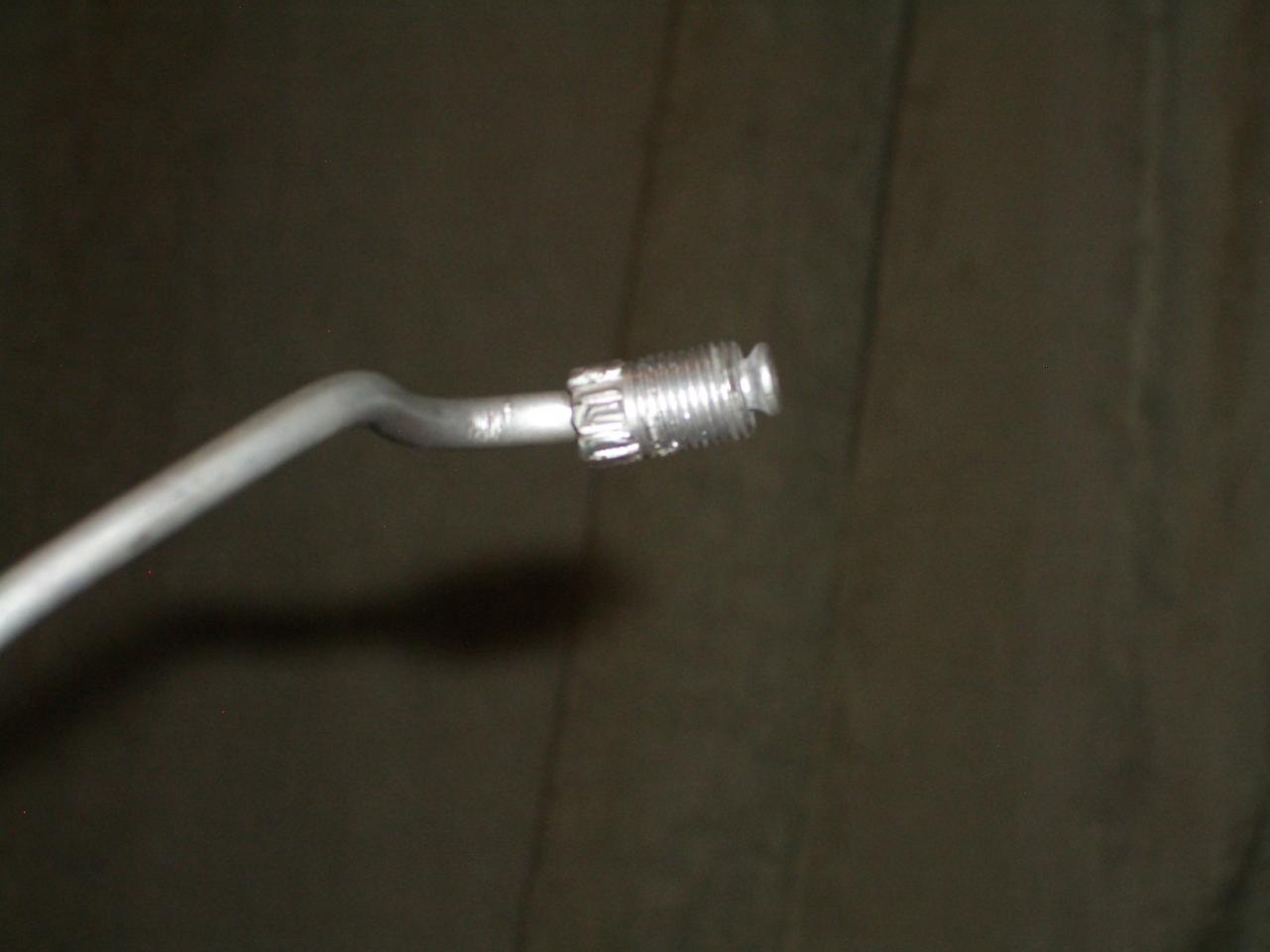

January 20, 201213 yr Author comment_378244 Thanks Leon and Steve... I've been busy bending new brake lines.. Previous owners used a pair of pliers/vice grips a few too many times on the originals. A couple photos showing the carnage as well as the nice new piece. The hard lines that run behind the rear backing plate from the flexible line to the rear wheel cylinder take some time to recreate. I started with a 24" section of new tubing and used all but 8" of it.. One of the lines is stock and the other I bent. Not bad for a pilot! Link to comment https://www.classiczcars.com/forums/topic/41992-assembling-early-260z/#findComment-378244 Share on other sites More sharing options...

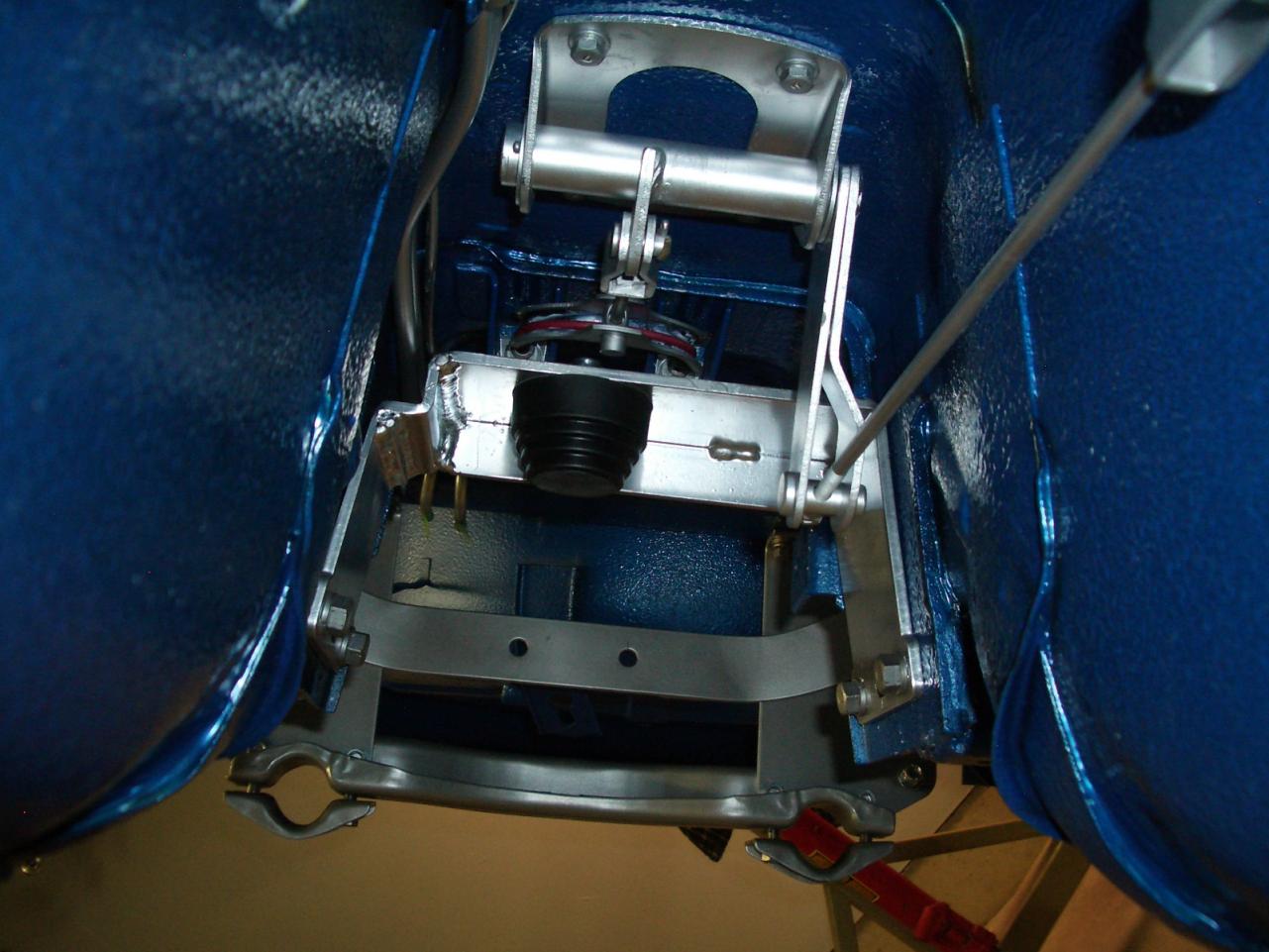

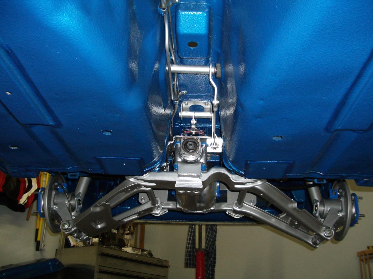

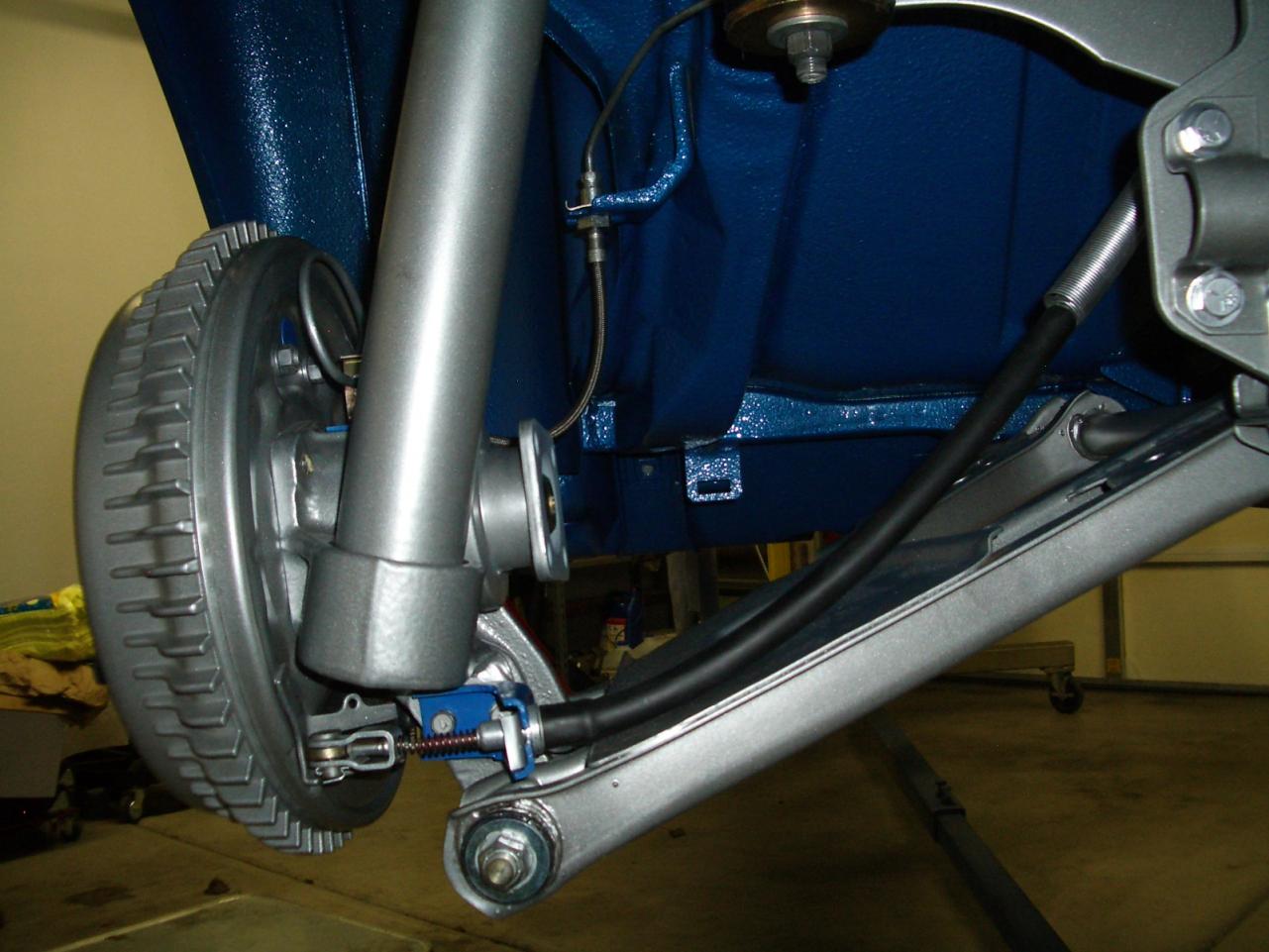

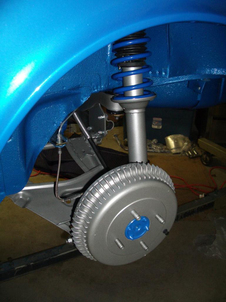

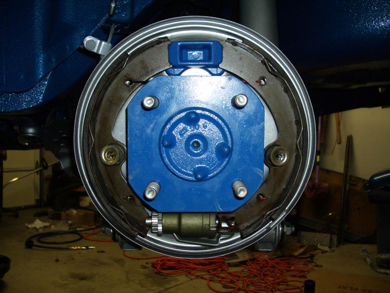

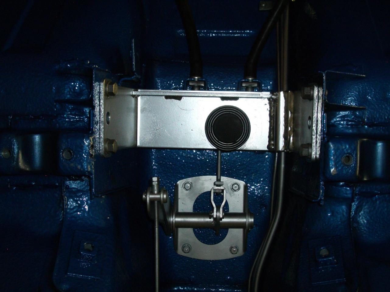

January 21, 201213 yr Author comment_378306 Finished up the rear suspension installation with the exception of the sway bar. Rear brakes and e-brake installed as well. Should be off the rotisserie tomorrow!! Link to comment https://www.classiczcars.com/forums/topic/41992-assembling-early-260z/#findComment-378306 Share on other sites More sharing options...

January 21, 201213 yr comment_378326 Beautiful! Don't forget to do the final torquing of suspension fasteners with the car on the ground and at full road weight. Link to comment https://www.classiczcars.com/forums/topic/41992-assembling-early-260z/#findComment-378326 Share on other sites More sharing options...

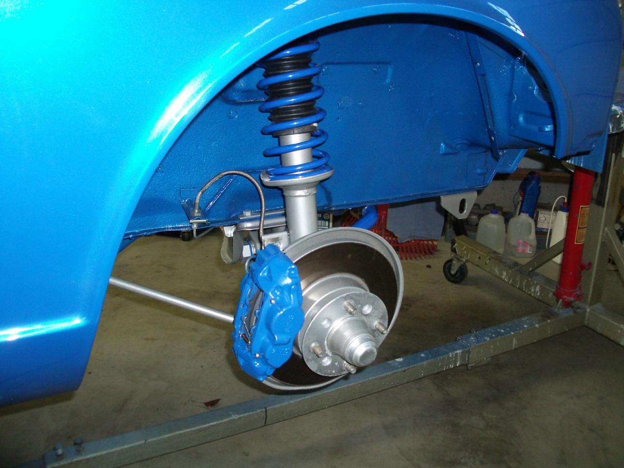

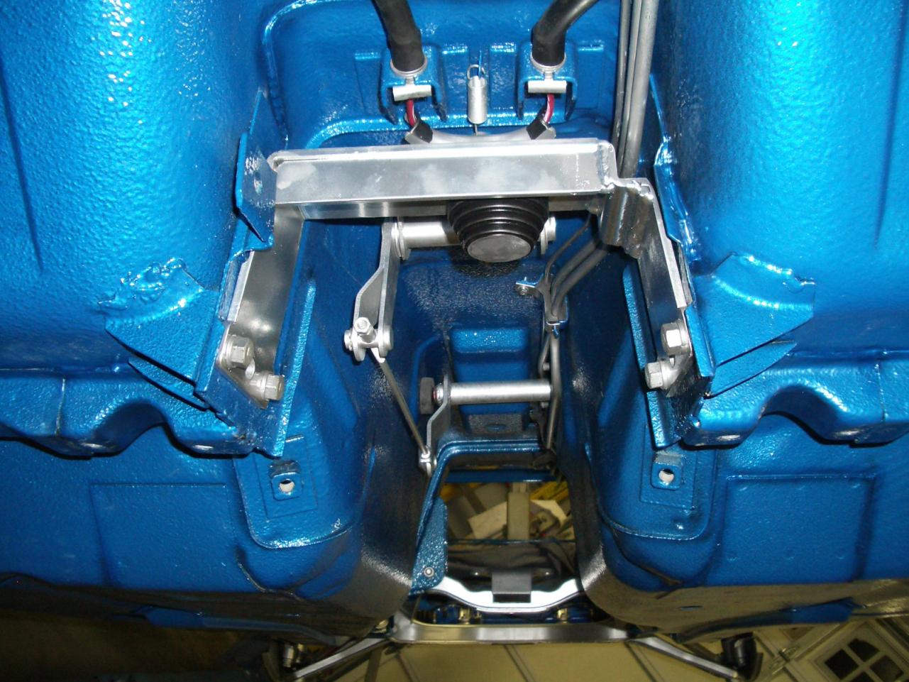

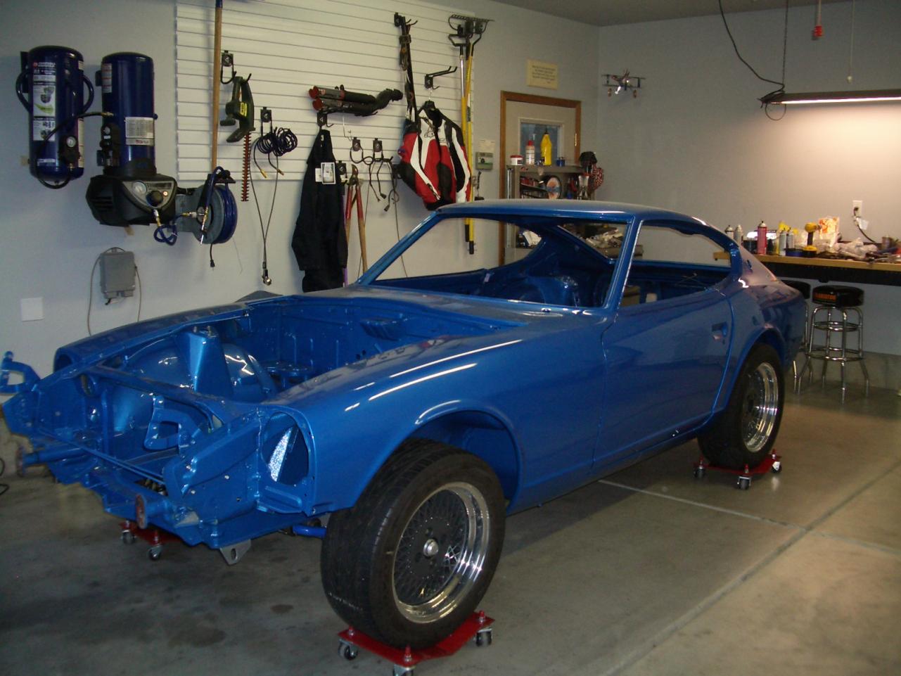

January 22, 201213 yr Author comment_378405 Thanks for following my work guys! I'm enjoying the process of making this car better than new after owning it for the last 19 years.. I like the silver suspension pieces as well Bonzi Lon, it really stands out against the blue underside of the car... Thanks for reminding me about the final suspension torquing Leon, I'll make sure it's done when the car is on the alignment rack. I've just 'snugged' the suspension pieces for now. It's a long road GraphiteZ but it is very rewarding to touch, clean and renew every part on your car.. Looking back through my photos, the car has been on the rotisserie for 12 months 2 weeks and 3 days. It has certainly come a long way in that time. I'm so happy to have it back on it's own four wheels!! Got the stub axle bolts torqued to spec today, filled the differential with gear oil, installed the half shafts and rear sway bar. Assembled the front hubs, brakes and calipers. The undercarriage is ready to go with the exception of the final torquing as Leon pointed out... Not so many photos today but it does look like a 'car' again!! Edited January 22, 201213 yr by Rainman Link to comment https://www.classiczcars.com/forums/topic/41992-assembling-early-260z/#findComment-378405 Share on other sites More sharing options...
January 23, 201213 yr comment_378521 That looks amazing! I'm going to use the pics of the ebrake to help me re-install mine. Link to comment https://www.classiczcars.com/forums/topic/41992-assembling-early-260z/#findComment-378521 Share on other sites More sharing options...
