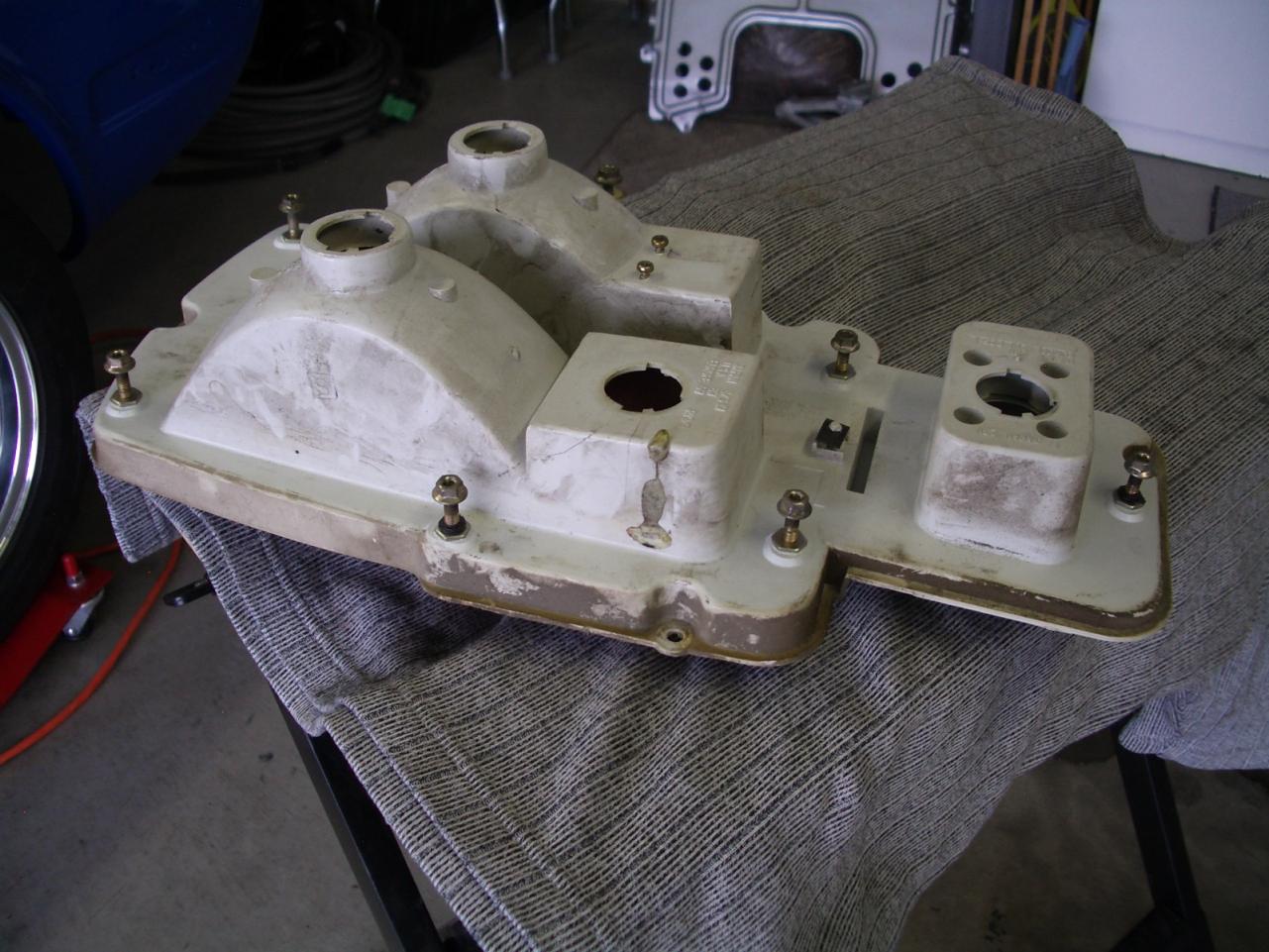

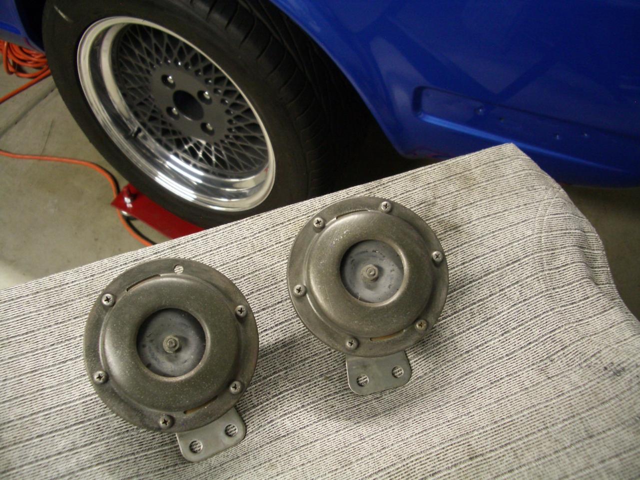

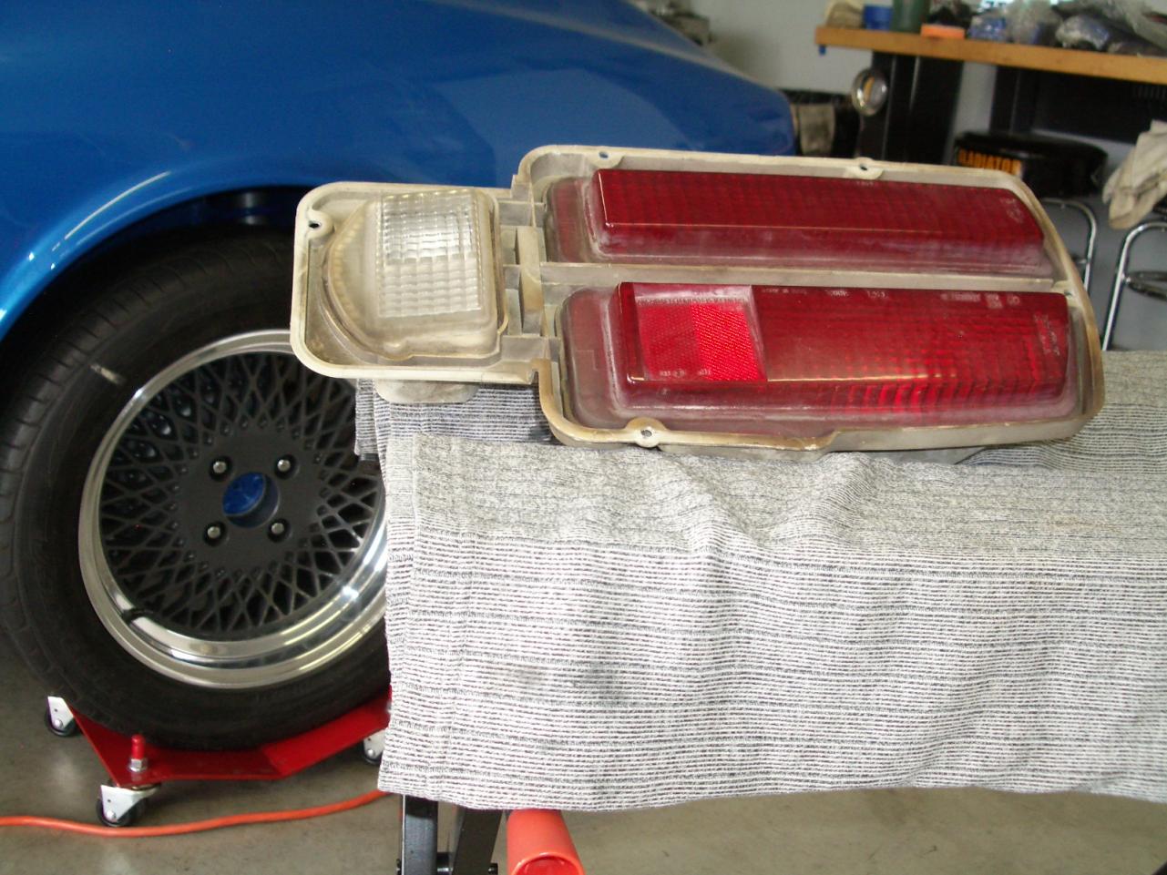

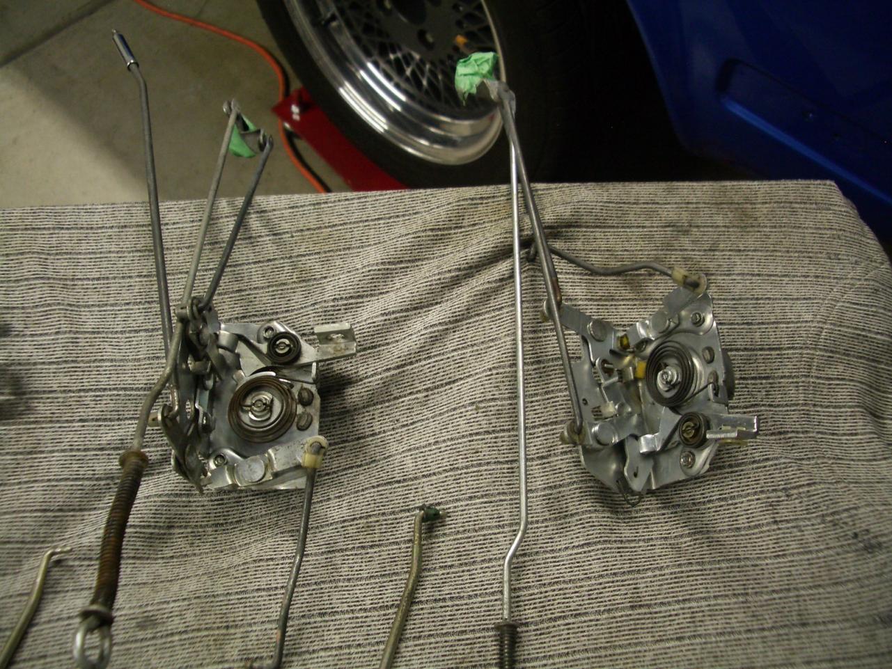

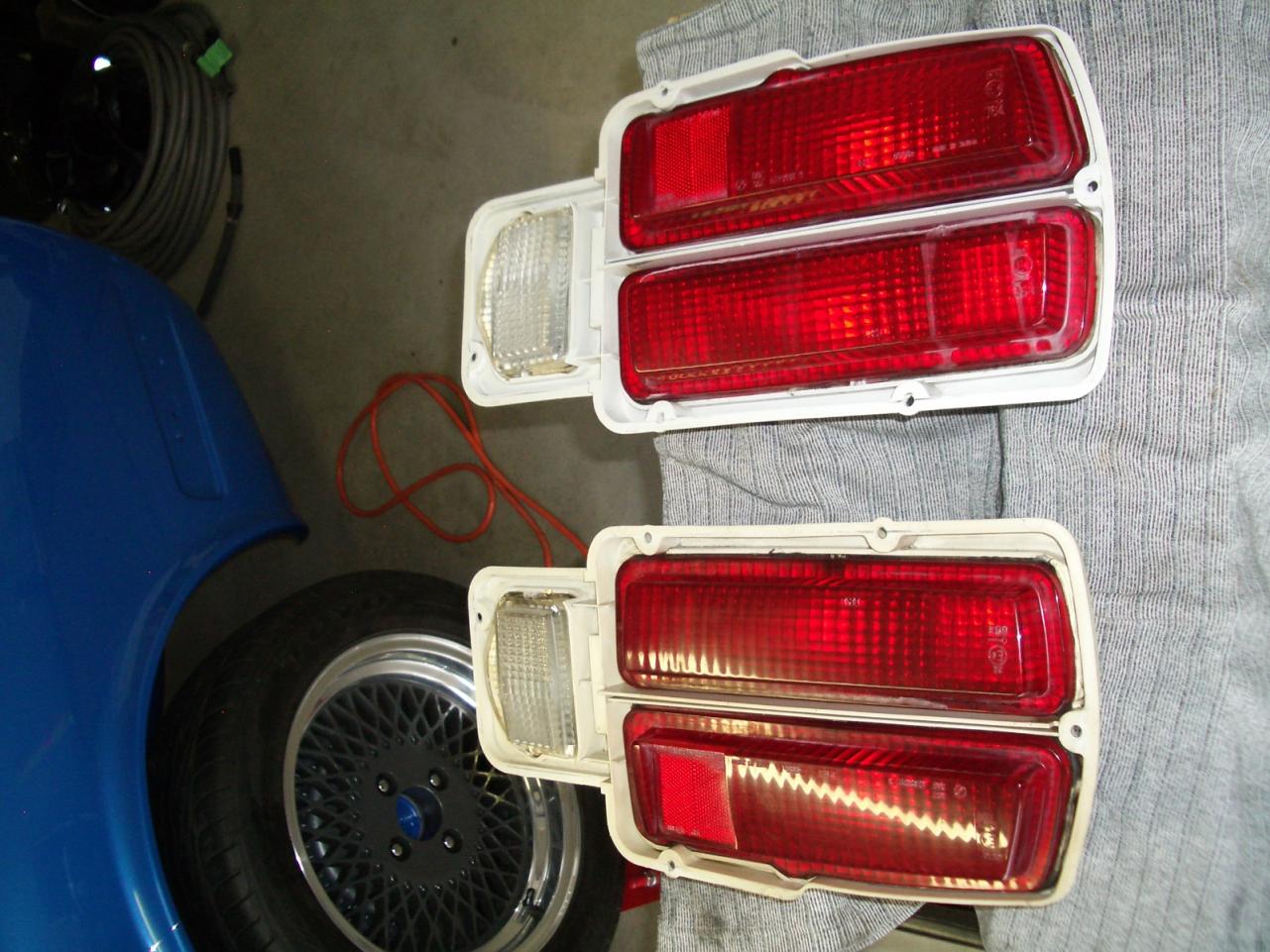

Spent the afternoon cleaning parts in preparation for shipment to Zeddsaver in Canada for repair, restoration/replating. Tail lights, horns and door lock mechanism parts were all pretty nasty. Not any more. Here are some before and afters of the tail lights as well as the final product of the horns and door lock mechanisms...

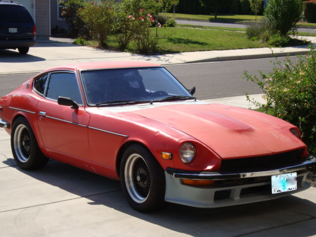

Thanks for following my progress Zdogg.. My 260Z has needed this kind of attention for over a decade. Here's a photo of it before I started (it wasn't even a forty footer by any measure)...

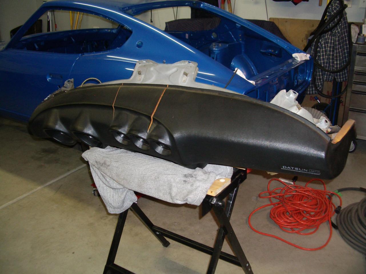

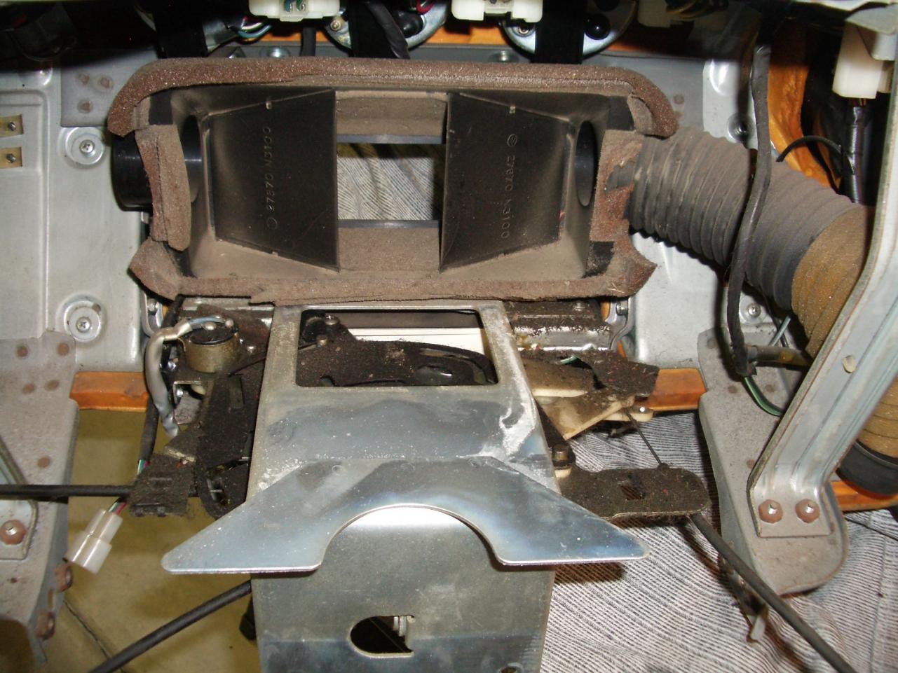

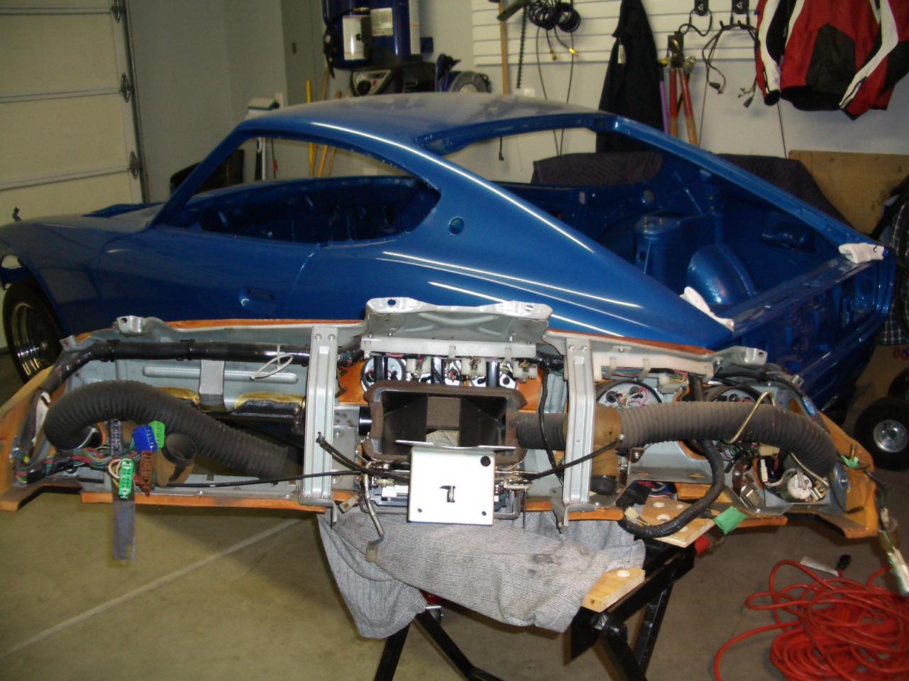

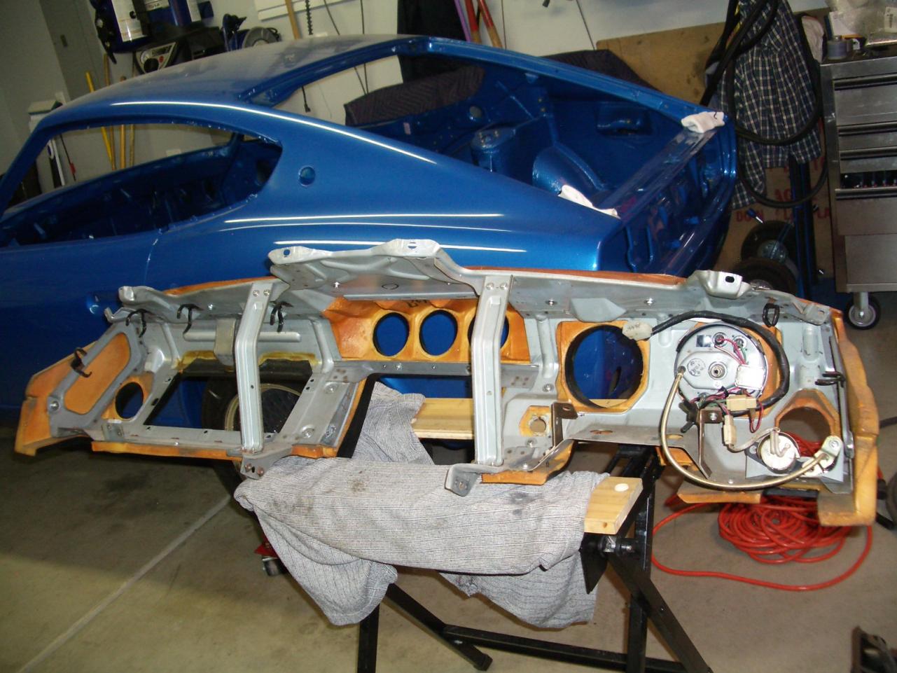

Spent some time on the dash tonight to prepare it for restoration. Wow it was NASTY back in there!! Not surprising considering the length of time between cleanings. I've got some serious cleaning to do as every single component, especially the air circulation hoses are just filthy dirty inside and out. You can see it one photo.. YIKES!! Here are the photos...

That is the way I fell about mine right now, but all it really needs is a good clean an buff. Except for the paint which is toast from Las Vegas sun.
I am the 2nd owner on title 78000mi, car was parked in 91 because it did not pass emissions in California. Every thing is very well preserved (rubber will all be replaced)

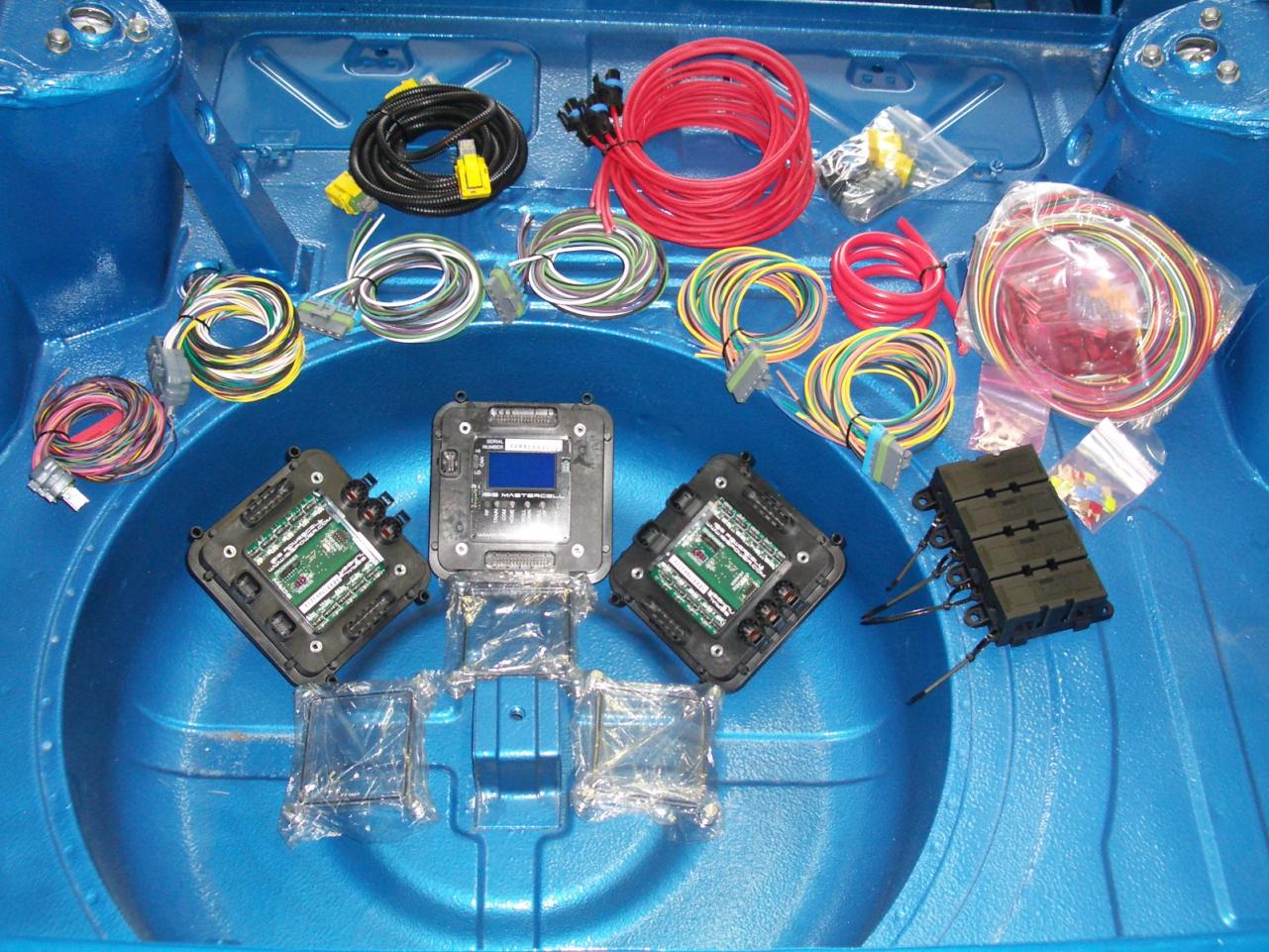

I decided to renew the wiring system of the 260Z after reading in another thread about a company called Isis Power.. I ordered the three cell kit in February. Received it while I was at work. Now I have my work cut out for me!!
Wish me luck!!

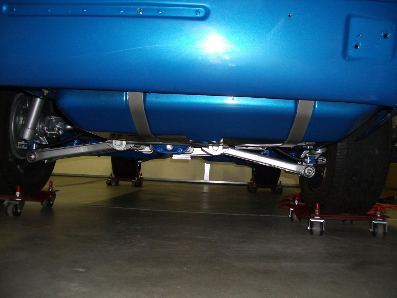

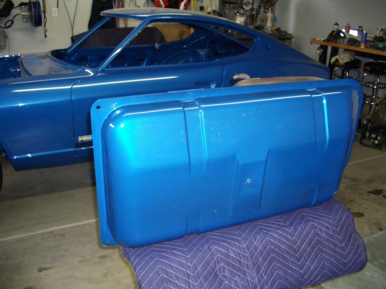

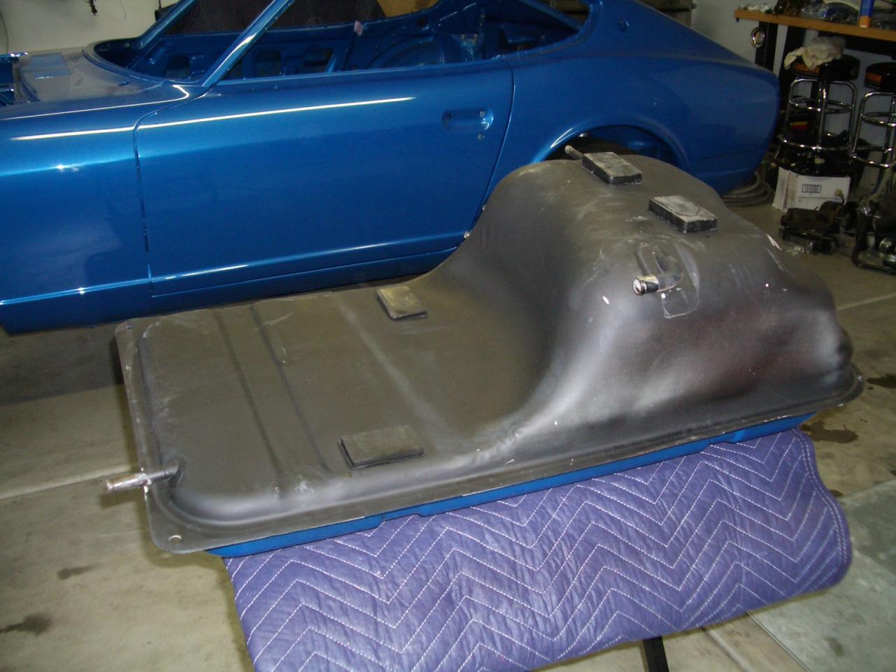

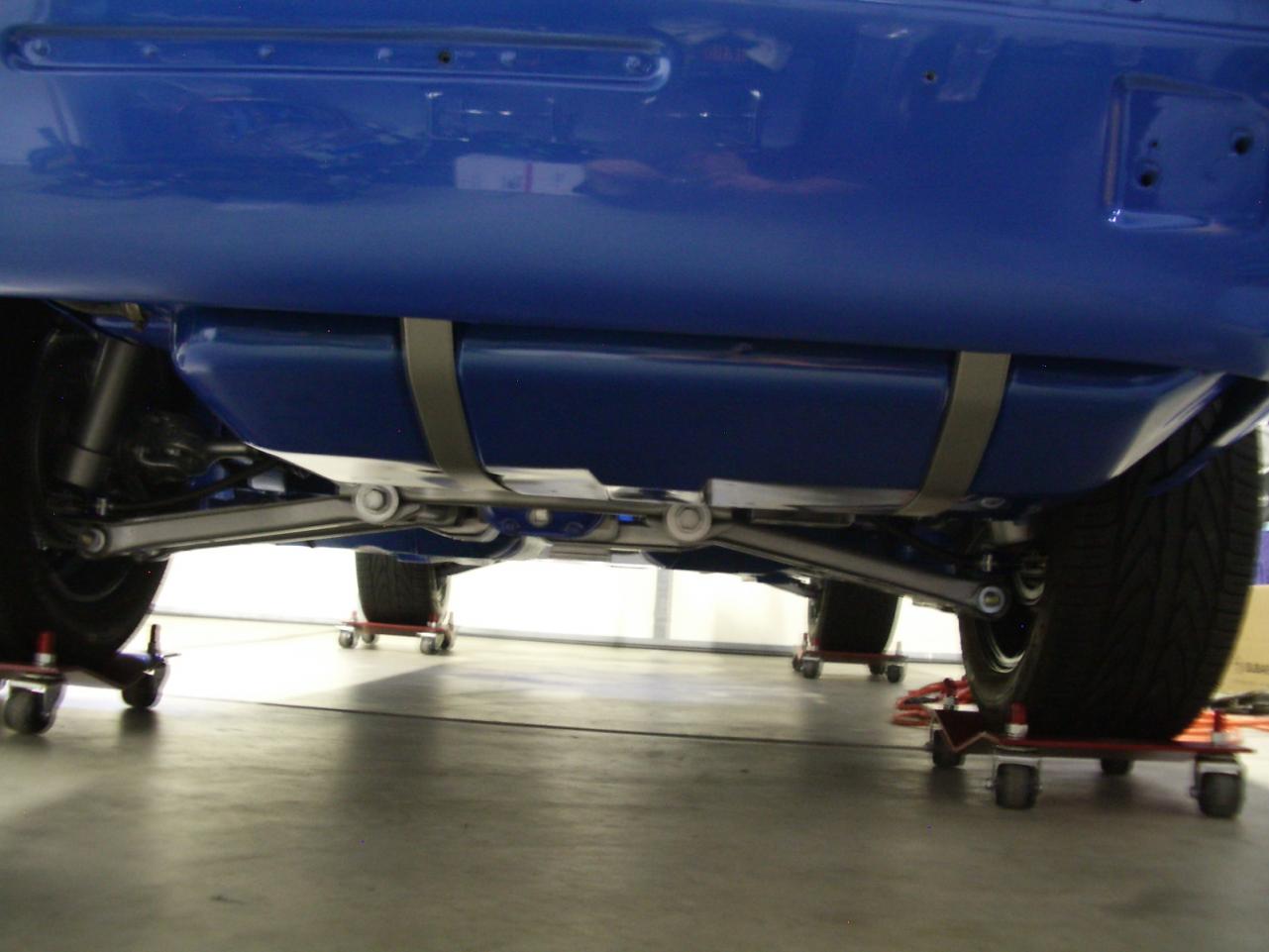

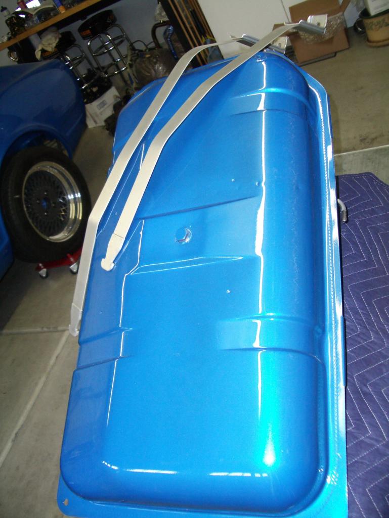

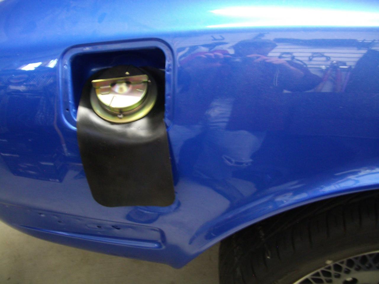

I haven't gotten much work done on the 260Z thanks to being away at work for the past month.. I'm back on US soil now and back under the 260Z.. Got the fuel tank installed today. The bottom of the tank is painted the same color as the car and the tank straps are powder coated silver to match the suspension components. Thanks to Dave Palermo for supplying the replated gas cap. Still need to plumb the tank to the hard fuel lines and paint and install the expansion tank. More photos to follow in the coming days.. Stay tuned!
