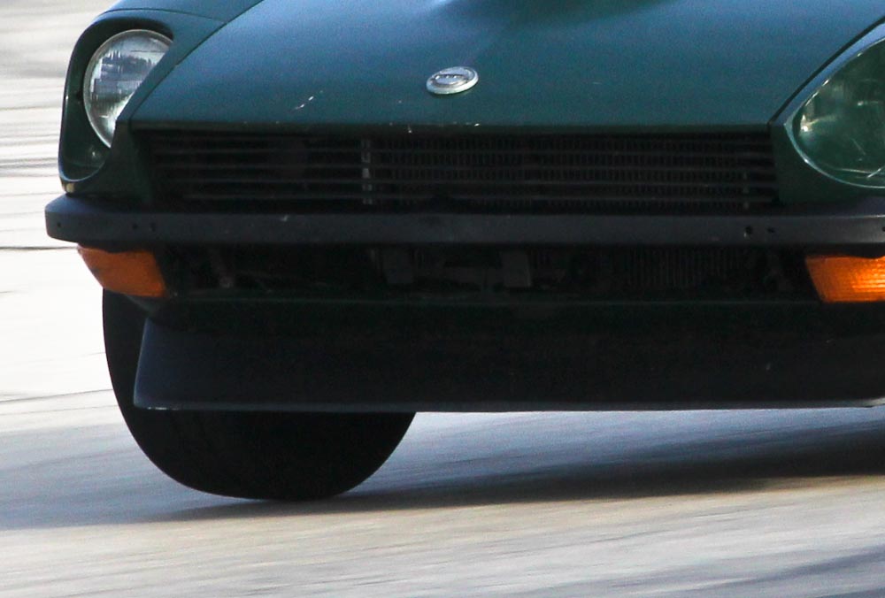

I noticed that my car tends to come very close to lifting the inside front wheel in a corner on the track.
I assume this is a symptom of something being off in my alignment or suspension geometry. Anyone dealt with this before in a 240Z?

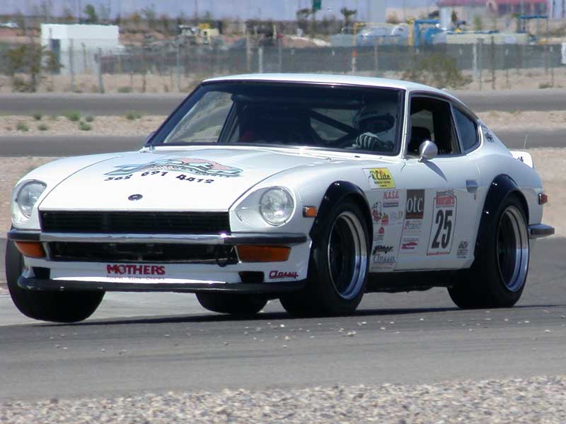

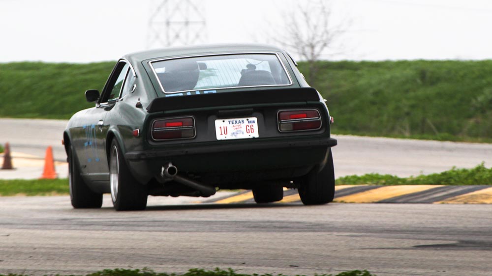

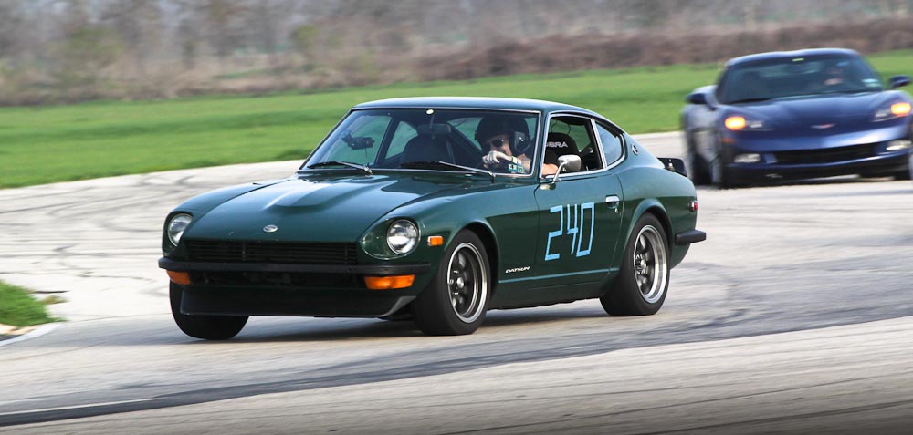

Looking at the pictures the balance seems about right. Maybe reduce rear roll stiffness a bit. With these cars you generally want the inside front tire very light in a corner. Helps with traction out of the corner.
