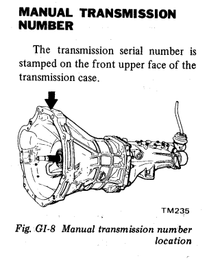

January 27, 201213 yr comment_378913 Link to comment https://www.classiczcars.com/forums/topic/42084-transmission-id-what-transmission-am-i-supposed-to-have/#findComment-378913 Share on other sites More sharing options...
January 27, 201213 yr comment_378916 Did not know that. I knew the numbers were useless for determining 4 or 5 speed, but didn't know they had date information. Thanks for the insight. Wish I had looked at mine before I installed it...Went out and looked at my ZX 5 speed (came out of a 1981 ZX but has 1980 ratios), easier to see than I thought, and it has 7409303. It's definitely a ZX body, with the speedo hold down bolt at 6 o'clock.Looked at the various transmissions I've collected (kind of embarrassing)"1980" 280ZX (above) - 7409303Original (as far as I can tell) 1976 280Z 4 speed - 71061461978 280Z 5 speed - 71289971983 280ZX (speedo bolt down) - 7X64820Blown up ZX 5 speed year unknown - 7X64845Edit - those really are Xs in the strings above, not illegible numbers. Just observations. So I'm back to not seeing any information in these numbers. Maybe Nissan stockpiled a boatload of bellhousings and the numbers show when they were made. Edited January 27, 201213 yr by Zed Head Link to comment https://www.classiczcars.com/forums/topic/42084-transmission-id-what-transmission-am-i-supposed-to-have/#findComment-378916 Share on other sites More sharing options...

January 28, 201213 yr Author comment_378989 Thanks for the additional info.So it seems that I'm relegated to circumstantial evidence...I've got a five speed in the car.A 5-Speed insignia came with (but not attached to) the car.I checked the serial number on my bell housing and the numbers are shallow and filled with paint, but there's no mistake that the first two numbers are "74" which, if the number stampings really do mean something, puts it at a mfg date of April 77 and that is the same as the build date of the car.Next time I have the car out of the garage, I'll check visually to see if I can verify that it is an early "wide ratio". Link to comment https://www.classiczcars.com/forums/topic/42084-transmission-id-what-transmission-am-i-supposed-to-have/#findComment-378989 Share on other sites More sharing options...
