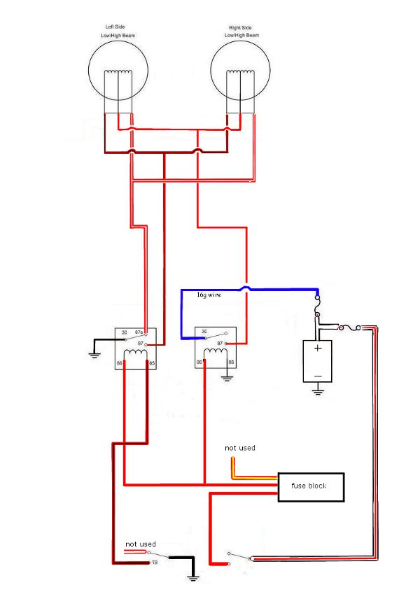

so, thinking about the wiring it looks like I might need to reverse the polarity of the headlight to make this work. Is there anything wrong with this approach a better solution or is this the way to go?
Looks like you might have found FW's post already but here it is again, just in case - http://www.classiczcars.com/forums/showthread.php?35588-Upgrade-from-fusible-links-to-circuit-breakers/page2&highlight=stinger+relay
There are different ways to use relays to take the loads off of the switches. In addition to FW's method and Dave's harnesses, you could also use three relays in the cabin by the fuse box, one for power to the 10A fuses, and two to ground the circuits coming back to the dimmer switch.

Really why would I do a half assed job trying to improve what works already. The reasons I am doing this is to improve the headlight brightness and to take the load off of combination switches that I just replaced. ( I don't whant my new ones burned up). But I know what you mean I have fixed all of the PO's hack jobs and I do not intend on going back to what I started with. So thanks for helping with a relay choice. :ermm:
