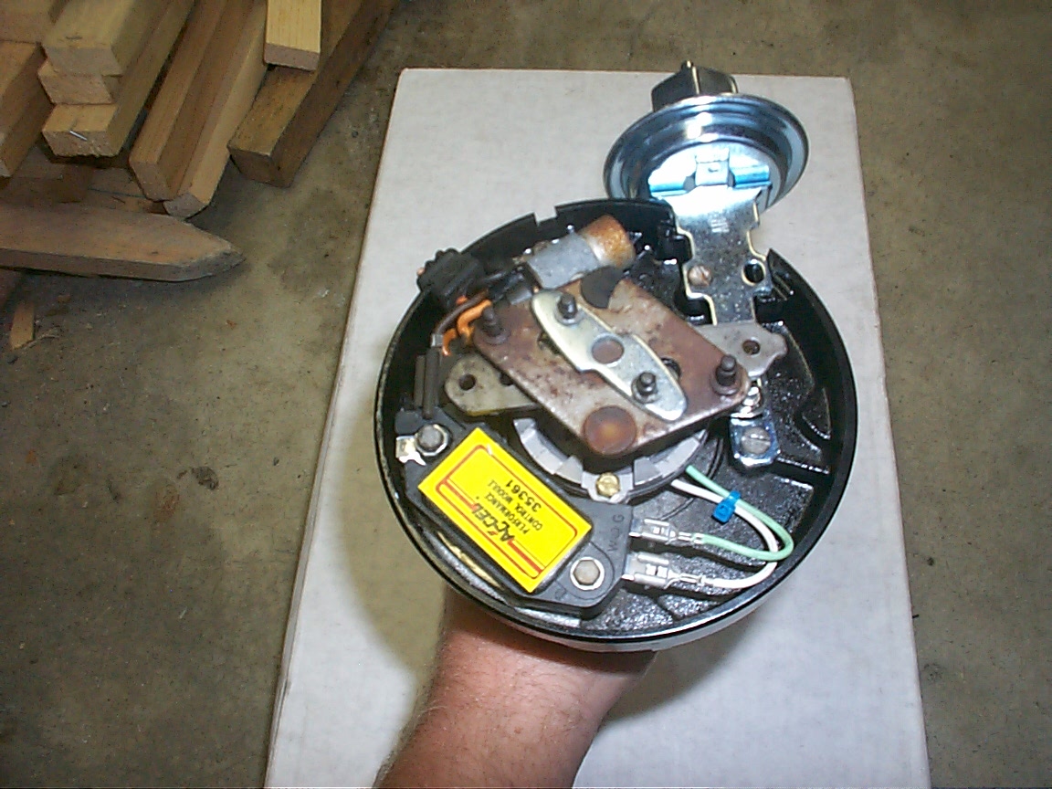

FWIW, I used one of those modules on a 510 I owned. I actually got the module from the junkyard and used it to convert the later model distributor for use on my last 510. My intent was to replace the used module with a new one after I got it all set up. I never did. It worked fine for the 5+ years I owned that car.
Edited by sblake01
I think the electronics in those modules is pretty generic. I remember reading a Motorola linear parts manual that actually gave the specs of the detail part. Applications listed were auto ignition, obviously. Moto makes a lot of this stuff for oems. So I think many of the mfgs just used that small piece of silicon inside their own package. I've used the Nissan and a GM version with no apparent difference. I think that I will move mine off the dizzy and put a heat sink on it. That's a pretty hot location on that dizzy that must lead to higher failure rates. I have had the Nissan fail in the typical manner intermittent. Interestingly, the symptoms are similar to that experienced when the bearing at the bottom of the dizzy gets worn. Totally different thing, but similar symptoms.
Just in case you're wondering where the module is located and why it has that shape, it's inside the distrubutor.
Since the module is attached to the distributors base plate, it makes you wonder why we're making a big thing about heatsinks? A simple sheet metal base on the fender by the coil should give the module enough cooling air. IMO, protecting it from water would be more important.
