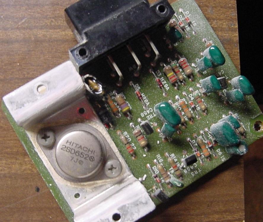

Mine looks like some water got in the box as well.  I should test the power transistor to see if it's still good-  I suspect it's degraded or just dead.  If that's the case, I'd say the wiper amp suffers from the same problem, which wold explain the slow wipers.  Then I'd take a look inside to see if you could build a better one with modern parts.
BTW-  where can you get a NEW wiper amp unit?
Edited by TomoHawk
That doesn't look like it got wet to me. Just looks like old non-sealed electronics IMHO. And if it's dead, I wouldn't bother trying to troubleshoot. They're easy enough to find used still working, and failing that, there are aftermarket options.
How's this for a litmus test... Even I wouldn't spend a lot of time trying to fix one of those.   LOL
