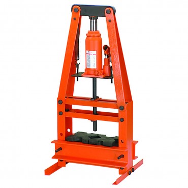

In order to rebuild tranny, I'm thinking about buying shop press.
http://datsunzgarage.com/borg/
Datsun ZCARS mentioned 12tons press, but I was wondering 6 ton is good enough for it.
http://www.harborfreight.com/6-ton-a-frame-bench-shop-press-1666.html
I don't want more bigger tool occupied my garage.
Does anyone use this tool?
Thanks,
I have that press in my garage. I've used it to do u joints, hub bearings, and various small to medium duty jobs but I'd want something larger for a transmission. Fortunately, my son has the 12 ton press.

I thought I need shop press when pull a part from the largest shaft. It's around 14:53 on the video.
Looks like I don't need shop press.
Rebuild
Good videos! Wish there were some audio commentary explaining what is being done, but otherwise good. These should be linked/saved for future access by others doing their own rebuild. I have done a couple rebuilds without using a press, but if you have access to one, it makes life easier. If you have a few pieces of pipe, etc, some patience, ingenuity, and time, you can do it yourself. The last one I did, I bought the rebuild kit with bearings, synchros, gaskets, etc for about $150 from Autozone, and knocked it out in a weekend.
