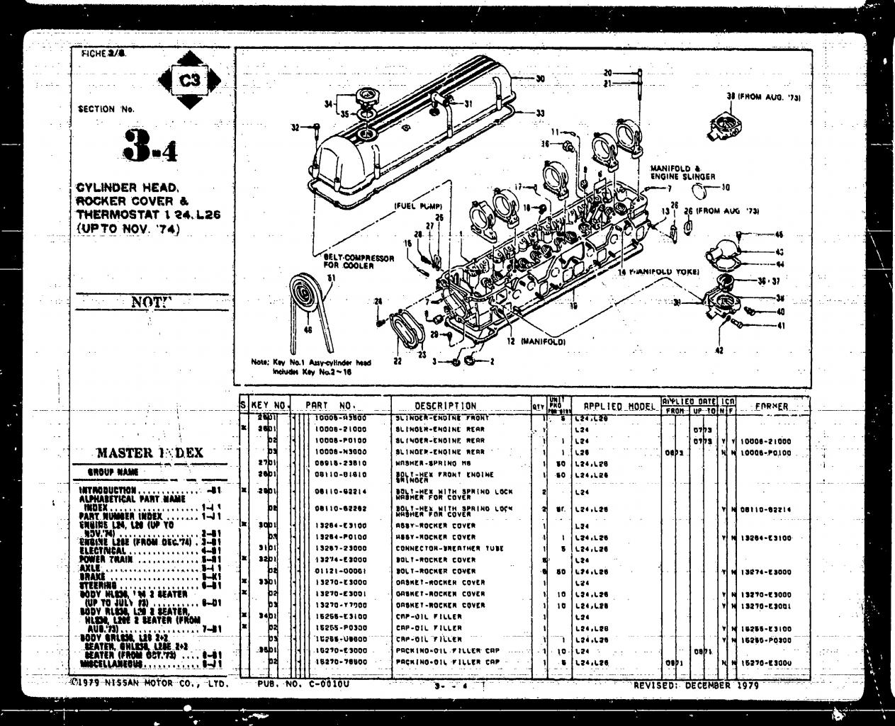

I have a snapped off valve cover bolt. Before removing the valve cover and extracting it I would like a new set.
So I am looking for the part number, I would like OEM bolts. After some online searching I came up with 13274-E3000, is this correct? I would like to know before ordering from courtesyparts.

I got a different number at the good old carpartsmanual site - http://www.carpartsmanual.com/datsunS30/DatsunZIndex/Engine280Z/CylinderHead/tabid/1600/Default.aspx
Shows as available at $3.66 at Courtesy Nissan.

Thanks for the part number and the web link. I was looking at the xenon site's part fiche wich is dificult to read. there are two different part numbers listed, the first I posted and the second I read as 01121-00001 but the last 0 must be a 6! thanks.

So new bolts are on order. Thanks for the part number and the offer (I will keep my spares for the future).
