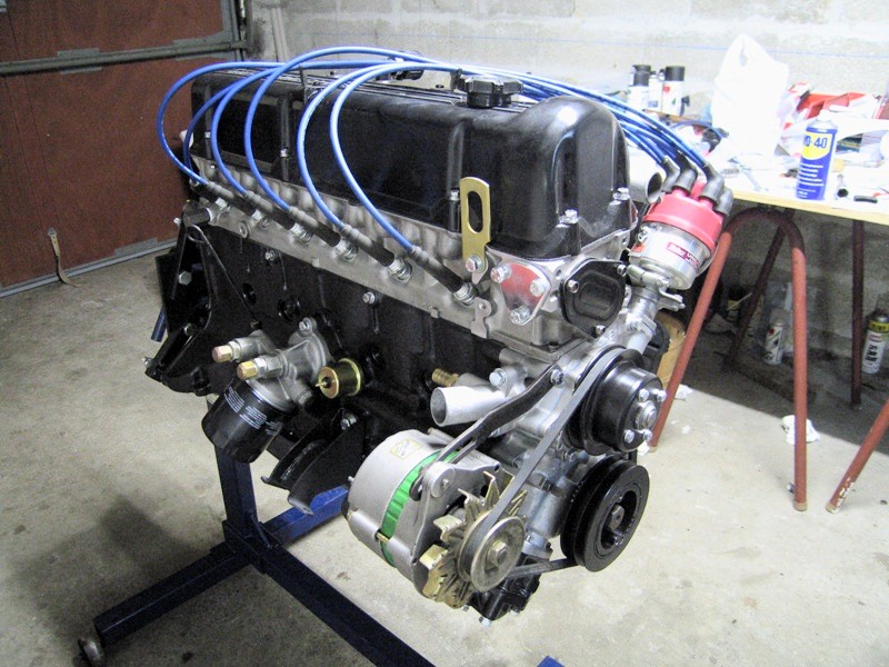

March 2, 201213 yr comment_382715 It's off topic a little but I'll answer anyway Engine failure was not related to Glenn either The car is doing good (soon to be back on the roads, target is spring), Glenn is following up btw; we exchanged emails no later than last week. I've redone the full suspension setup since then (sanded/painted, poly bushings, brakes, brake lines, bolts, top mounts, bearings, etc.), steering also and this winter the whole engine. (for the exprienced users, hook for the hoist is the wrong one, engine mounts are reversed - I've corrected it since then) The only thing I've removed from before was the head (too much compression with ping & dieseling) & the wheels. And if you'd like to follow the build, here's the link (it's in French but there're pictures) I was really close to buying it back from Glenn, but there were too many little things he did that I didn't like. I think you felt the same way and it is now perfect. I would most likely never get a Z if you would have bought it back since Z's in France are expensive cars, especially in this shape Edited March 2, 201213 yr by Lazeum Link to comment https://www.classiczcars.com/forums/topic/42433-need-new-oil-pump-recommendations/?&page=2#findComment-382715 Share on other sites More sharing options...
