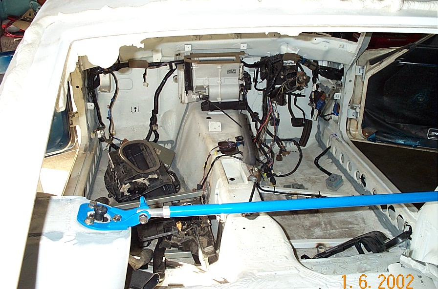

I have done all the mods as far as x-member, engine & gearbox mounts go & I must say it's quite a difficult job to fabricate the engine mounts to make the engine sit back as far as possible.
After trial fitting was done you can see all of the x-member & then some. If you ever need to work on the engine, you can actually stand inside the engine bay & work on it so you don't get those nasty elbow dents on you're fenders.

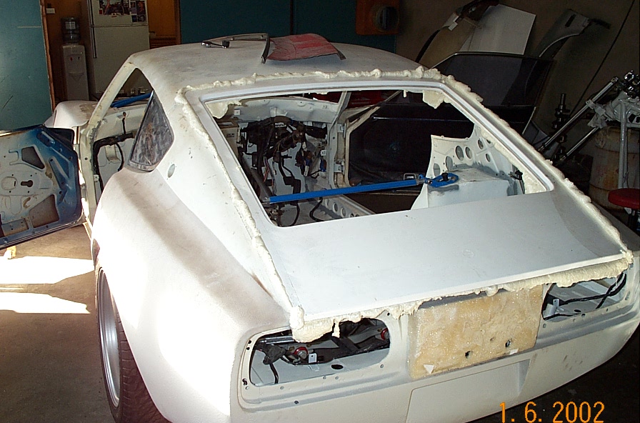

I was wondering the same thing until I started looking a little closer at all the neat fiberglass panels on the car, have to bet the hatch is fiberglass too. Doesn't explain the "foam", unless it's just being used as a shim for final fitting or are you molding the hatch in too?
I noticed the rain gutter is gone Nick, how hard was that to re-weld?
I like the flares, shame we can't get decent flares(full quarters) here in the US anymore. I also like the rear panel, is that all fiberglass?

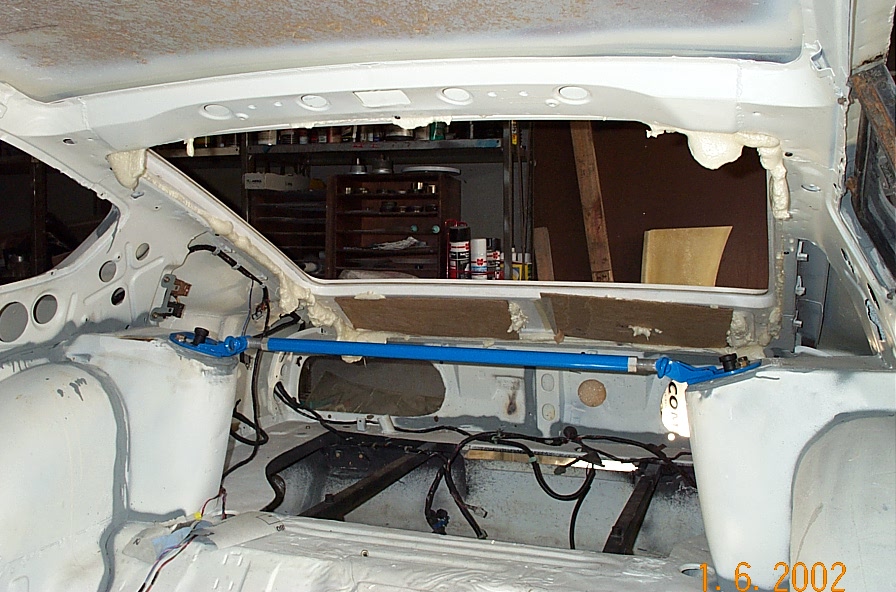

The foam is a filler used to delete the hatch ( I don't need it, not a golfer & don't carry dead bodies). Yes the hatch is f/glass which was fastened into position & then the gap was filled in & is now f/glassed over. I actually used the foam filler to make the rear guards. For strength I have retained the original steel panels but have cut the inner & outer wheel arch up about 3 inches & butt welded the 2 together so as to get clearance for the 275 40 17 tyres. Then I used the foam to get the desired shape (a reduced IMSA, GTU look).
Once the correct shape was attained, I started laying on 1 layer of glass matting, 1 layer of carbon/kevlar, & 2 layers of woven glass matting, (very messy & time consuming). The same will be done to the front.
As for the gutters, nothing is easy when modifying a car, & you should know that I'm going for the frameless door look as well.
The rear panel is all steel & as you've probably noticed, the # plate will be fitted in the new position.
Here's a couple more pics.
Nick.

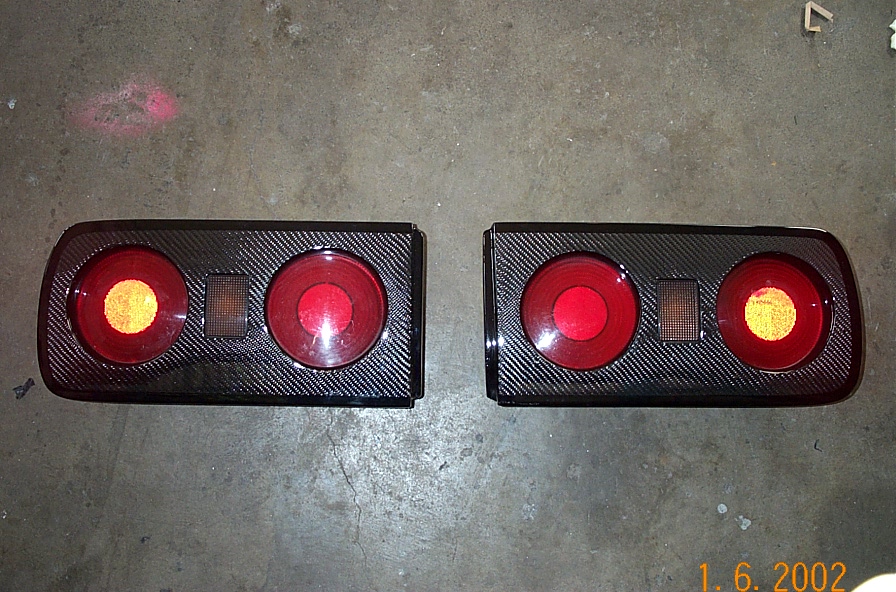

I used the Nissan Skyline GTR lens assemblies & made complete new covers using the foam, fibregalss, & carbon.
Once again, took forever to make.
