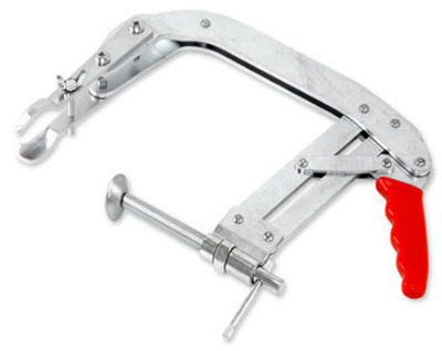

Posted March 12, 201213 yr comment_383829 Hi, I'm about to rebuild header. I need to purchase valve spring compressor. There are several different type of valve spring compressor in the market. Does all of them works for L28 header? There are 8" and 10" one. Which one works? Thanks, Tamo3 Link to comment https://www.classiczcars.com/forums/topic/42591-tool-question-valve-spring-compressor/ Share on other sites More sharing options...
March 12, 201213 yr comment_383832 I've used this type with the head off. Link to comment https://www.classiczcars.com/forums/topic/42591-tool-question-valve-spring-compressor/#findComment-383832 Share on other sites More sharing options...

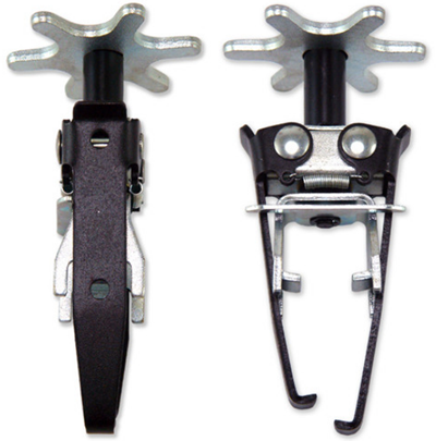

March 12, 201213 yr comment_383845 To do the job with the head on, use the KD 3087 valve spring compressor. I also use the same one when the head is off. I simply bolt the head down to my workbench. Edited March 12, 201213 yr by Jeff G 78 Link to comment https://www.classiczcars.com/forums/topic/42591-tool-question-valve-spring-compressor/#findComment-383845 Share on other sites More sharing options...
March 12, 201213 yr comment_383863 To do the job with the head on, use the KD 3087 valve spring compressor. That's the ticket...!!Carl B. Link to comment https://www.classiczcars.com/forums/topic/42591-tool-question-valve-spring-compressor/#findComment-383863 Share on other sites More sharing options...
March 14, 201213 yr Author comment_383990 Thank you for your feedback. KD 3087 seems expensive and not commonly find at store. I will get Blue's recommended one.Thanks,tamo3 Link to comment https://www.classiczcars.com/forums/topic/42591-tool-question-valve-spring-compressor/#findComment-383990 Share on other sites More sharing options...
March 14, 201213 yr comment_383991 I've used both many times and the C clamp style works fine if the head is off already, but you will be sorry if you ever need to replace valve seals or decide to add performance springs and a cam. Pulling the head isn't fun and you'll pay for the KD3087 with one new head gasket. I found mine at Tooltopia.com pretty cheap. Link to comment https://www.classiczcars.com/forums/topic/42591-tool-question-valve-spring-compressor/#findComment-383991 Share on other sites More sharing options...
