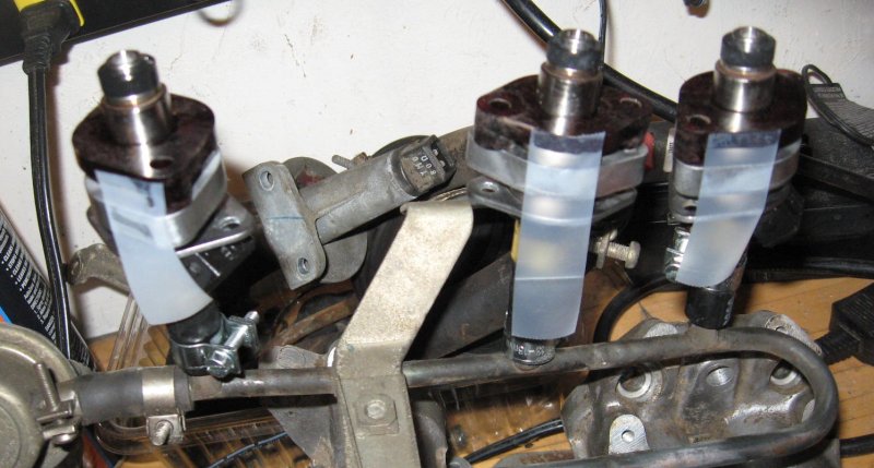

Glad it was of help to someone. A couple of things I did not mention... I coated each of the o-rings with a tiny bit of motor oil, just like I do an oil filter before installation. I installed the injectors onto the rail before I screwed them into the manifold. This worked well except that the thick plastic spacer (which is not shown in the datsun diagram BTW) wants to fall off when you flip the whole thing over to install onto the manifold. I got past this by using a piece of tape to hold them until I they were seated, like so:
