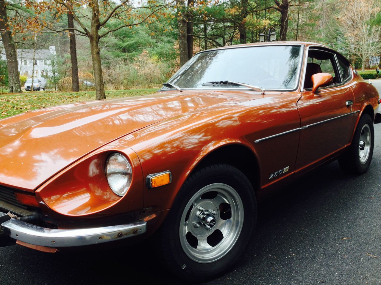

This thread is kind of old but its a good place to pick things up again. Since I last posted, I had to work through some other problems covered in other threads (vacuum leak through bcdd, bad ignition module, bad AFM). All taken care of now.
Summary: 1976 280Z bought about two years ago, had to trailer it home with the fuel injection in the back hatch. No exhaust (not even a manifold). Body in great shape though.
Here's a summary of what has been done... I'm sure I'm missing something.
  • New (rebuilt) AFM
  • New (rebuilt) ZX distributor/ignition module
  • BCDD vacuum leak repair
  • Bad Dog frame rail kit
  • New (well, used) Slot Mags and Tires
  • 240Z front bumper (still needs some work)
  • New Coil
  • All (7) new injectors (Standard brand FJ707T) and throttle body cleaning.
  • New vacuum hoses.
  • New MSA coated header and exhaust
  • All new brakes (drums, shoes, cylinders in back, calipers, pads in front. New master cylinder)
  • New Clutch, slave cylinder, boot
  • Wires, plugs, cap were new via previous owner.
  • Fuel pump new via previous owner.
  • New fuel filter. Oil Change. Plugs. Etc.
  • Lots of other misc small stuff.
I did everything myself except install the frame rail kit. The guy that did the welding for me went over it from end to end and said it was in great shape.
Anyway, the news is: My Z is on the road! Runs great! It goes like mad. I have not taken it over 5000RPM yet but it gets to 5000 in the blink of an eye. All of the old problems seem to be gone (no cut outs, tachometer is perfect - not jumpy any more). I still have some roughness when its cold but after a minute or two its smooth.
A while back I replaced the aux air intake with a ball valve which I open about half way when I first start it then shut it off after a minute or two depending on the outside temp. I may try the original aux air again now that other issues have been solved.
BCDD is still disconnected. Temp gauge is not working (neither is the clock). I still have to put the interior back together - I had stripped it before brining it in for welding. Should get that all done this weekend. I'm going to flush the cooling system this weekend in hopes of getting the heat working. Need to work on the bumpers. Get a nice old aftermarket stereo in it. Etc...
Thanks again to everyone on this list who has helped me along the way.
Dan
Edited by sscanf

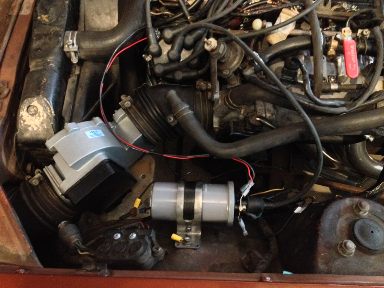

Yep, I put in a rebuilt 1979 280ZX distributor from Rock Auto ($90 AND it comes with the ignition module!). Fixed lots of problems, including my jumpy tach.

Sorry for asking, but why the 79 280ZX distributor and not on for a 76? Any details on the install? I have a 75 that I am thinking about replacing the distributor on so this is relevant to me.
For me, it was mostly because the previous owner had already done the ZX distributor upgrade (but the used replacement was misbehaving causing a jumpy tach and cut outs). It turns out that its a very easy upgrade to do (details here ). I think the original motivation for doing the upgrade is the improved electronic ignition module in this unit. You will also have to replace the coil along with it (about $12 at Rock Auto). Look at that link for details (especially the "this is what it becomes" diagram to get an idea of how simple the wiring is) but, in a nutshell, it goes like this:
  1. Disconnect the old ignition module (which is located in the passenger compartment)
  2. Swap in the ZX distributor (and mount! you might have to get this from a junk yard) and coil
  3. Do some simple rewiring between the distributor and coil (toss the old ballast resistor)
  4. Profit!
I think that sscanf is right, the technology of the system was improved by 1979. The ballast resistor is gone, for example, so more current through the coil for a better spark. Plus, the cost of just the old technology module is more than the newer module and distributor combined.
Same topic though - you could keep your old distributor and wire in a GM HEI module and GM HEI coil for less money (~$25 total) than either for probably equivalent technology. But if you need a distributor, you might as well go with the ZX system. The ZX way is easier to wire in also.
