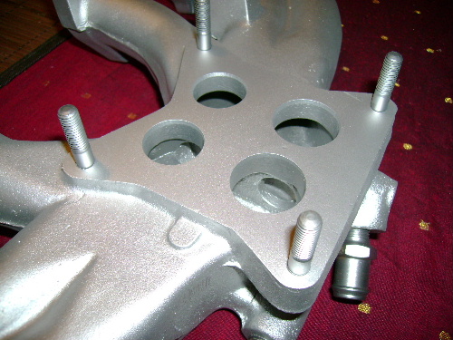

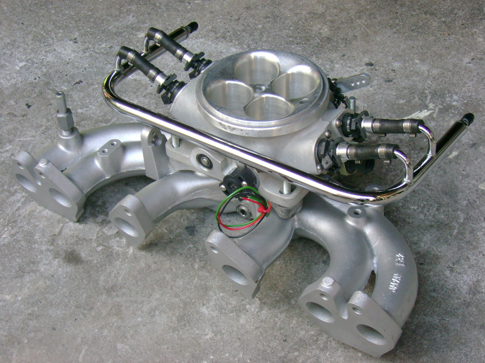

I thank all of you for your input specially ozconnection for the all the information, its steering me in the right direction. I'm definitely going to do lots more homework on 4bbl to get the tuning just right. I really want to stick with the 4 bbl carburetor since I'm already knee deep in the project . By the way ozconnection, who makes the E32 manifold and with throttle body injection? Thanks again guys.
Genuine Nissan E32 intake manifold. You can't just go and buy one of those E32 manifolds, it took me quite a few years to find one AND at the right price. That injection throttle body (with megasquirt) is for a future project I have in mind for my coupe. You can buy those on ebay. Cheers.
