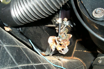

Posted January 14, 200322 yr comment_23211 Found this under the passenger dash... rusty and leaking something. Heater control? Any clues what it is? Link to comment https://www.classiczcars.com/forums/topic/4265-what-the-heck-is-this/ Share on other sites More sharing options...
January 14, 200322 yr comment_23215 yeap,heater control valve.Might as well replace those two hoses while your in there.Use factory preform hoses.Anything else just causes grief.While your coolant is drained might aswell replace the radiator hoses,maybe even thermostat as well.Put the old rad. hoses under your spare tire and you will never need one again.It's the parts you dont have that leave you on the roadside!!:stupid: That coolant will eat any carpet or clothes it touches. Daniel Link to comment https://www.classiczcars.com/forums/topic/4265-what-the-heck-is-this/#findComment-23215 Share on other sites More sharing options...
January 14, 200322 yr comment_23219 Derk,You will want to cut the hose from the heater core.If you try to twist it loose you can break the heater core.That is when uglyfest begins!! Daniel Link to comment https://www.classiczcars.com/forums/topic/4265-what-the-heck-is-this/#findComment-23219 Share on other sites More sharing options...
