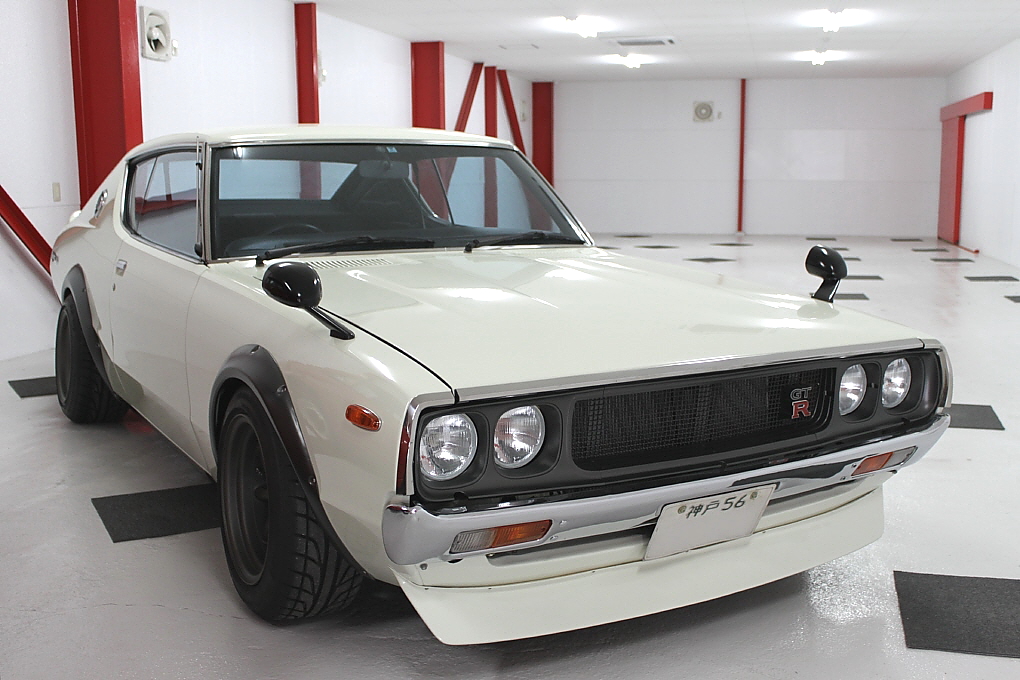

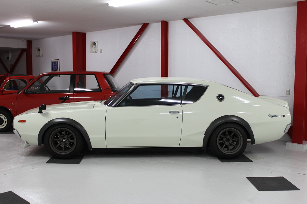

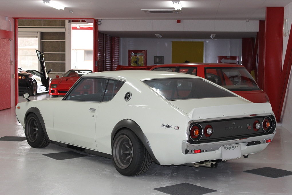

April 1, 201213 yr Author comment_385943 Yeah it was a tough choice between silver and white but I think white has won out, my Father likes white too. I'm going for the full classic factory look and some nice deep dish Watanabe's with a silver polished lip. It will pretty much be a clone of this I'm hoping. I hear you with the house etc, I bought a place about 2 years ago and part of a business before that so it's hard to find the time and money! The tail light insides were done here in Melbourne at Vinny's in Dandenong. I was told it's not chrome, it's another type of reflective finish. I'm not sure what though. Not sure on price sorry as it was done with some other stuff. I 'think' it was around 30 or so per piece? Don't quote me though sorry. http://www.vinneys.com.au Edited April 1, 201213 yr by Adzmax Link to comment https://www.classiczcars.com/forums/topic/42788-1975-c110-khgc110-240k-build/?&page=2#findComment-385943 Share on other sites More sharing options...

April 14, 201213 yr comment_387102 WoW - Thats going to be a new car once you have finished. I'm green with envy. Inspiration: Link to comment https://www.classiczcars.com/forums/topic/42788-1975-c110-khgc110-240k-build/?&page=2#findComment-387102 Share on other sites More sharing options...
April 17, 201213 yr Author comment_387345 This is my inspiration Yeah I'm a self confessed perfectionist. It's a blessing and a curse! Link to comment https://www.classiczcars.com/forums/topic/42788-1975-c110-khgc110-240k-build/?&page=2#findComment-387345 Share on other sites More sharing options...
