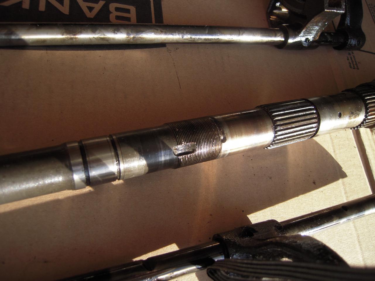

They pointed out a few items that were damaged. The first was this shaft that has a scored, worn spot where a ball engages the shaft.

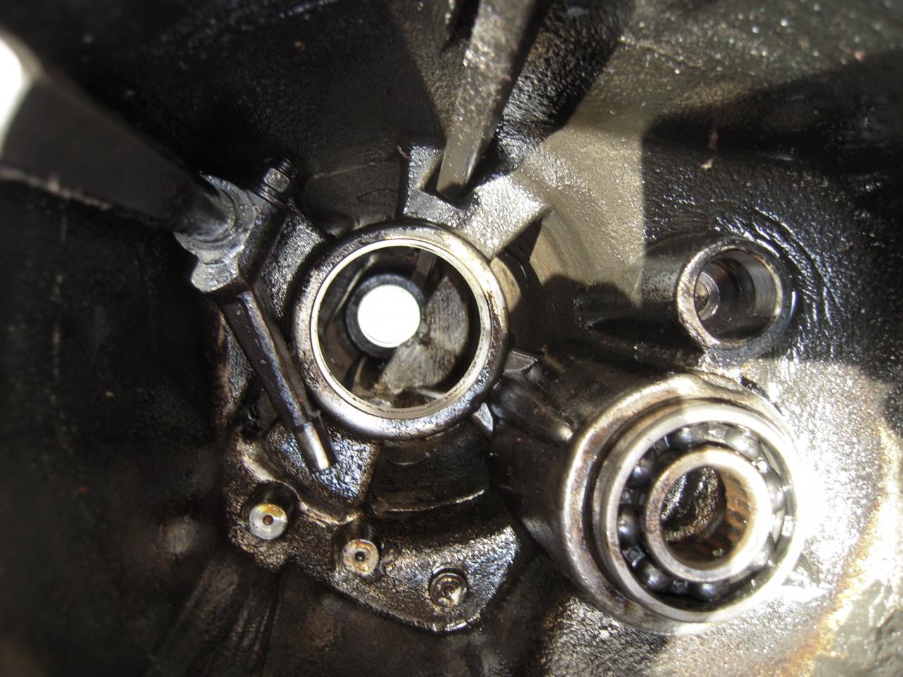

They also said this bearing was stuck and there was a shiny worn spot next to it.

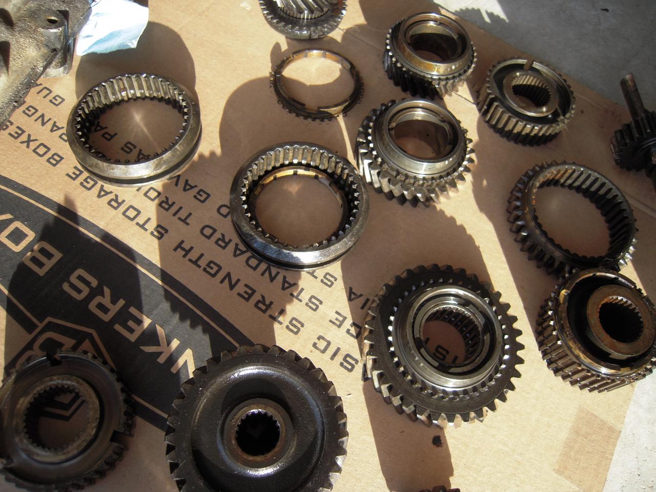

Here is one more shot, I honestly could not see anything that was damaged.

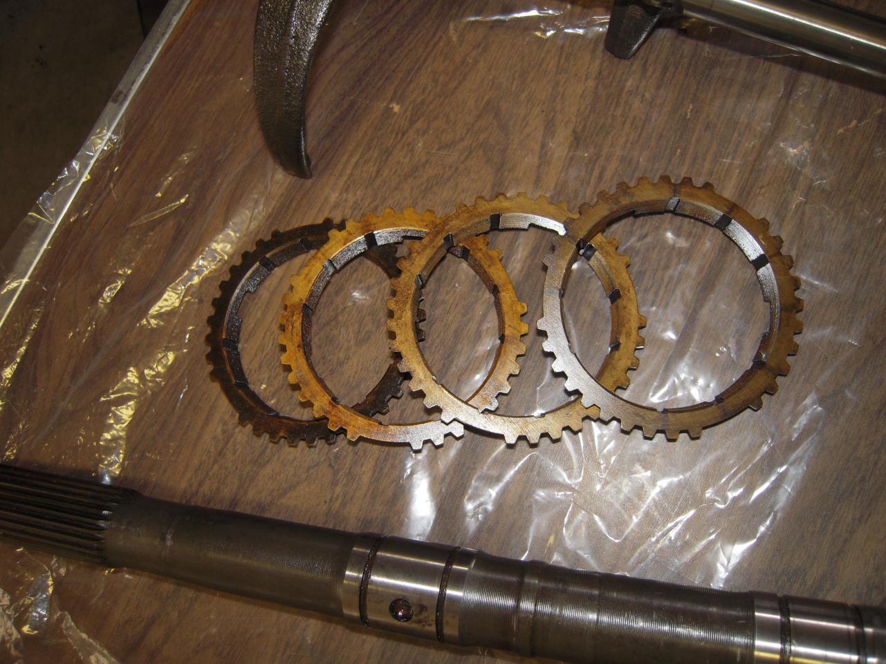

Take a shot of the pointy parts of the teeth on the bronze colored thin gears (synchros), edge on. And try to keep the synchros with the gear that they were on. They should stay matched if possible. I hope the shop didn't just toss everything in a box.
Also, if you could take a shot of the conical shiny portion on the side of the gear (upper right in the bottom picture) it looks like there might be some surface rust there. I have an old transmission in my car, and it took a few hundred or more miles before the synchros worked right. I had a theory that the synchro cones had rusted, taking time to wear back in, and you might have some evidence to confirm that it happens.
I don't see any dramatic damage. The bearings can stick on the inner race (shaft) or the outer race (housing), it's not uncommon.
You have to measure the the synchros. That's about all that wears out besides bearings. If you don't see chunks missing from any gears they are probably fine.

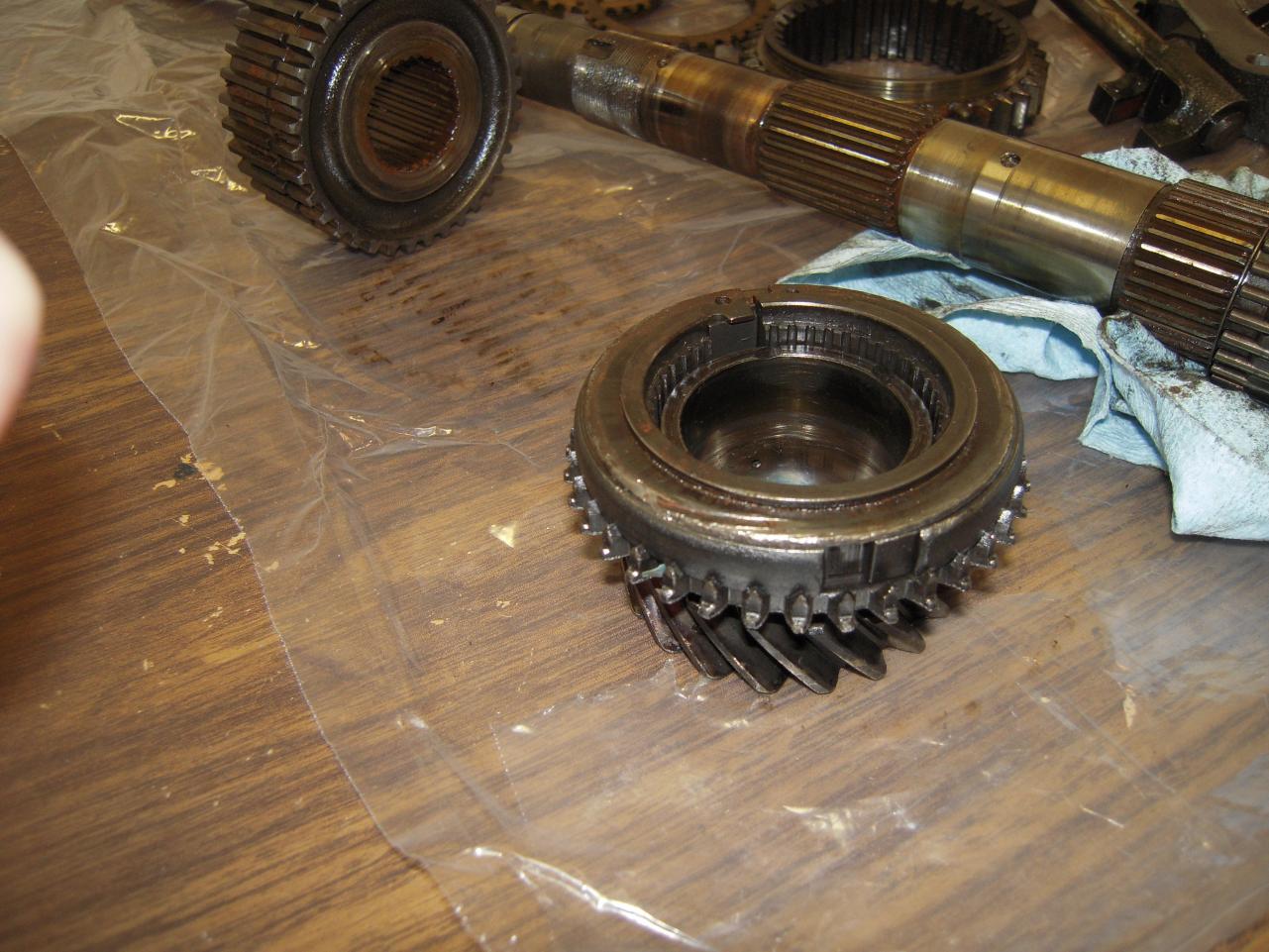

I carefully examined each piece of the puzzle and here are the three items that looked like they could be issues:
The above looks kind of worn.
There is some rust in between the teeth of the gear. The shaft has a scored mark that the shop said was bad.
I can measure the sychro rings, if that is what the following is:

The dog teeth (the pointy triangle shaped things sticking out from the side of the gear) on that gear in the first picture do look worn. The tops of the triangles should be sharp, not rounded. They look abused.
And the rust isn't good, that's actually a splined piece that has a matching splined collar that slides back and forth over it. The collar needs to slide easily over that area. The inside of the collar is probably rusted also. It would probably wear off over time, but might be stiff shifting for a while.
