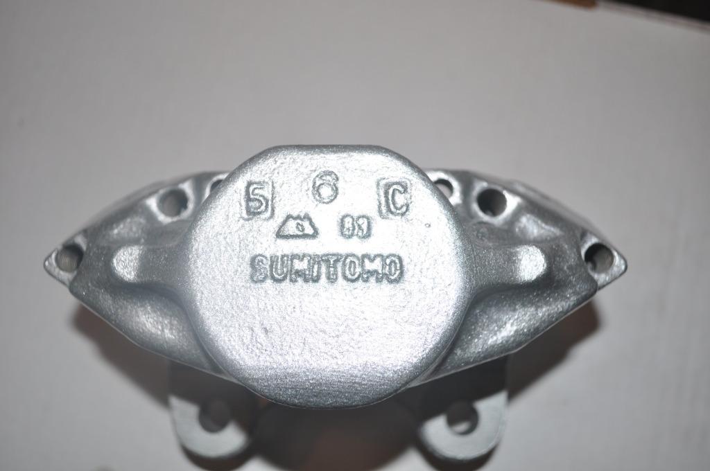

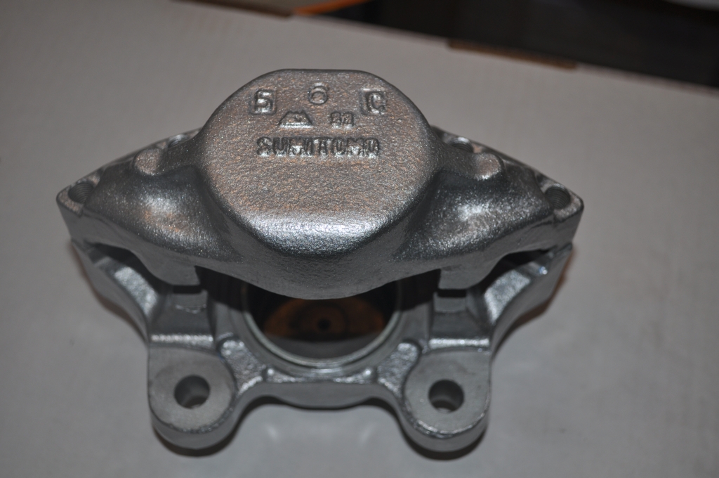

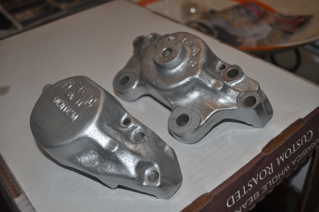

April 4, 201213 yr comment_386264 I used a product from G2 recently. It is made for calipers. You can see more info about them here: http://www.g2usa.com/ I went with a silver color and mine came out great. My only issue is that you cannot see them through my wheels like you can on more modern cars with modern wheels. Here's a few pictures of the G2 product on my calipers. Mike. Link to comment https://www.classiczcars.com/forums/topic/42828-coating-brake-calipers-and-rotorsdrums/#findComment-386264 Share on other sites More sharing options...
