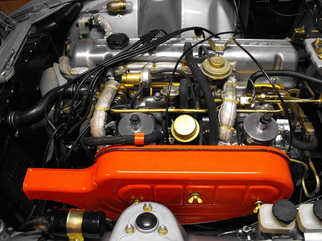

Hi,
Thanks for the quick reply. I too am confused on why it would need upholstery. He sent me pictures of the original title, and says he has other service documents but the interior definitly does not look low mileage and is pretty dirty (given it is the beige interior option). Either the car was not taken car of early in life, the mileage is really 130k or maybe was not stored properly. Surprisingly the dash does look to be in good shape.
Here are some pictures.
I am going to go over the entire car for rust. I really appreciate everyones advice on how to inspect the car!
Edited by Z-man
Wow, nice looking car! Love the flattops as they are the correct carb for that year. In spite of what others here may tell you here (usually those who have never owned a Z with flattops), they run pretty well when cleaned up. Since it idles but doesn’t run well, I am guessing that the little accelerator pump on the side of the carbs should be looked at and replaced. Could also be old fuel so you will need to clean out the entire fuel system. I had gas ‘globs’ in my flat tops when first purchased. Car ran great once I cleaned them out.
The color combo is very cool. Looks like the back panel around the tail lights has been re-painted which makes me wonder what else has been redone. I would keep it as original as possible. For every dollar you use to modify the car, you can deduct that from the current worth of the car. Car can be worth anywhere from $4K to $10K dependent upon rust, previous repairs and other items that are not visible in the pics.
