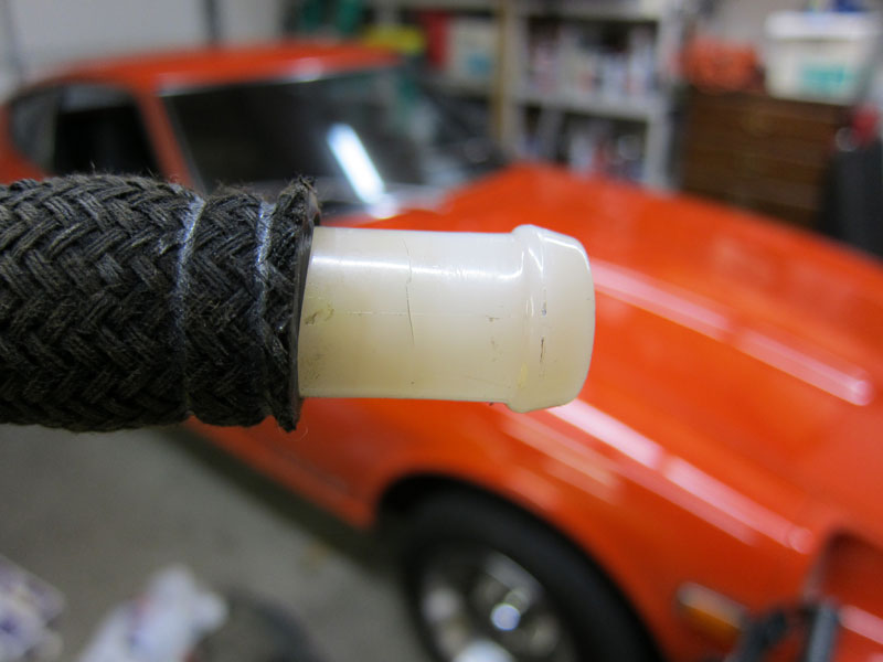

Posted April 6, 201213 yr comment_386500 I don't know if this has been mentioned before but since I've now run into it on 2 Z's I figured I'd post it. On the first Z I had I chased down everything looking for the cause and didn't find it until well after replacing the tank vent hoses (should have noticed it when I replaced them). This time I knew what to look for when replacing the hoses. On my 73s on the short hose that goes from the main filler hose to the canister just above it there is a little plastic fitting that the hose goes over and then the fitting goes inside the filler hose. You can see the opening for it when you remove the gas cap. That plastic fitting likes to crack and the crack is just enough of an opening to vent fuel fumes to inside the car. It also seems to like to crack just to the side so it is somewhat hidden. I probably should have gotten a picture of where it goes in the car but after replacing the interior panel the first time and discovering that I'd forgotten a screw from the vent tank and then replacing it again after that and forgetting to get the front of it pushed under the other panel I decided I'd had it off enough for one evening Trevor http://240z.me Edited April 6, 201213 yr by ta240 Link to comment https://www.classiczcars.com/forums/topic/42868-1-cause-of-gas-fumes/ Share on other sites More sharing options...
July 11, 201212 yr comment_395460 Did you find a source to replace the plastic fitting? Link to comment https://www.classiczcars.com/forums/topic/42868-1-cause-of-gas-fumes/#findComment-395460 Share on other sites More sharing options...
July 11, 201212 yr Author comment_395461 Did you find a source to replace the plastic fitting?I just used a threaded brass plumbing fitting. The threads seemed to grab the hose pretty well and I never had anymore problem. Link to comment https://www.classiczcars.com/forums/topic/42868-1-cause-of-gas-fumes/#findComment-395461 Share on other sites More sharing options...
July 11, 201212 yr comment_395465 Thanks for the quick response. Mine broke in half and it is just clamped onto the remaining length; not very secure! Link to comment https://www.classiczcars.com/forums/topic/42868-1-cause-of-gas-fumes/#findComment-395465 Share on other sites More sharing options...
