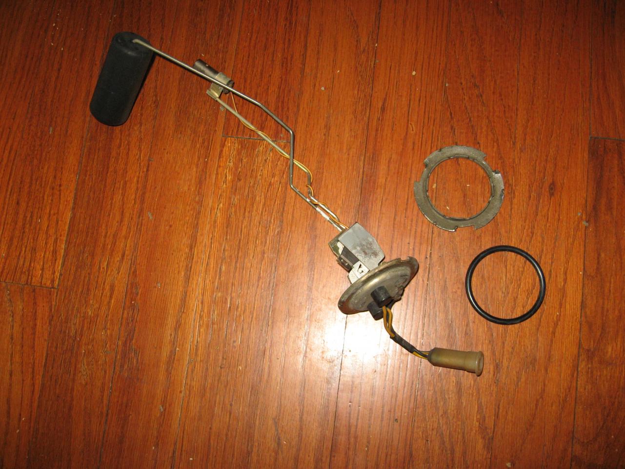

PM me and I can arrange to send it to you. But first off are you sure you're sending unit is shot? The spare I have has been tested and works. regarding your tank, it still may be salvageable. You would get more advice if you could send pics. try aiming a camera down the filler hole.

LOL.copy that. i will get my "girlfriend" to fix my pics this week. and yeah the sending unit is obvious u will see a pic of it too. Well fortunately i did put a stock type fuel filter in before start up , however i hooked the pump straight to the tank but havnt had any issues before discovering the tank. i forgot to mention the car has been sitting 16 years almost full .it had to be full when it was parked cause the sludge was 1/3 the capacity of the tank LOL. the engine runs really good i cant wait to be driving this car regularly. plan a 5 speed for sure. i have to pay as i go so, its a little slower than an open budget. oh and i gotta find a hatch sometime mine is pretty bad also.AND, before anyone gets me......i know, check tank first.....i got excited when i had everything replaced and ready to turn over, hooked it right up and never thought twice, total error on my part.

Pic of sending unit. remember we love to see pics.

gonna get a bunch of pics this weekend i hope and have a friend of mine get them up here. as far as the engine, i already went thru the electrical and engine compartment hoses and vac lines, not the a/c system or coolant rubbers but they are next. like i said its been sitting 16 years. i am pretty sure they were chasing the short i found.that sending unit looks brand new compared to mine.LOL.the reason i say this is it looked like someone had already been searching the harnesses and fuse block and relays un bolted but hooked up not completely invasive like i did.one of the shorts ended up being a barely corroded tail light. well, i gotta get to work on my place. once i get settled in good and organized i will try to get to know everybody, these little cars are incredibly cool, think i fell in love at 8or 10 years old .still trying to find out who had one.
