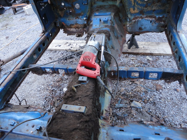

When you're fitting the new floors and frame rails, bolt the transmission cross member and fit the sway bar to make sure you have good alignment on the new metal.
And only cut out and weld one side at a time. :)

Will do, I am using some parts such as transmission cross member from my 72 240z parts car.
Hi Jay:
I think you will find that the 70 and 72 Cross-members are quite different. As I recall the 70 cross-member bolts up into the body - where the 72 has bolts that run parallel to the body - that is the 72 has brackets that stick down from the body and the cross-member slides up into them.
FWIW,
Carl B.
Hi Jay:
In case you haven't seen it - here is a good article about replacing the floorboards.
http://zhome.com/Classic/240ZFloorboards/ChrisFloorboards.htm
You may notice a couple things - first leave the front seat support bracket in place - that will hold the transmission tunnel in place. Second the rear seat supports are connected/reinforced on your 72 - they are not on your 70. So you will want to cut the rear seat supports out of your 70 while still connected to the floorboards - so you can use them as a template for positioning to reinstall.
FWIW,
Carl B.

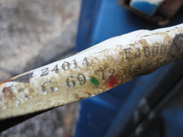

I think my car may have been built in 69, see pic of wire harness,
Hi Jay:
To build a car to completion - the assembly plant has to have all the parts necessary. So with a Date Of Manufacture of 01/70 - you can expect most of the parts to have been produced prior to that.
FWIW,
Carl B.
